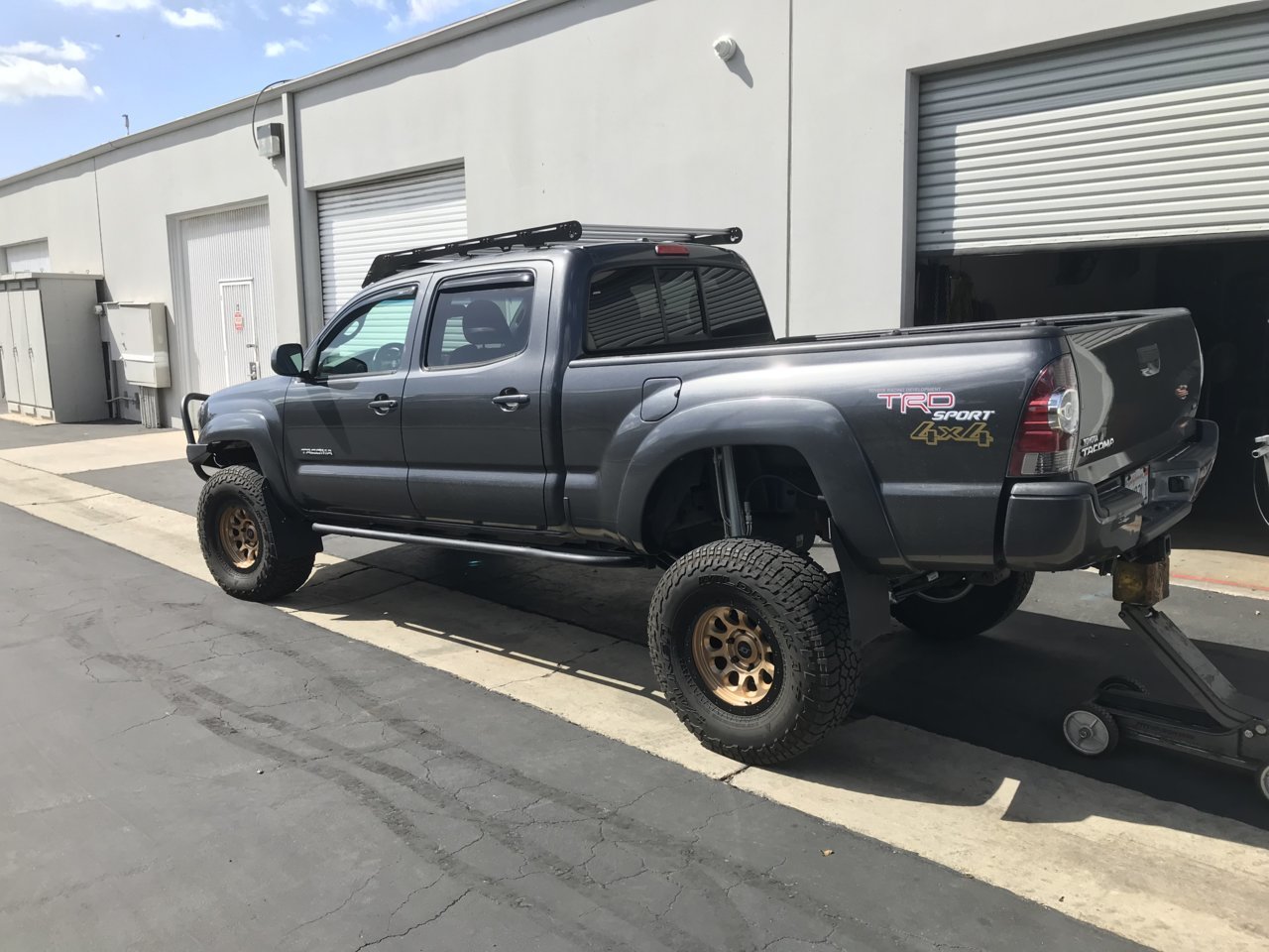

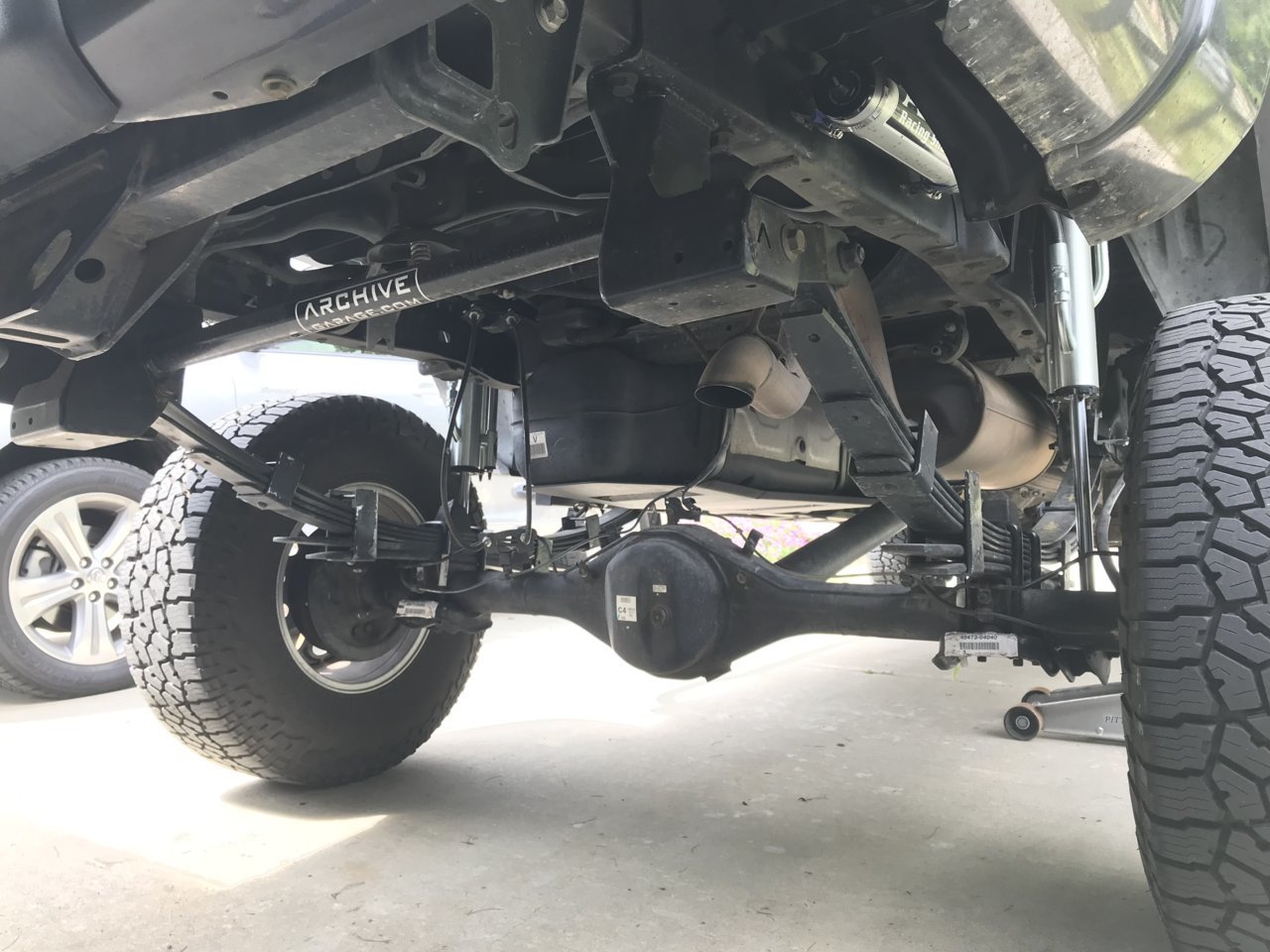

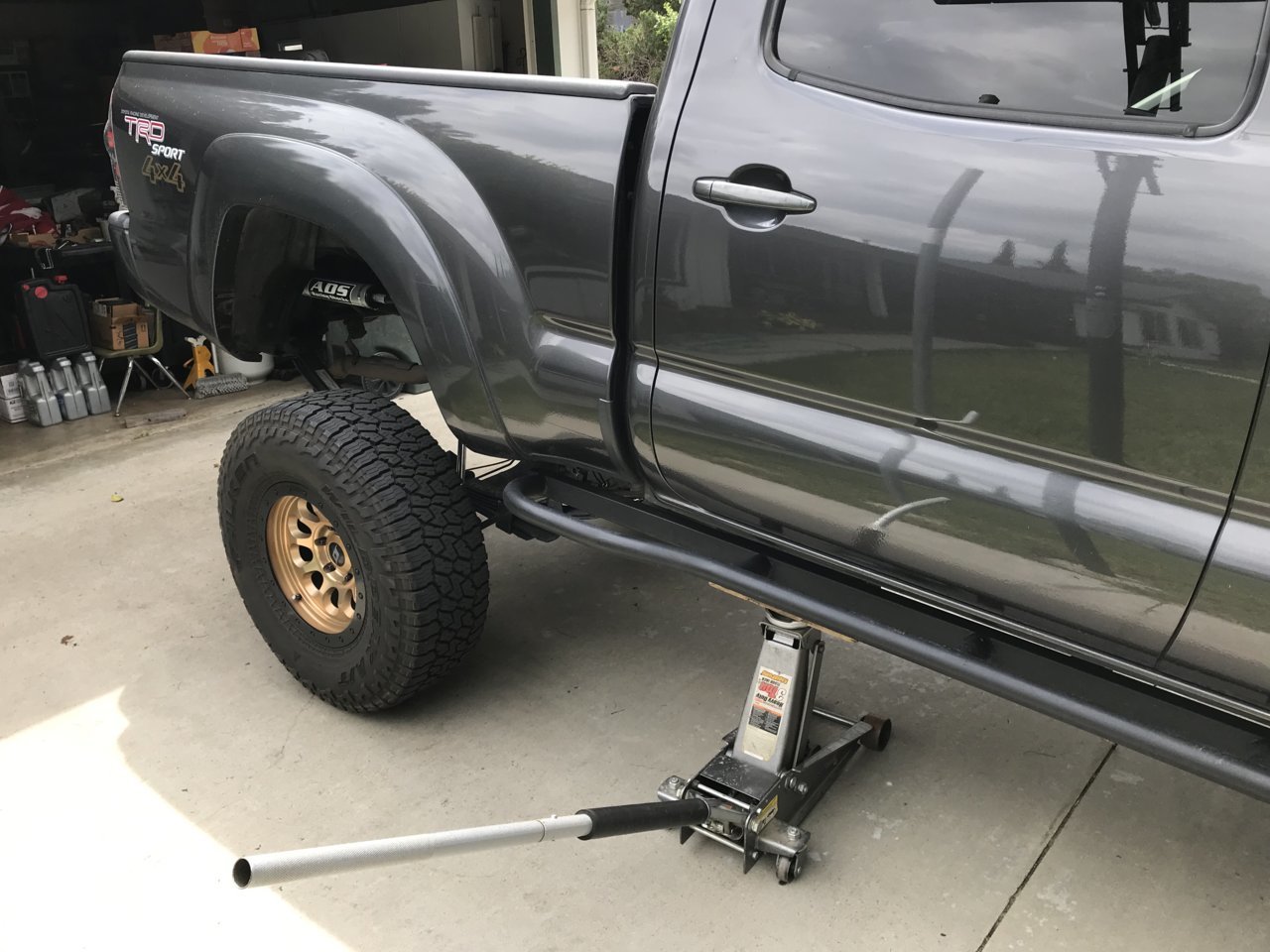

    Thanks for including the pics. Everything looking good, however you can see the Dakar main leaf is separated from the pack. This gives max droop for sure with long shackle option (Dakar or Archive U571 Dual Sport springs only), but that is why I still recommend the shorter shackles with Dakars, because the pack with that separation isn't very functional on the trail with forces the axle is exerting on leaf packs, as main leaf can wrap.
    The only SOA spring that is designed for the longer shackle option is the Archive U571 Dual Sport springs https://archivegarage.com/products/archive-tacoma-spring

    Yeah I can see it now when I look at the picture. Eventually I'll be switching out the dakars for those Deavers, but that's a ways off. Didn't think I'd be putting bypasses back there when I started tearing apart the back and just needed leafs for the lift. But it was a snowball effect and damn, it's nice being able to play with the tube settings. I'm very happy with how the hangers-shackles and relocation perform together. Once I add that spring, whole rear end will be Archive. :thumbsup:
