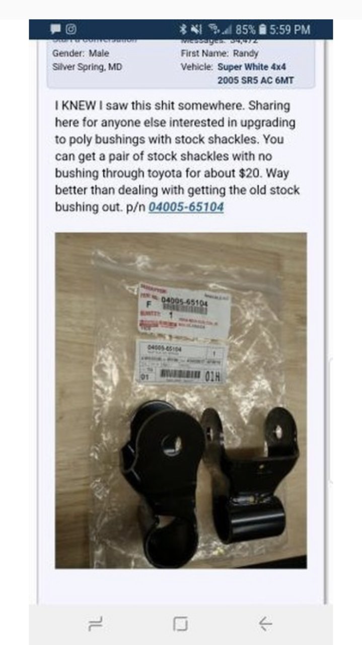

    Hey that’s me!

    I forgot who said that. Someone else sent it to me from Instagram. Maybe @90yota

    Now this is legit - thanks!

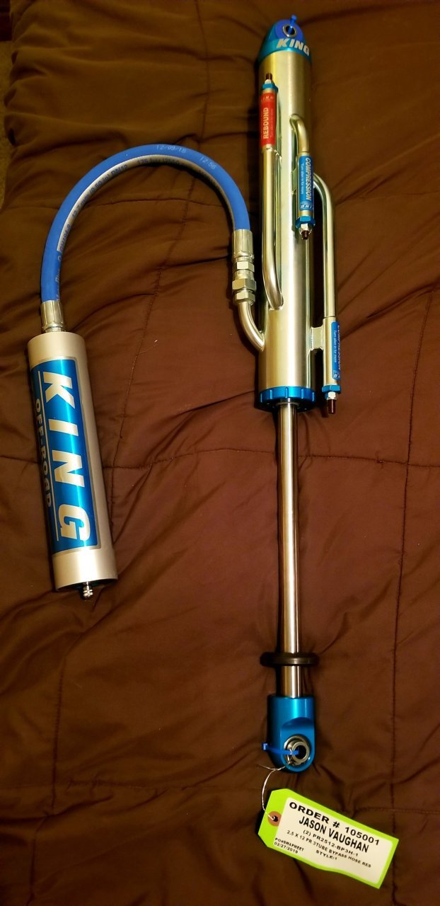

    HH, bushings & shock towers ordered :spending: been waiting since Feb 5th for BAMF but they're too busy with Pelfrey to worry about their own backlog. /Rant
    Will order naked OEM shackles for the install. Already have the Kangs, collecting dust at this point!

    Good call on the archive kit, those shocks don't play nice with the BAMF kit, would have sucked to install and realize you don't have the clearance

    For some reason I though you had to run bypass tubes forward with the archive relocation

    I realized the BAMF towers didn't play nice with 2.5's after I ordered. My only way out at that point was a 20% cancellation fee. I figured I could notch whatever was needed & gusset to make up for it. Well a few months later they missed their ETA so I used it as leverage for a full refund.

    You don't have to but it helps tire clearance

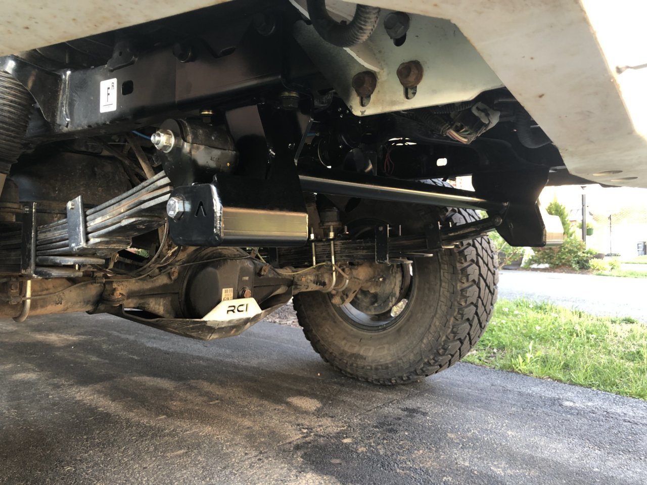

    Here's some more photos of my setup to share.
    14" shock, Archive/Deaver U571, HH with 4.5" shackle

    Is that at full droop? Doesn't look like your shackles are fully rotating.

    Yes and we loosened the bolt at the shackle just to make sure it wasn't binding there but no difference.

    Did you measure exposed shock shaft? Just to make sure you weren’t being robbed of droop anywhere.

    Yes, looked to be 11" on shock shaft and 12" from frame to bump compressed.

    Interesting. @ARCHIVE Eric was talking to me awhile back about trying to shorten the length of the Archive springs because they weren’t fully drooping out with the 4.9”/4.5” shackle.

    I guess it would work best with the 3.6" shackles then
