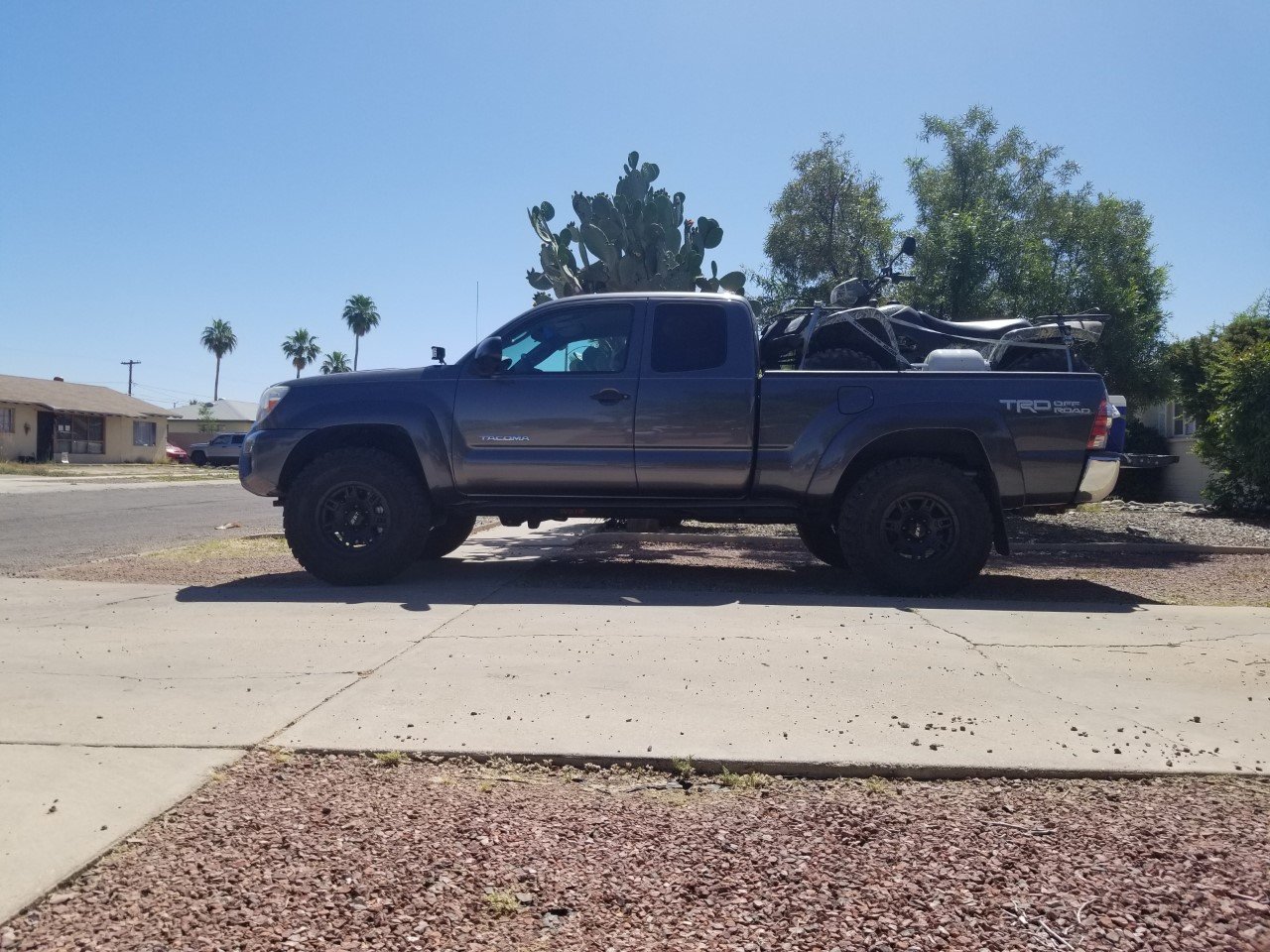

    Hammer Hangers[​IMG] and med Dakars with 700 LBS in back and 500 in cab, Rode like Butter love it! GetAttachmentThumbnail.jpg

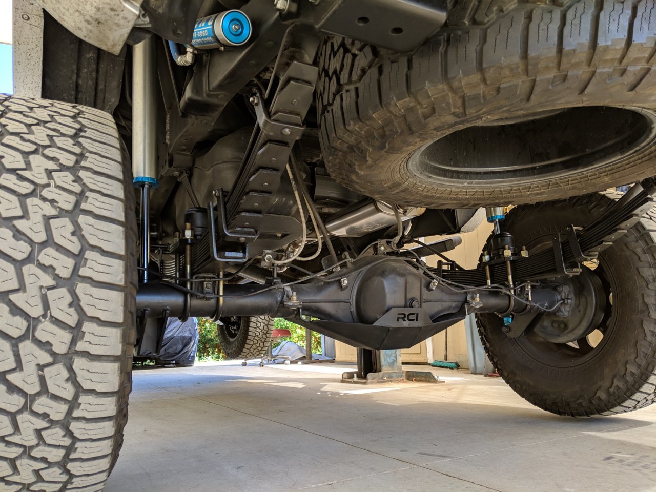

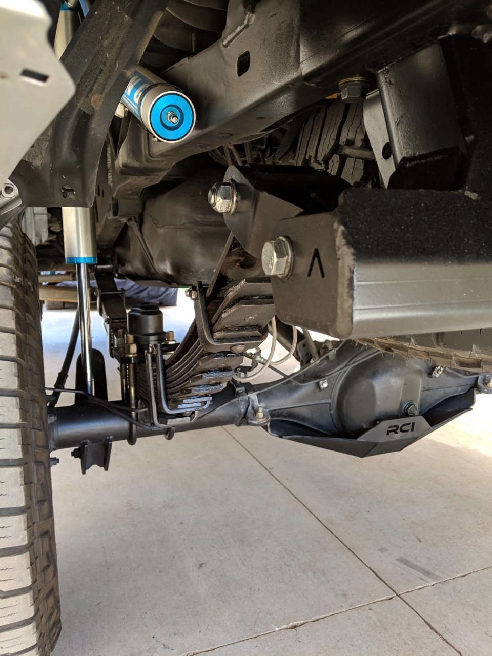

    @mightym How's your truck sit at ride height with that shackle-leaf configuration? Trying to see where it sits in relation to uptravel to the bumps. I've got 6.5" vertical of travel to the bump at ride height right now.
  4. May 9, 2019 at 5:02 PM
    #1064
    mightym
    mightym Well-Known Member
    Oct 17, 2011
    #65334
    138
    SoCal
    2006 Silver Tacoma Long Bed
    If measuring from top of bump to bottom of frame I'm only seeing 3.5". Full compress is close to 6.5". From my new high clearance bumper and all the weight in the bed though I'm at close to 400 lbs all day in the back. Might need Deaver to re-arch them and/or add a leaf. Let me know if you need more info.

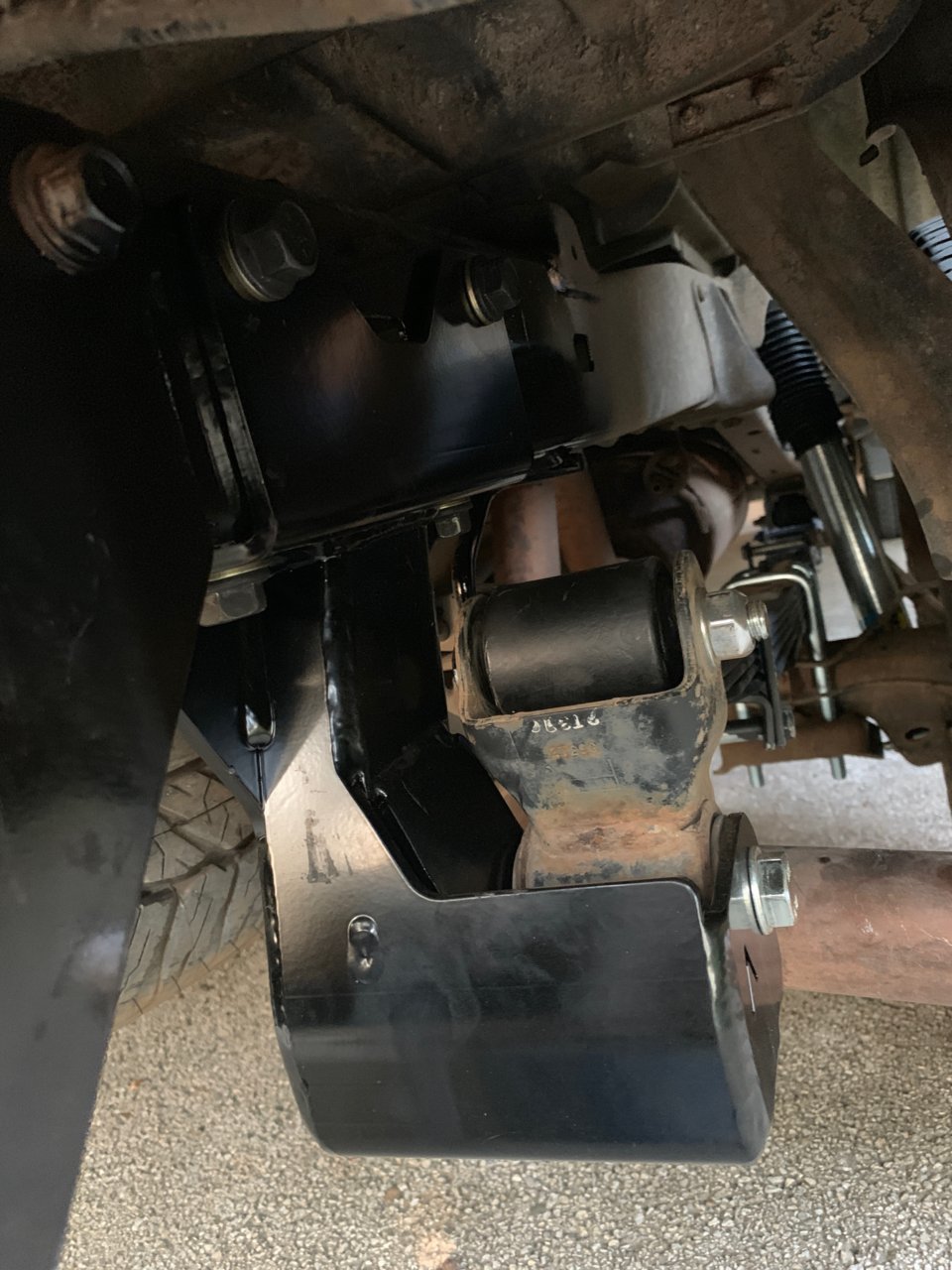

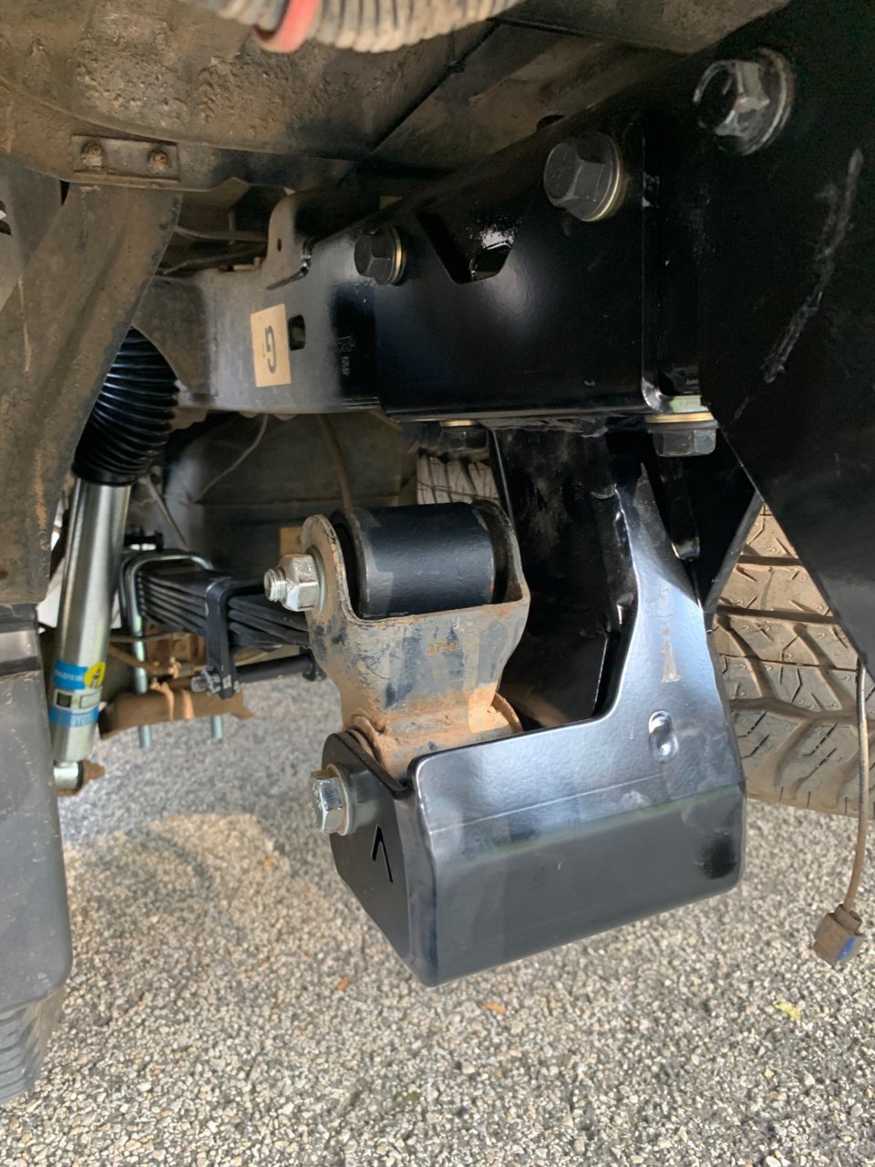

    Got them installed and the truck rides awesome. They were worth the wait! I installed them at the same time as the shocks and springs so I'm not sure how much was the hangers vs the rest. But the outcome was perfect. They're paired with the Icon RXTs and Bilstein shocks. I can't wait to put everything to the test this weekend.
  6. May 14, 2019 at 7:06 PM
    #1066
    ARCHIVE
    ARCHIVE [OP] Well-Known Member Vendor
    Oct 29, 2015
    #168099
    2,253
    Eric
    Orchard Park, NY (Buffalo)
    '05 Taco, '22 Tundra, '91 Cummins
    2.5" Fox relocation * Hammer hanger * Archive MD springs
    Thanks for the feedback, I like that you put the washers on the outside to protect the powder coat on the hangers. That's what I envision as best way
