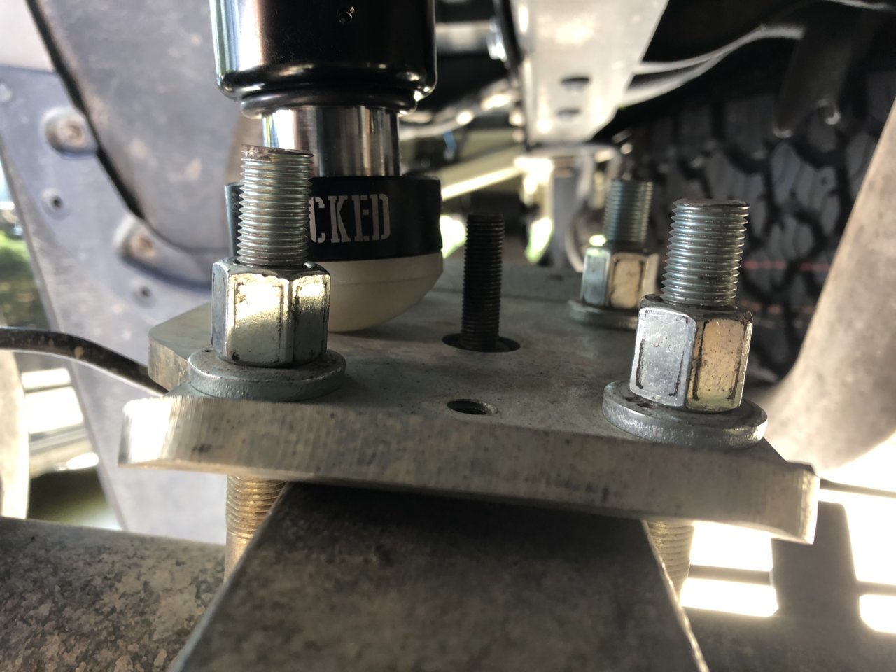

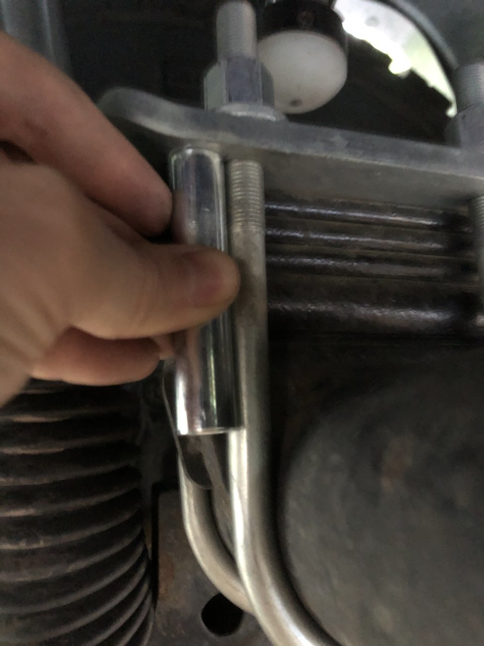

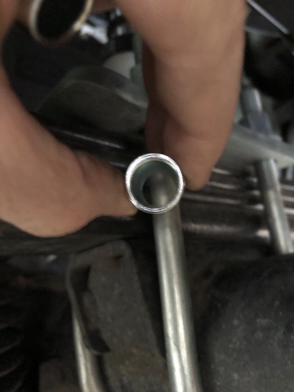

    So I have a random leaf spring question. I have the u bolts torqued down but still get small amounts of rotation of the leaf pack. I thought of adding some kind of shim to the u bolts. This would make the leaf pack tighter in between the u bolts.
    I found some steel 1/16” thick spacers/tube. The ID is 1/2” which fits on u bolts nicely.
    Any reason this is not recommended?

    Ya the leaf rotation is really just the overload on the bottom twisting slightly. I torqued the four u bolts to 80ft lbs. While tightening in a pattern like lug nuts. Basically the leaf pack I have is not held together with the same detailed C shapes the stock leafs use.

    I've had this same idea, and I see no problems, except I recommend using a plastic or Delrin tube from McMaster.com.
    This is also why the Archive Stealth HD U-bolt flip is designed with proper hole spacing to keep the U-bolts tight to 60mm (2.375") leaf packs. You still have to ensure you pinch the ubolts tight to the springs from below the axle before you tigten.

    Instead of the sleeves, have you considered using a larger diameter u-bolt?
    I have upgraded to 5/8" bolts for strength. Not that I have looked for it specifically, but I have never noticed any rotation of my leaf pack.
    EDIT: And, I clamp mine way tighter than 80 ft-lbs.

    I’d be leery about going too tight. Someone else said they over tightened theirs and it crushed the axle tube because all that Force was concentrated on the thin u bolt, as opposed to the large plate to distribute the load. He may have mentioned it wasn’t a tacoma, but same concept applies.

    I have never heard of crushing an axle tube with too tight u-bolts. The u-bolt stretches, and should fail long before the axle tube crushes. And/or, the ears on the plate should bend.
    I run the same setup in my Tacoma that I ran in both of my Rangers (with 8.8 axles).
    I just looked up Toyota's spec. For the factory, non-flipped u-bolts, they specify 37 ft-lbs. :eek:

    Crushing a mini truck axle tube isn't that hard, 80-90 lb-ft is appropriate. 37 is stupid low, and could easily come loose and Im sure contributes to clunking and excessive movement.

    I remember looking at your u bolt flip kit for air bumps and thought there was an extra high pedestal somewhere that was going to eat up bump travel. Looks like this has been fixed:thumbsup:
    Is the plastic recommended to reduce rusting/squeaking? Or is the plastic more slippery than my steel tubing?
    Another interesting idea. This would tighten up both sides.
    When I measured for shock/bump travel the plate thickness was just about perfect.
