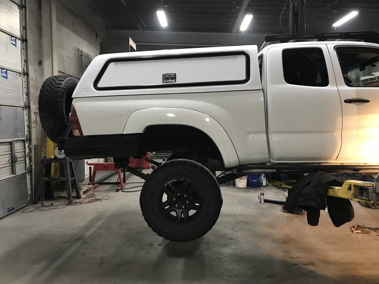

    Forget about advertised lift numbers, and more so the collapsed and extended measurements. Dakars provide enough droop that the shock will be the limiting droop factor no matter what, unless you do a shock relocate and run a 12" or 14" shock, and that's even without the hammer hanger. Here's my dakars, stock everything and a 10" shock which is still the limiting factor by an inch or two.

    Do you run limit straps for that? And just an observation, but does your bed seems to be leaning back, almost like your frame is bending?

    No limit straps. All my stuff is low speed and I've had a rear wheel in the air plenty of times. If I happen to bust a shock, they're cheap at $90 a piece.
    In regards to the bed leaning back, it is a little bit, but it looks a lot worse because of my cap. There's already a gap between my back window and cap because the cap is designed for a regular cab, so it makes it look like the bed is about to slide off my frame. It's flexing back a bit because there's 700+ lbs in my bed, but went right back once on the ground.

    Have you ever checked your frame man? Maybe it's just the picture, but that gap in between your shell and the cab is pretty off, it looks like the bed is either loose or the frame bent pretty bad directly behind the cab which is the most likely point of failure.

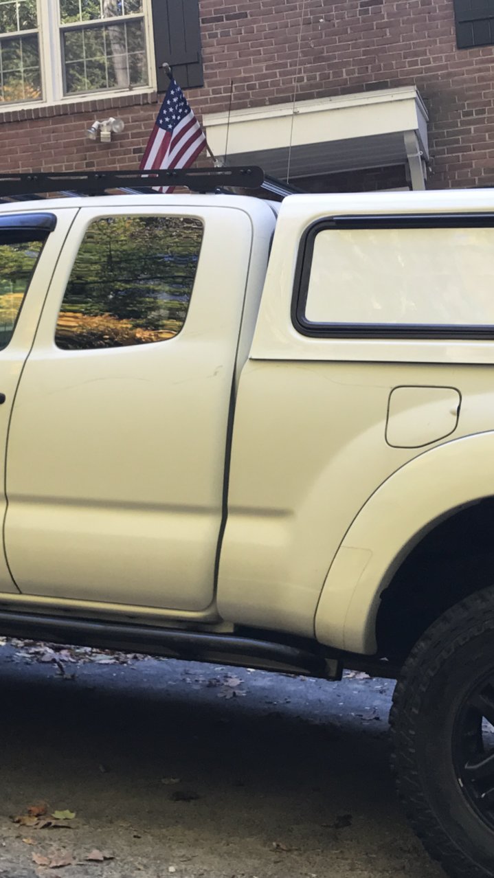

    My cap is for a regular cab, making it look a lot worse than it is. My frame is less than a year old, so it’s not that. Maybe loose bed bolts, but I doubt it. I think it’s just the 700 lbs (with most towards the rear) that’s causing a little flex. Here’s the cap gap on level ground.

    The shell makes it look way worse I'll agree, but the bed-cab gap is equally as concerning. I've got a heavy rear bumper as well but 700 lbs really isn't that much weight man and it's certainly not enough to cause visible changes or flex your frame what appears to be a couple inches while on a 4 post lift. Another example, @jberry813 had Deaver build his rear springs for 1400# over stock, because he carries about 1400#s of shit and his frame isn't tweaking. My bed bolts have a tendency to walk out too, but this big of a difference would be annoyingly loud and is something you would notice.
    You should get that inspected cuz It looks way off man

    I appreciate the concern, but I’m not worried about it. It aligns fine, drives as it should, and everything lines up when booting stuff on. Once we lowered the lift the gap was normal again, so I’m just chalking it up to the weight in the back.
    In regards to Jason’s truck, he’s also got the back part of the frame boxed, adding rigidity iirc
