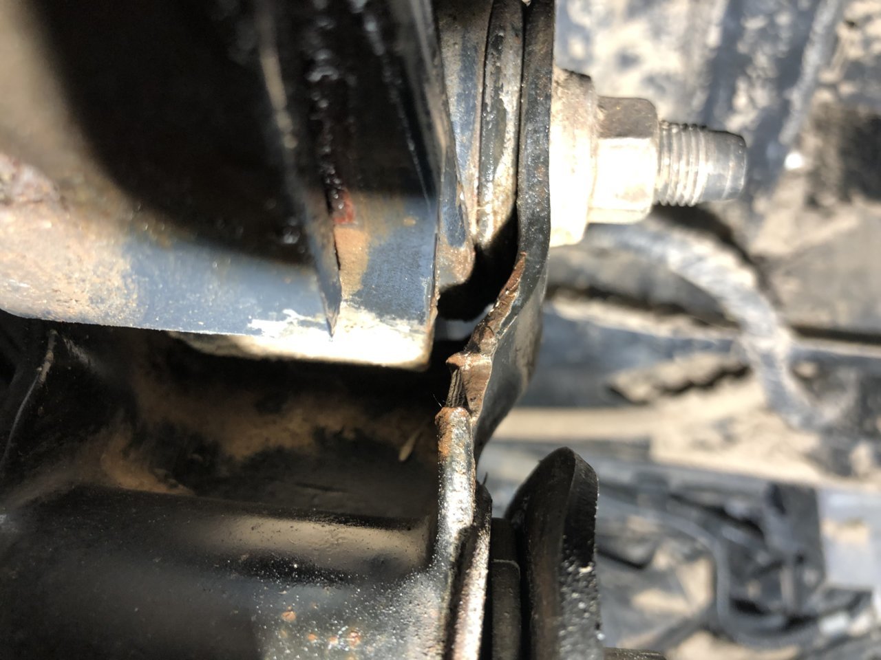

    This explains why I have deep gouges on my shackles. Guess I should trim that second leaf back a hair.

    Yes, I would trim to the edge of the poly pad hole then drill another hole for the pad.
    If you droop it out on jackstands you could pry 2nd leaf down and take care of it without any disassembly

    Archive Thank you!!! I have been in contact with ARB. They want me to remove my leaf pack and measure it to see how worn out it is. They seem to think that is the issue of why my shackle hangers look like the one pictured above. I am very curious as to what their reply will be. I can second or third or fourth the loud pop sound after having some flex going on. It’s happened to me a handful of times. I’m going to have to throw in a hacksaw next time I go out so I don’t end up in a pickle like Alex_Busta. Glad I know what the pop is because the first time it happened I was certain I broke something.

    Thank you for posting pics, and contacting ARB.

    Here in the next couple weeks I will finally get around to installing my hangers and shackles. At that time I will measure the camber of the leafs. I am hoping that they measure within limits because that’ll tell them that it’s the design and not worn leafs. I’m doubtful it’s worn leafs. They only have maybe 15k miles on them(2yrs old). The progression that they took with me was that the leafs must be worn. I sent numerous pictures of the leafs and the arch. My leafs have some negative arch to them. I was later told this is normal and that’s when my case went cold without me removing the leafs. Here is a few cleaner pics of damage.

    It is annoying they are denying that, because the shackle damage is clearly due to spring design. Negative arch can be normal depending upon actual load weight
