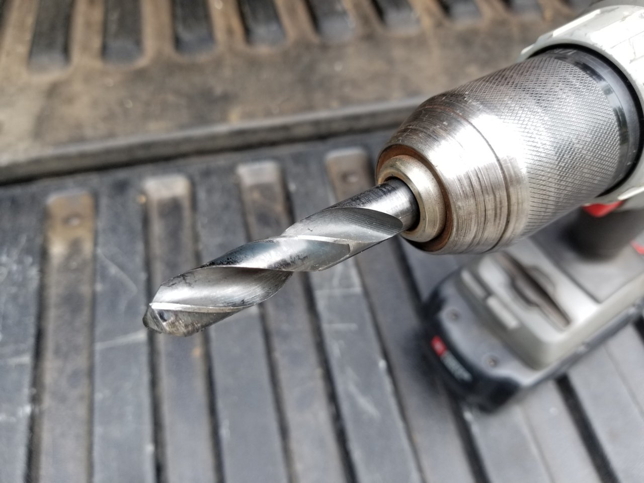

    Meet Ernesto the drill bit. Ernesto helped me install hangers on my Tacoma over 2 years ago, and has been used nearly every week in the shop since, yes 2 hole (punny) years.
    For $12, less than a Dewalt throw away bit, you get a 1/4" and 1/2" bit added to your kit. I offer these to save you aggravation, time, a trip to store and money.
    I recently drilled holes out in a stainless header flange for a friend and 4 new holes in my Tundra frame, and Ernesto is finally tired.
    I saw another thread where people were making outrageous claims about needing many drill bits for installing hangers

    mx bits for hangers? my money is on too many ripums! slow down and use some tap magic.

    Ever get it sharpened? Fastenal will sharpen bits for cheap, and holy fuck, does a sharp bit make a difference.

    if it's used, they lose their temper and won't hold an edge and you'll be sharpening often. I've spent way too much time sharpening shot bits when a new one is cheaper.

    ¯\_(ツ)_/¯ All I know is at the shop, fastenal sharpens the bits every so often and they work amazing.

    Never sharpened it, and didn't use oil for drilling

    That is impressive. Any particular reason why you didn't use oil? Regardless of the bit I've used, oil made a significant difference.

    I guess because it just didn't need it, I'm shocked by the durabilit. I know not to get them too hot

    What weight oil? Synthetic or Dino? Did you flush the oil and replace it after a BIT of break-in period?
