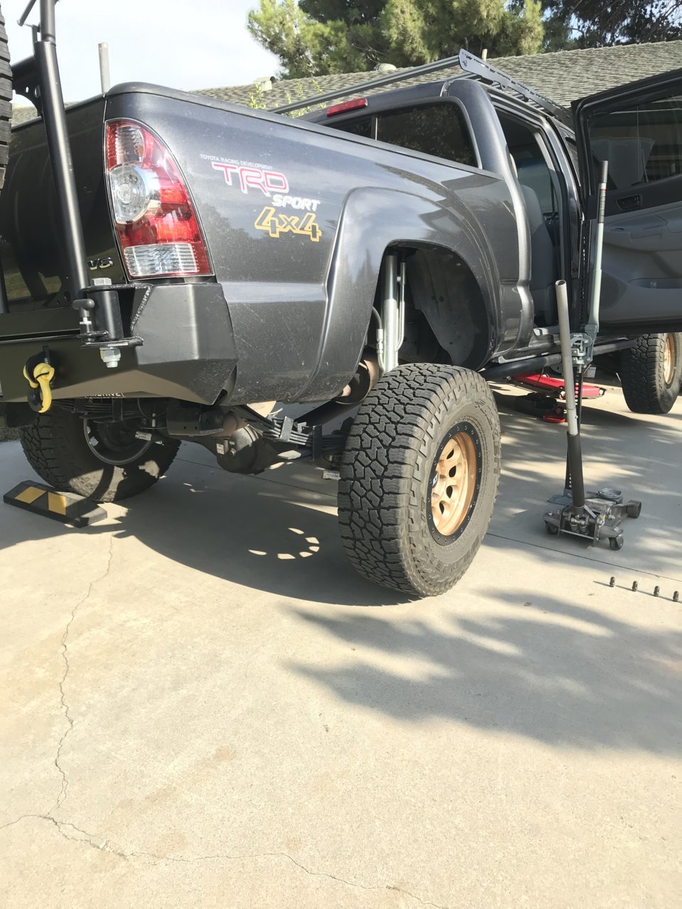

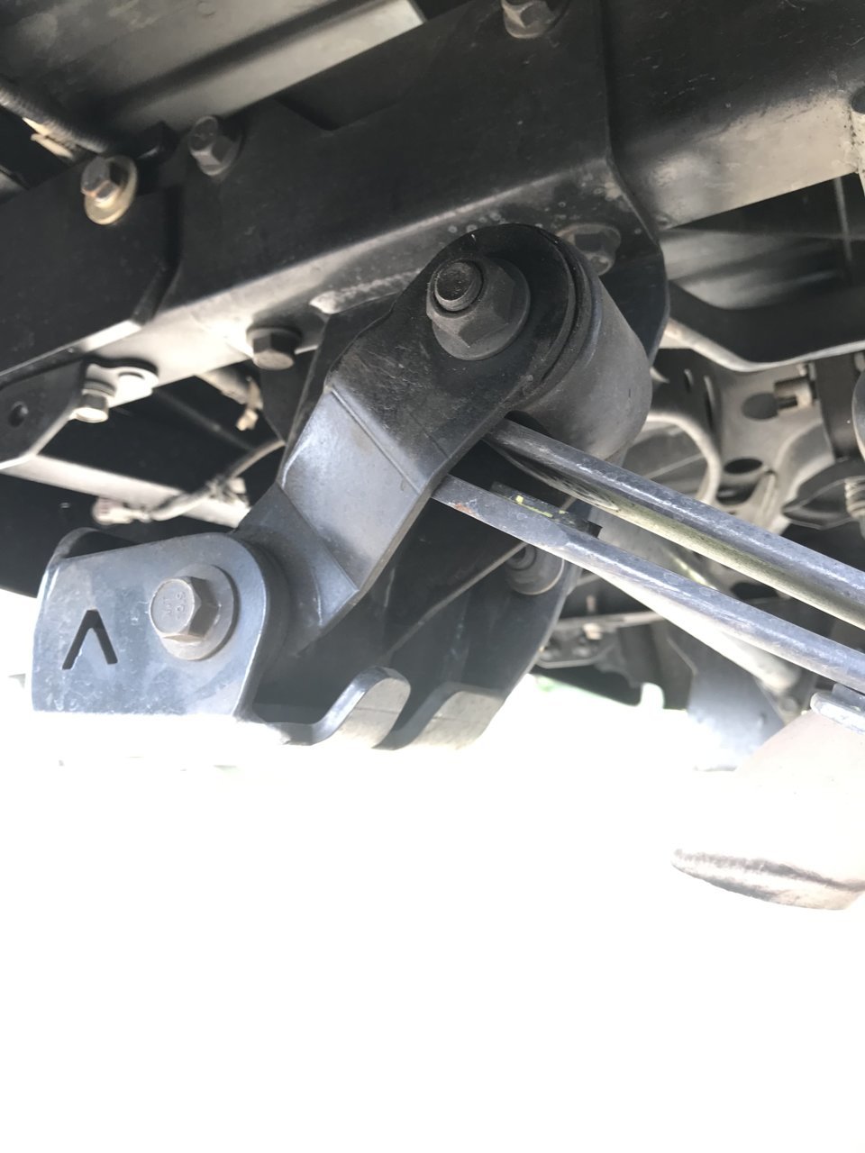

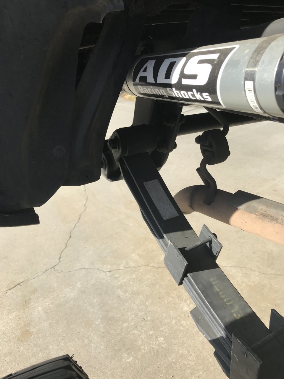

    @ARCHIVE Well add me to the list with the dakars. Jacked the truck up for a tire rotation and once the rear wheel was off the ground I noticed this. The second leaf seems to binding on the shackle both sides preventing further articulation. I have the 4.9” shackle in use with the dakars and as you can see, the shackle hasn’t even fully rotated over, which it can under vertical droop. It seems vertical travel is unaffected unless you take into about the massive amount of leaf separation. I understand that the OME springs are cheap and you get what you pay for when it comes to leafs, but I think we all know ARB could do better in designing the EL095(6)R as an affordable alternative to other brands. No fault to the hangers or shackles themselves, I love the design. I plan on eventually switching to a different pack/shackle/lower mount configuration to optimize bump travel for spring over. Work in progress. :thumbsup:

    You rotate your tire with a hi-lift when you have a floor jack? Dat's sketchy

    This is right before I threw it on jack stands. Which I realized I hadn’t done when after taking off the rear lugs :facepalm: (I blame 103 degrees it was that day). Floor jack doesn’t get the rear tire off the ground without stacking 5+ 2x4s, which makes both methods sketchy. :burp:

    If you have jack stands why don’t you lift from the rear diff?

    I also wanted to check clearance between the tire and bypass tub on the other side under articulation. Which is when I noticed the contact between the spring and shackle.

    That Dakar shackle end is impossible to design around, thanks for showing the contact.

    So if I’m installing HH’s, I should expect this contact since I’m running Dakars right now? Any fix prior to install? Is trimming the leaf feasible? Since it’s the very end of it, it shouldn’t affect performance should it?

    The fix is trimming the 2nd/3rd leaf down, trimming a minimal amount shouldn't stress the main, it makes it similar to other leaf packs. Happens with stock shackles and hangers to
