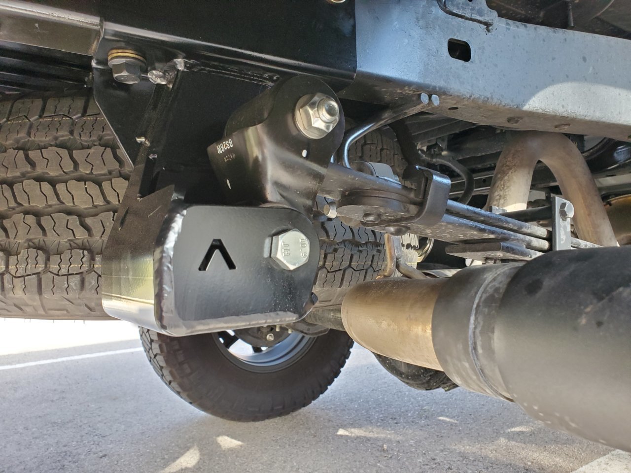

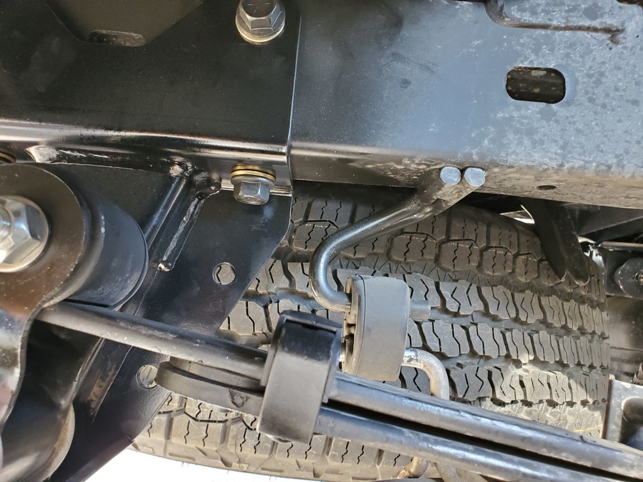

    Awesome! Could you possibly post a photo of the exhaust side, just so I can get an idea of how much clearance you have between the hanger, leaf and exhaust? Thanks.

    Hope this helps!
  3. Aug 28, 2019 at 5:47 PM
    #1263
    El Taco Blanco
    El Taco Blanco Well-Known Member
    Jan 6, 2017
    #206765
    590
    2017 White Tacoma SR5 4x4 DCLB
    Stock (for now)
    Perfect. Thank you!

    There's actually more clearance to the Hammer hangers, it's the leaf springs when the shackle gets near horizontal

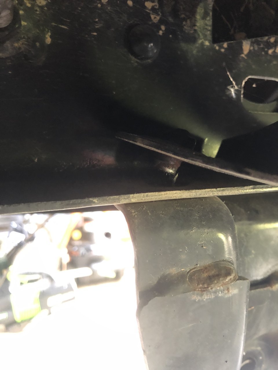

    Uhhh. Guys. So I’ve been working all day on getting these installed. I was using a u joint press on the bottom rivets driver side then this happened.
    Am I fucked ? How can I fixed this? Lol. Seems that the cross frame washer buckled upward instead of the rivet popping out. See picture
    Update:
    Managed to use use some wood clamps to hold it down while I drilled through. I think it’ll work
    whatstcp likes this.

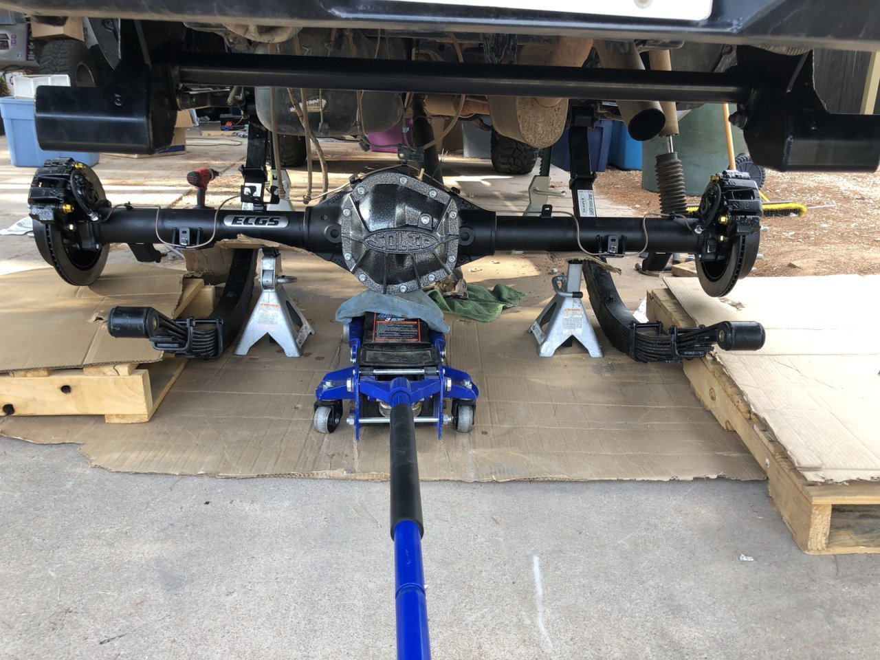

  15. Sep 2, 2019 at 3:47 PM
    #1275
    jewboi
    jewboi Well-Known Member
    Feb 21, 2017
    #211213
    280
    So, if anyone wants a lesson on how not to install hammer hangers hit me up i got you.
    I finally got one side bolted up but realized that I should've replace the stock bushing with the new poly bushing first because now I can't access the inboard side to replace it without unbolting the hanger. Oh well.
    So I got the truck put together with 1 side done and I'm noticing the truck now has a lean to it. The side with the hammer hanger installed is sitting noticably lower than the stock side. Is this normal?
    Alesimo likes this.
  16. Sep 2, 2019 at 5:35 PM
    #1276
    ARCHIVE
    ARCHIVE [OP] Well-Known Member Vendor
    Oct 29, 2015
    #168099
    2,253
    Eric
    Orchard Park, NY (Buffalo)
    '05 Taco, '22 Tundra, '91 Cummins
    2.5" Fox relocation * Hammer hanger * Archive MD springs
    Being the side with Hh is lower, it probably is just from jacking up the vehicle and hasn't gone back to static height, usually there is a bit of lift from Hh.
    I recommend putting both on, and save assessments for later
