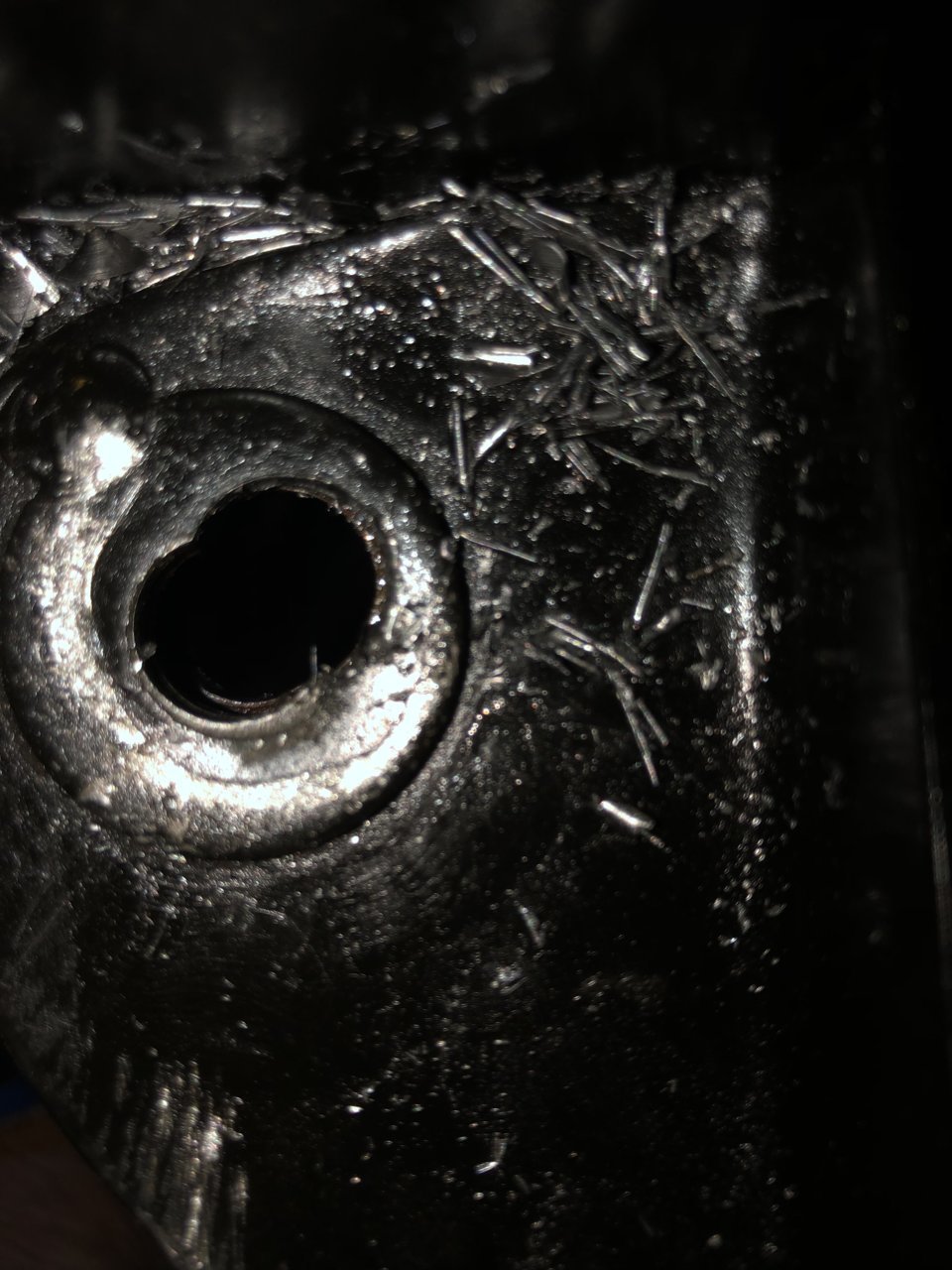

    So what’s standard procedure for drilling through the bottom rivet on the passenger side that the stock exhaust is blocking? Drill bit doesn’t stand off enough to have access to drill through at all

    I Bungeed the exhaust outta the way, drill it as best you can and step bit the rest. Pu push it real good

    So I managed to drill the rivet below the exhaust out but was kinda off center since I was holding the exhaust out of the way with my knees lol. Does anyone think this will be an issue ? Attached a pic

    If all 4 bolt holes line up, you’re good. If not, then you’re not good. Then just do what’s necessary make it line up. Is that drilled out to 1/2”?
