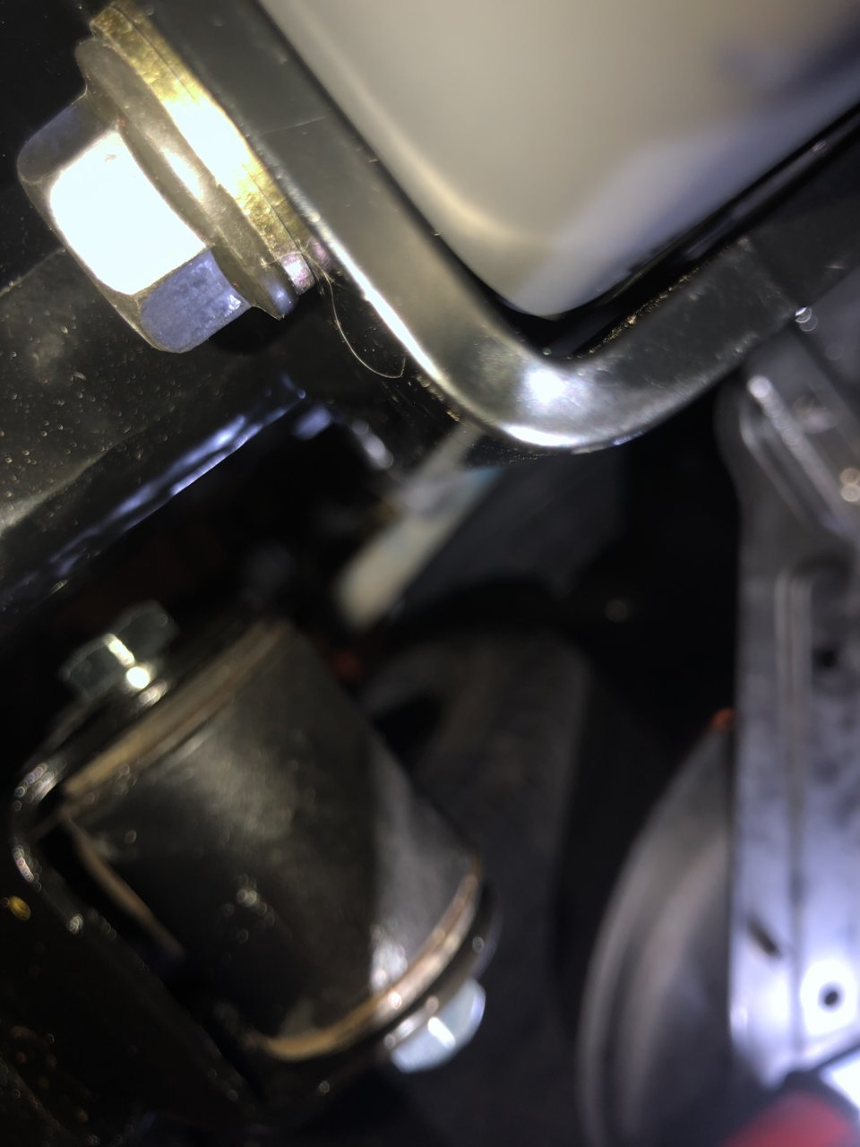

    Guys one last question. Almost all the way there. Just got the last hanger bolted up and notice that the side does not sit flush with the frame.
    I think maybe one of my holes being off center is causing this ?
    Is it OK? If not, any suggestions for a fix?
    Edit: pic is kinda tilted to get a good angle down it but you can see the hanger sitting off some distance

    It’s fine. As long as you can get all 4 bolts in and everything tightened to spec, I wouldn’t stress about it.

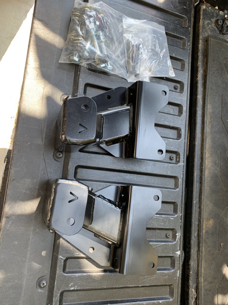

    Bought mine in October 2018, decided to not put them on. Looking for $330 shipped. Comes with the bolts and two sets of drill bits as shown in the picture. PayPal only.

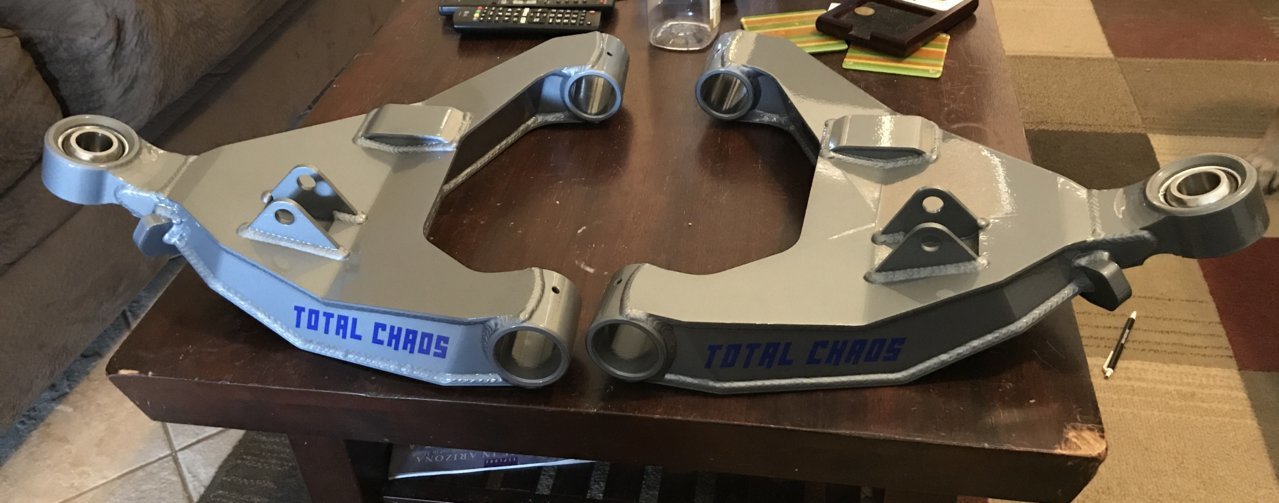

    For you guys with the Archive greasible shackles - are you just using the super lube or whatever its called for polyurethane bushings like on Total Chaos products or are you using something else?

    I’m going to give the super lube a try since whether it’s a poly bushing in an UCA or in a leaf shackle the concept should be the same and I already have it on hand.

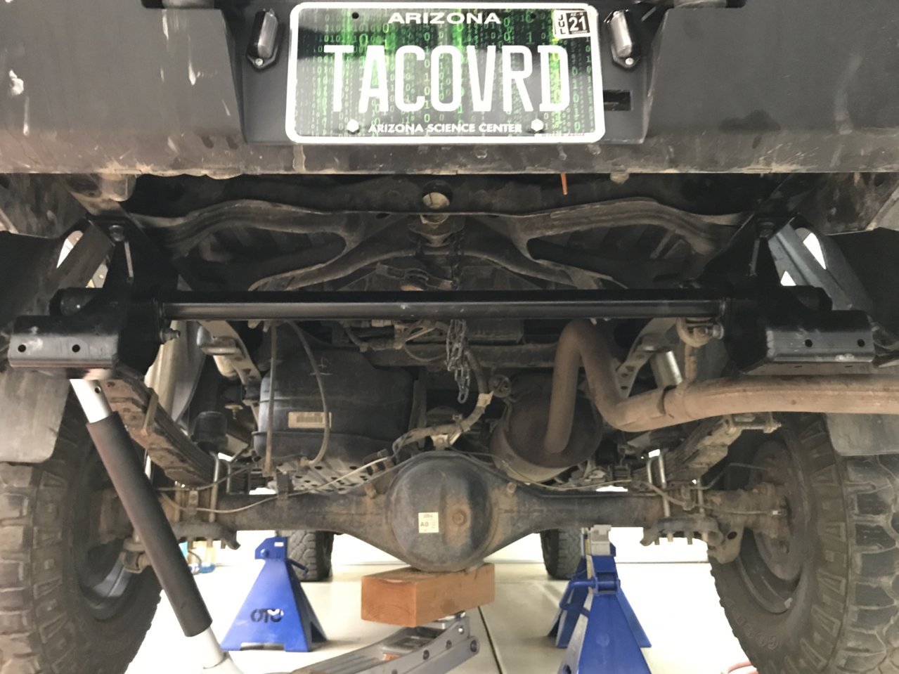

    Well, drove the truck for the first time since the hammer hanger install and on the quarter mile of washboard and rutted gravel road to get from my house to the main paved road, it’s night and day how solid and planted the rear end feels now. I can’t wait to actually get it out on some trails - maybe tomorrow...
    I’m quite impressed. I’ll be honest, I was just expecting beefier shackles but the increased stiffness is shocking.
