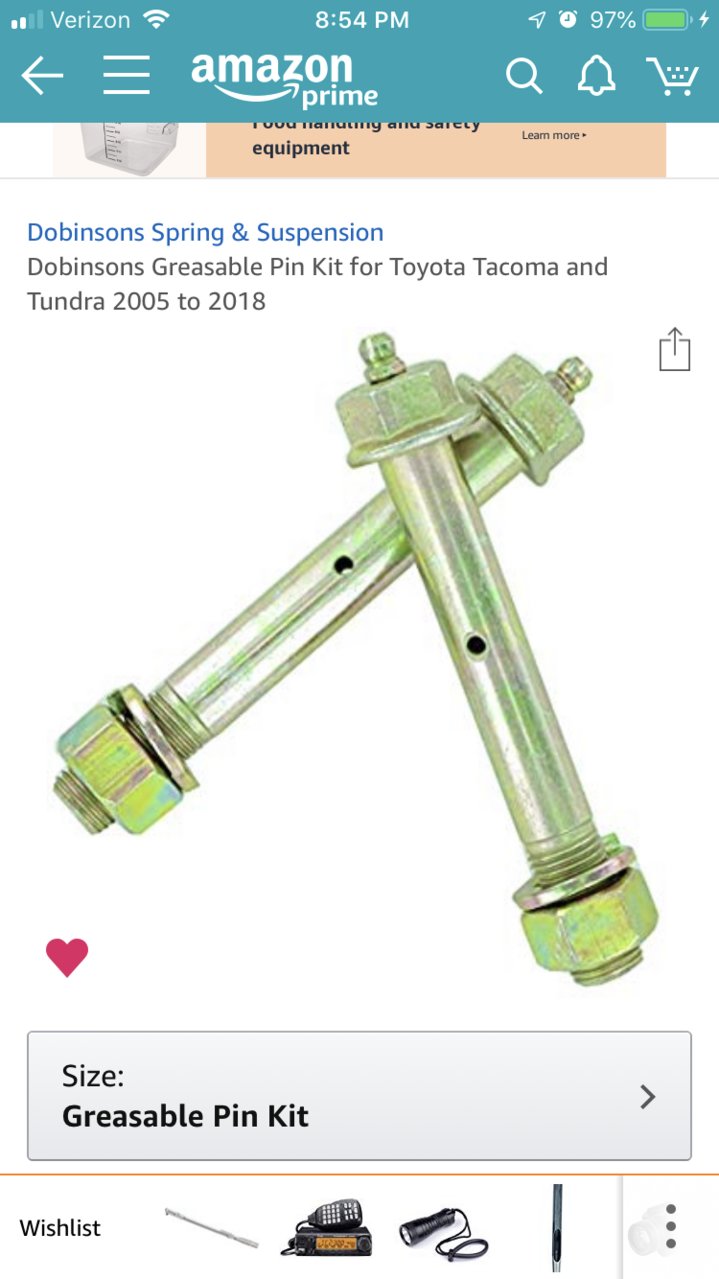

    Could consider something like this:

    15' MGM Trd Off-Road
    Pretty sweet, perfect option for the route I'm going I will add it to the list thanks

    You have to be careful using these or other bolts than what I provide, especially in the hanger/bottom of shackle location. If someone causes damage to their hangers by using a bolt that is longer (or incorrect) than what I provide, it's the customer's responsibility.
