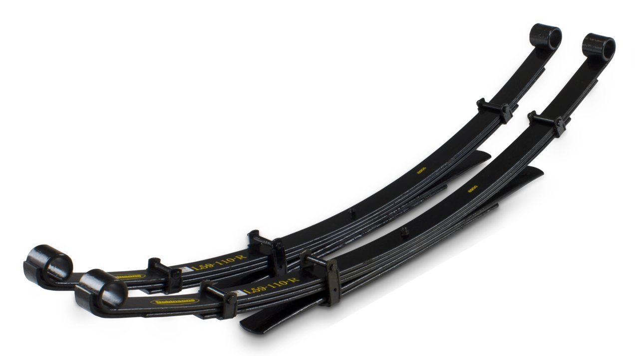

    Minor report on the ARB/OME Dakar emails, I sent an email asking for an update on any progress a couple weeks ago and have not received any response. They could be ignoring me or they may not want to admit they need to revise the springs to avoid customers pushing for warranty claims.
    Also, I think Dobinsons springs (see pics) are possibly the best springs available at a lower price point, see pic. I'd definitely look at Dobinsons if you are thinking of Dakars with their issues.
    Deaver U402 expo series are good. Icon RXT are prone to axle wrap due to large stepping of leaves. Alcans are too long for stock hangers, good for Hh. All Pro are poor quality and too long for stock hangers, and I'd steer clear unless you already have them. I'm just saying this to put info out to help people spend money wisely.

    What about the dobinsons makes you say they’re better? Just the shorter second leaf?

    Disclaimer: My opinion is based on pictures and my customer beating on them and using them with Archive shock relocation and Hammer hangers. There is not alot of data on them that I've seen.
    The entire design looks better, Dakars double overload doesn't make sense. Notice the tight spring clips on Dobinsons, the Dakars have ridiculous clip gap that lets the leaves get separated.
