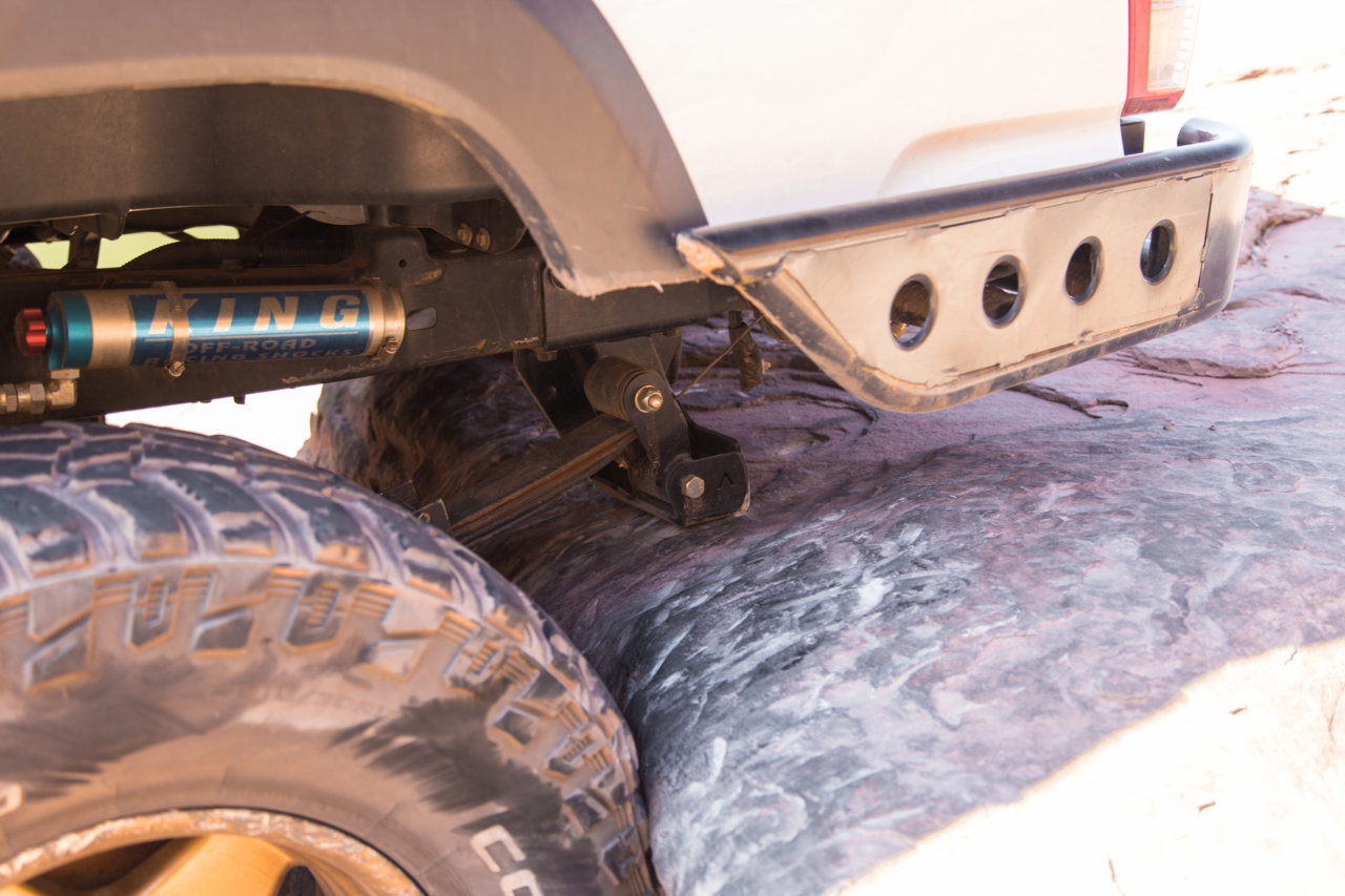

    Here is a picture of why every Tacoma that wheels in Moab needs Hammer Hangers9EA12C46-4003-4CDE-B660-5A4B711FD6E8.jpg

    What trail is that?

    Either Moab rim or metal masher. Can’t remember which one the photo was taken on

    Thanks for posting Noah. I heard Archive and Hammer hangers were out in force there, that true?

    Yes! I saw at least one other truck with your shock relocation and at least 2 or 3 others with hammer hangers!
