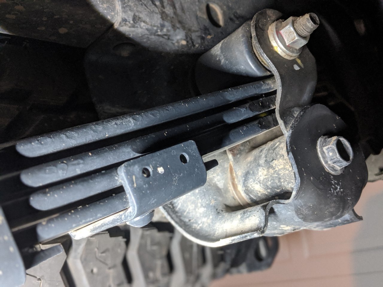

    Overkill. I'll have a heavy camper, rear bumper, gas cans, drawers and camping weight and didn't want sag or issues. Plus super cheap compared to waiting and getting deavers.

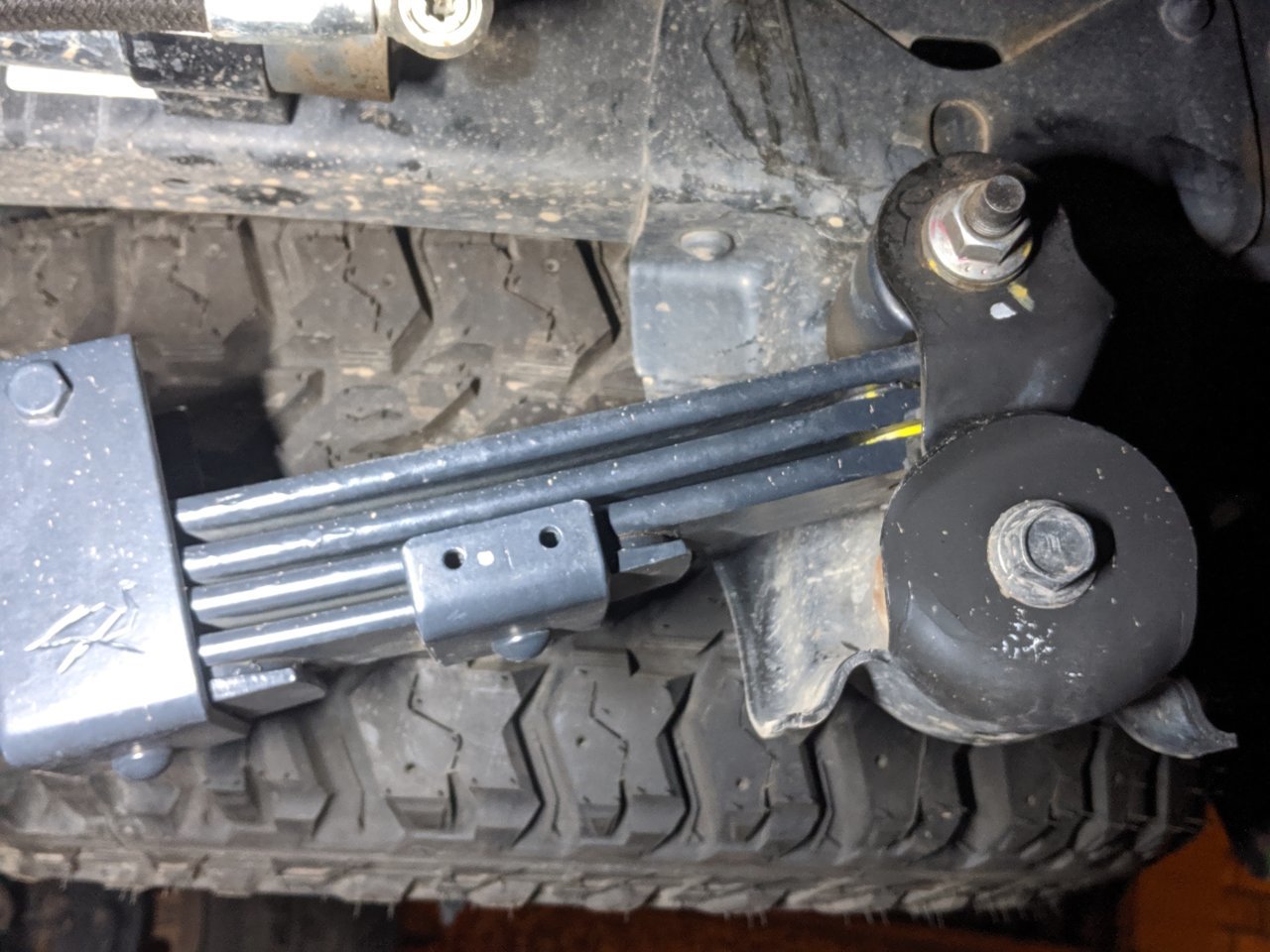

    Well that confirms my accusation that OME basically took their Hilux spring design and used it for the Tacoma despite being a different shackle arrangement. The 2nd/3rd leaves extend inside the shackle, causing a situation during articulating where they slide sideways, then jam into the shackle side edge as axle goes back to level, causing dangerous binding, horrible noises and shackle damage.
    I recommend reusing stock shackles with the Hammer hangers and trimming about 1" off the 2nd/3rd leaves so they never touch the shackle.
    You can see the leaves and shackles are worn where they rub each other in just normal driving. Thank you for pics Art
