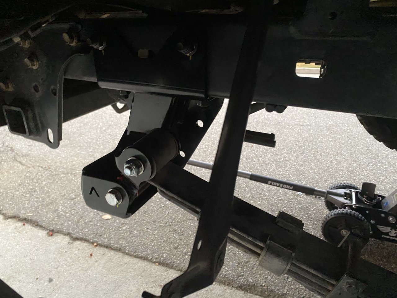

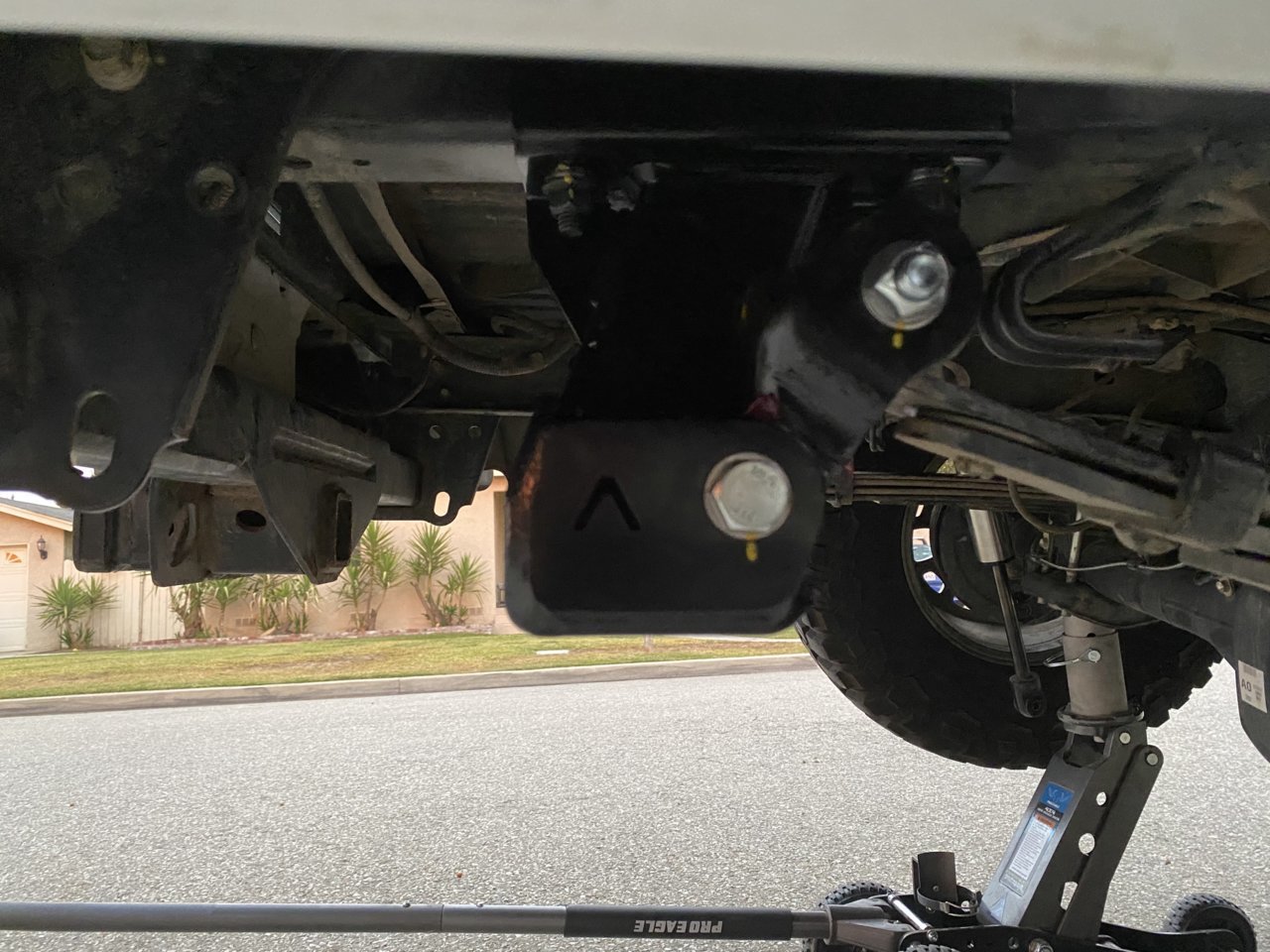

    Does this look about right for max droop with: stock leafs, progress aal, shackle with poly bushing. The shocks were disconnected on both sides. I was thinking the shackle would be a little flatter? I measured about 25” extended, 16.5” collapsed.
