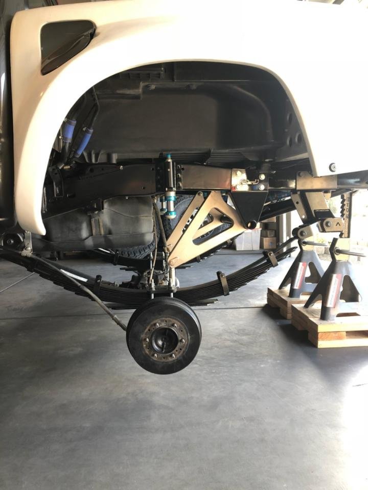

    I don’t think that’s right but I’ve never really paid attention to how much droop a stock pack has with poly bushing shackles.
    Eric will likely know better.

    AFE stage II intake, APR X1, URD 70mm Throttle Valve (ported and knife edged), NST intake manifold spacer, URD spec U headers, Denso IKH20, URD fuel pump, APR fuel rail, URD Y pipe, URD spec u catback, lightweight water pump pulley, Greddy sandwich cooler plate, Earls oil cooler, IPT valve body, FJ TRD shocks, Cusco front and rear sway bars, Energy Suspension rear track rod bushings and rear link bushings, Carbotech pads, Stoptech ss brake lines, Stoptech slotted rotors, Motul 600 rbf, Limited Grill, Painted hatch cover by me, Painted valve covers by me, Cobra CB, TRD rad and oil cap, Escort 8500, Autometer oil psi and temp gauges, AEM wideband afr gauge, Flexpod, Pioneer 400w speakers.
    1812.jpg this was another members truck in this thread. Note the no shocks
  3. Nov 19, 2019 at 6:09 PM
    #1423
    greenEFSI
    greenEFSI TacoSupreme____
    Jun 29, 2016
    #190830
    1,573
    Gio
    West Covina, SoCal
    '15 TRD Pro Super White
    That’s got aftermarket leaf packs

    I think you're jacking it up wrong to test full droop. I like to let the axle hang straight down.
    However, I have been putting this out there a long time, the stock leaf packs are flatties, no arch, which is the drawback to keeping them. They're stuck around 10" travel.
    Here's a measurement I got on my truck with fully stock leaves and Hammer hangers at full droop: ~15.5" from top of axle tube to bottom of frame rails (leaf limited).

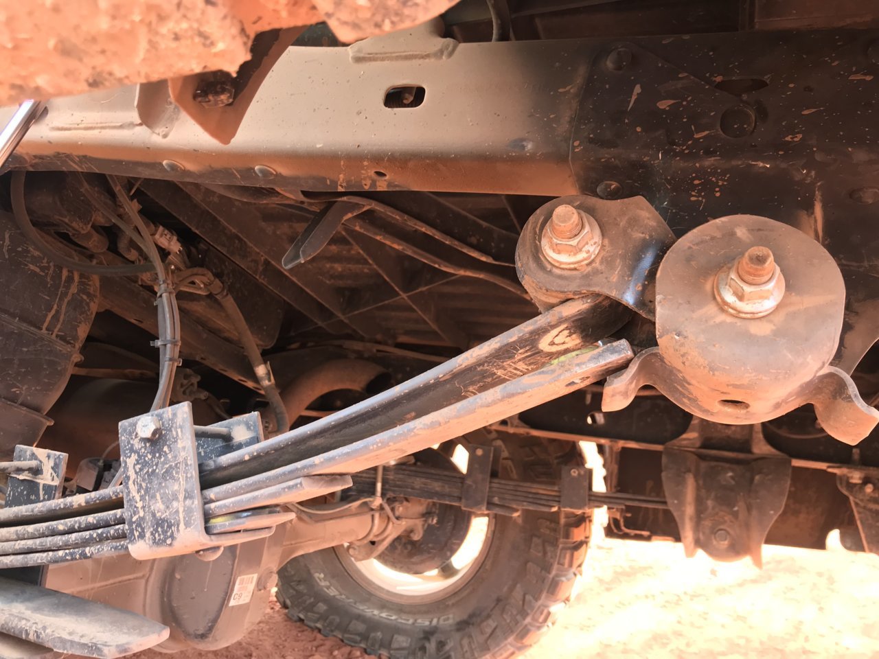

    So just so that I understand correctly....in addition to cutting part of the offending leaf, the HH needs to be installed to correct the issue with leaf wedging into the shackles?
    what happens if just the leaf is cut and not install the HH?

    Incorrect, just correct the problem with Dakars, the design. Hh go in factory rivet holes.
    If you don't install Hh, you don't get the benefit in ride and durability

    In case anyone hasn’t been able to hear a video where you can hear the leaf becoming hung up on the hanger and then FLUNK-THOINK’ing free. I uploaded a video where my truck does it in 2 separate cases. Maybe this helps. Just wanted to share. Either way, just installing Archives poly bushings has helped flex a lot with stock shackles and hangers but my hammer hangers will make a much bigger difference. Thanks again for the great products and service, Eric.
    Short video where you can hear the leaf doing this.
    https://youtu.be/8wtwdxFlzu4

    I could be wrong but I would like to guess that your bp51 shocks are so short, they will limit your travel long before your springs get so droop-extended to actually catch on the oem hanger. The bp51’s are some of the shortest fancy rear shocks on the market. I have read that OME designed many of their basic and even nicer components to not allow enough travel that would warrant other supporting other modifications like extended brake lines specifically.

    Your shackle should be darn near horizontal, to tell if it’s fully drooped out I believe.
