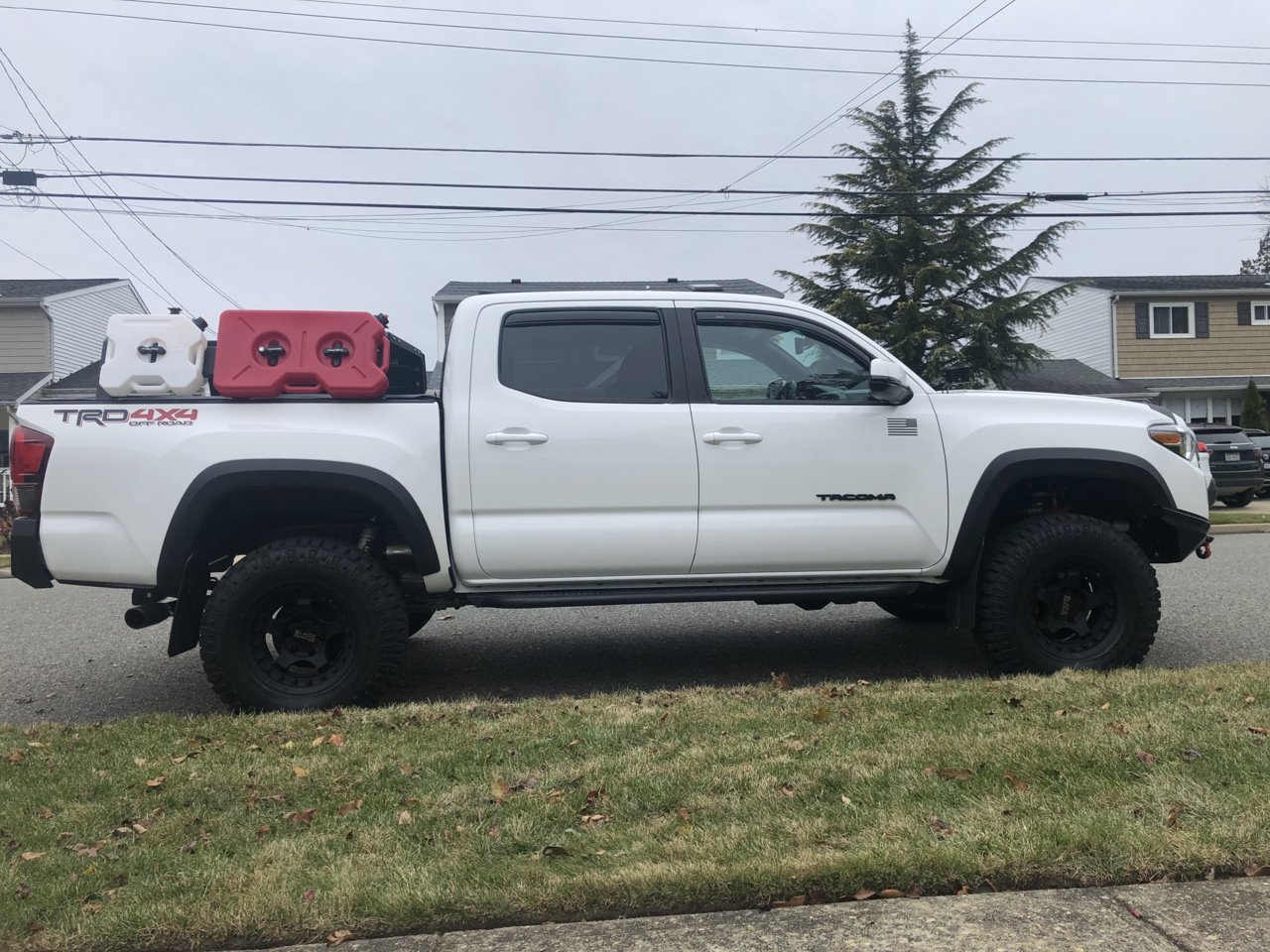

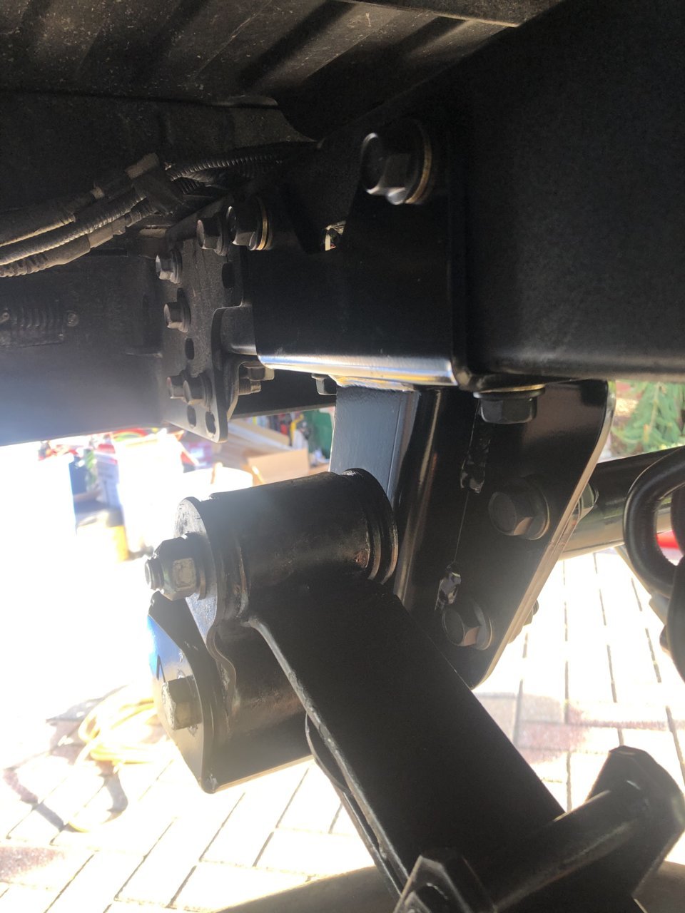

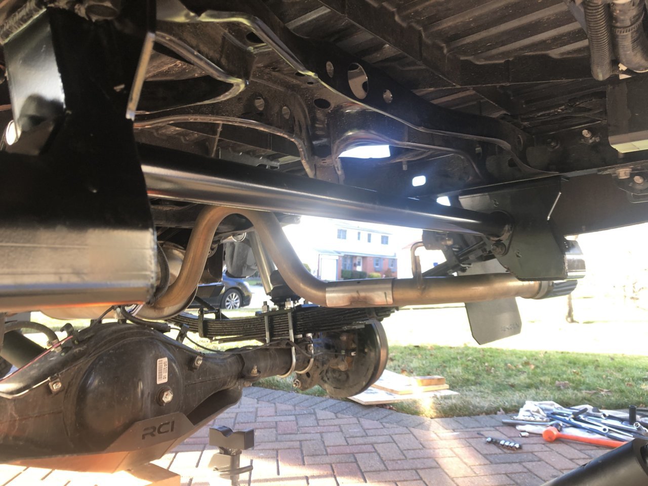

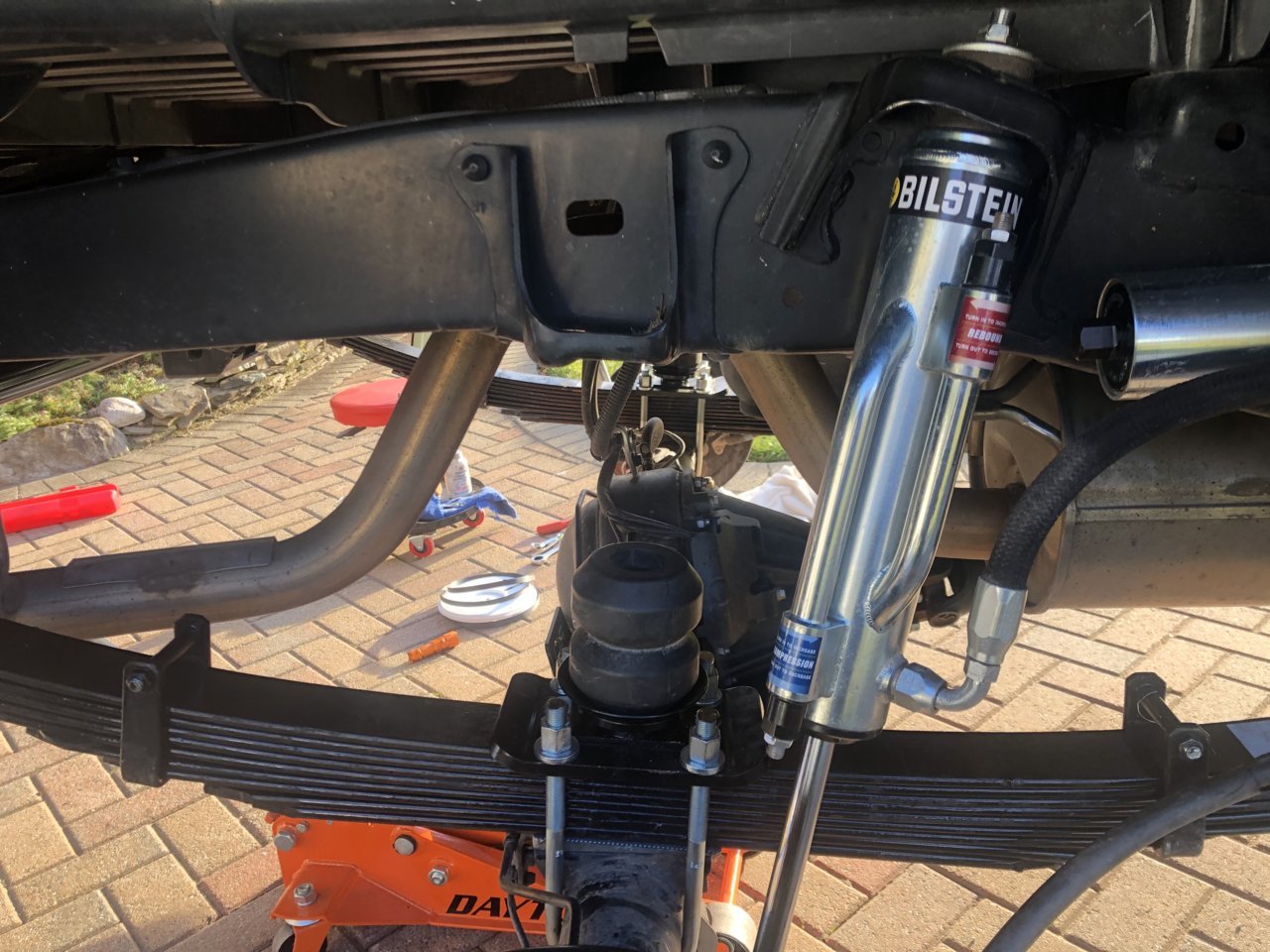

    Installed Hammer Hangers and crosstube today along with Deaver U402 Stage 1 leaf springs. All I can say is WOW !! What an improvement !! Also wanted to thank Erik @ARCHIVE not just for his amazing products but also for his top notch customer service

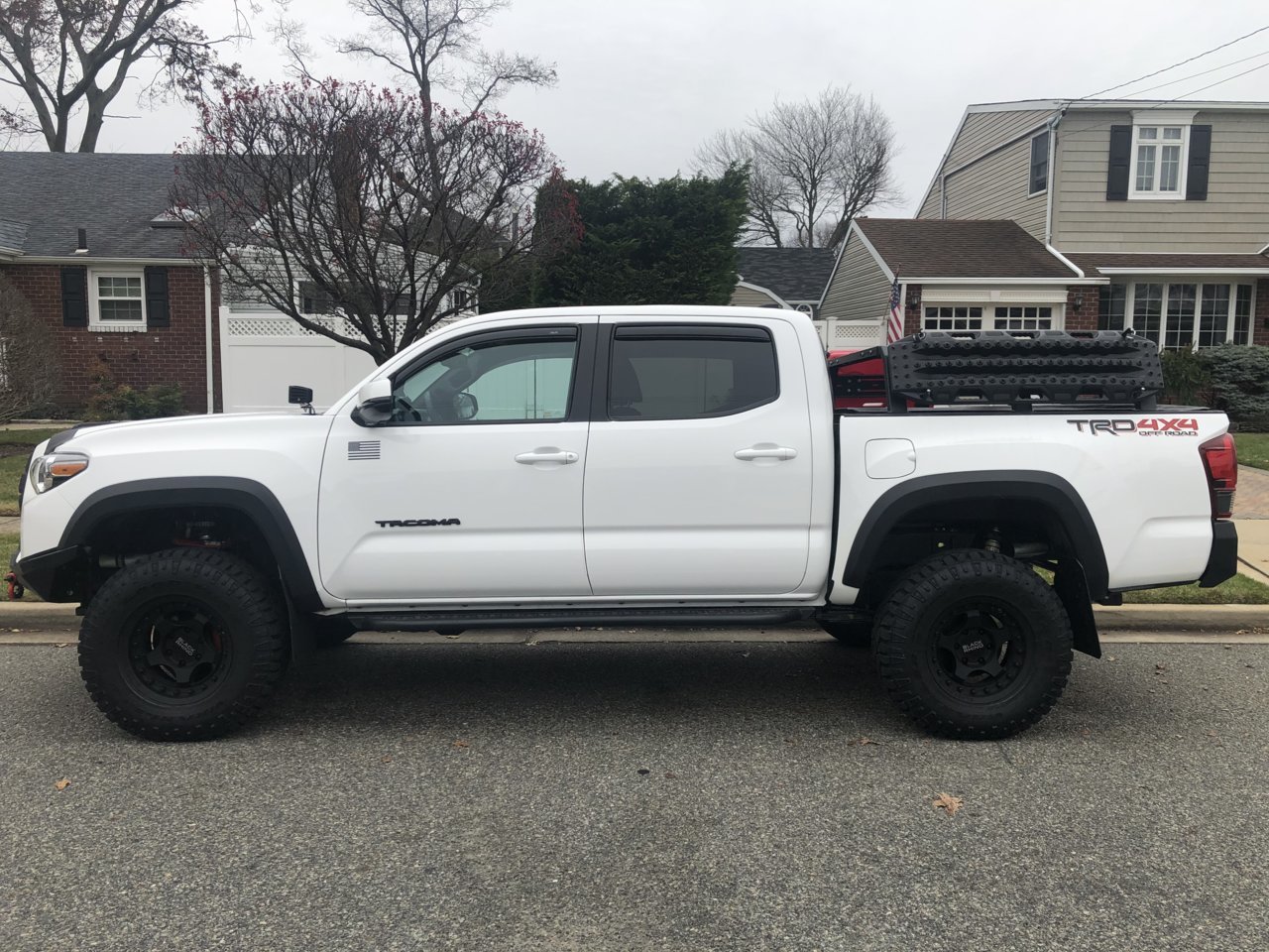

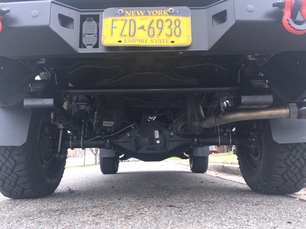

    And this is how it sits now

    Perfect rake :thumbsup:

    Thanks. I couldn’t be happier with setup. I just wish I did it when I originally did lift instead of shitty aal.

    Thanks for posting Greg, the truck looks really good!
