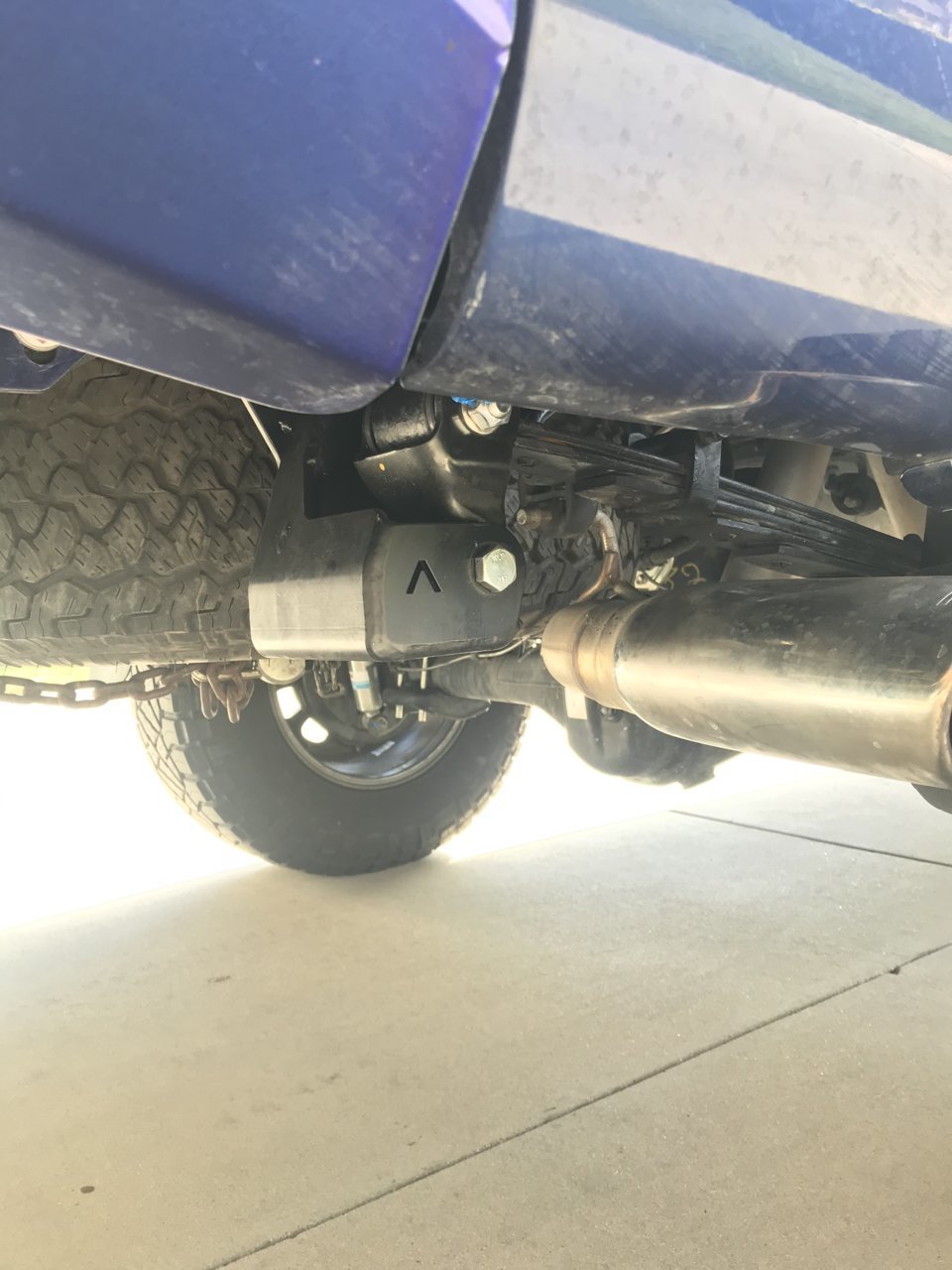

    Got my HH installed last Sunday with the help of a local member @whatstcp. Always great meeting local Members. Big shout out to him for providing his time and knowledge on getting this done. And shout out to Eric for providing quality products and customer service. 31F715DC-B8B6-45B8-B351-9156A5E24436.jpg

    Haha anytime man. And the install wasn’t even bad. I had a fun time.

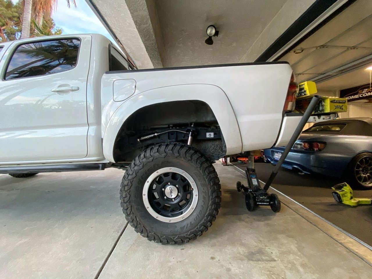

    10.4" travel shocks installed with factory leafs, progressive aal, and shackles with the poly bushing option. The flat factory leaves are limiting about another 1.5" of downtravel in this pic.
