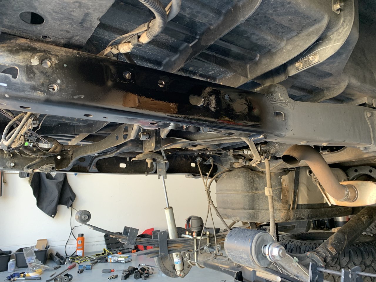

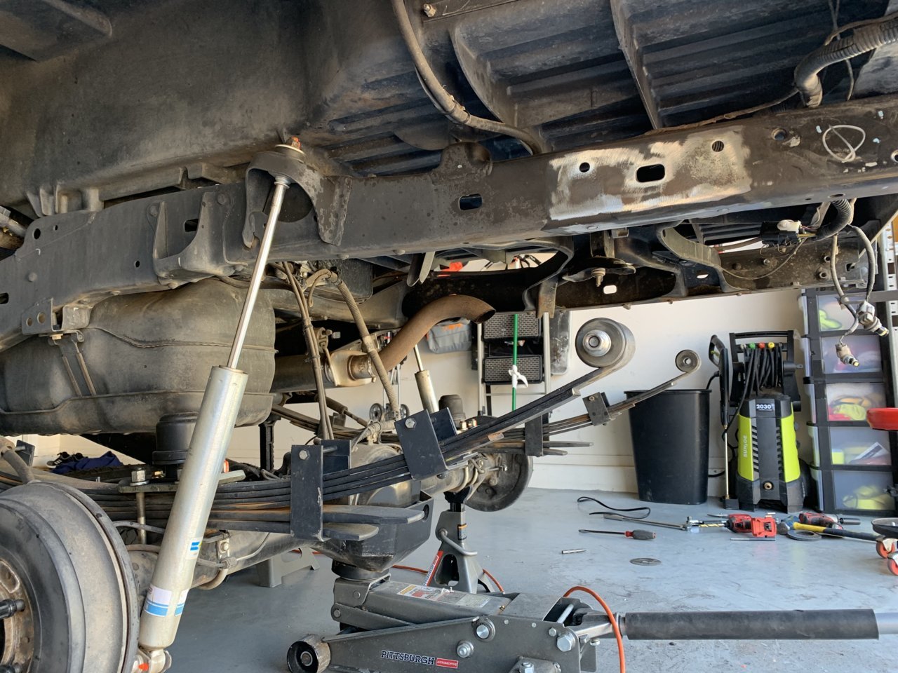

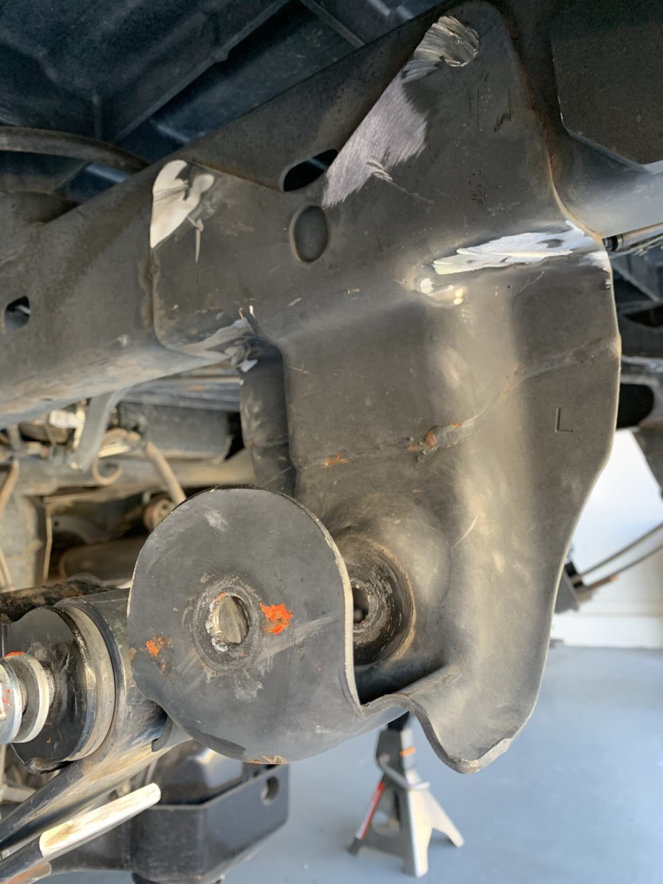

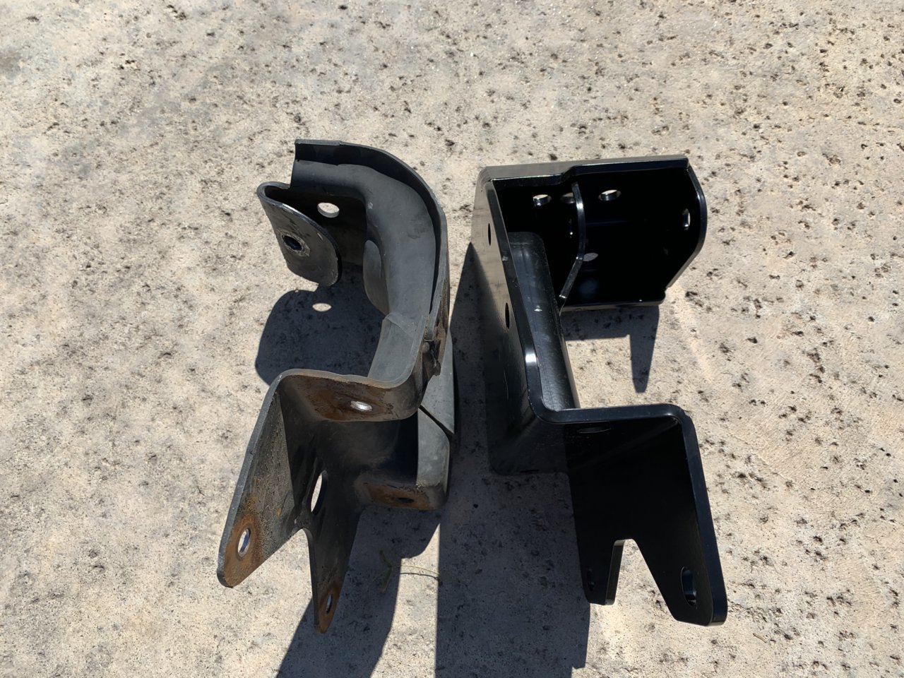

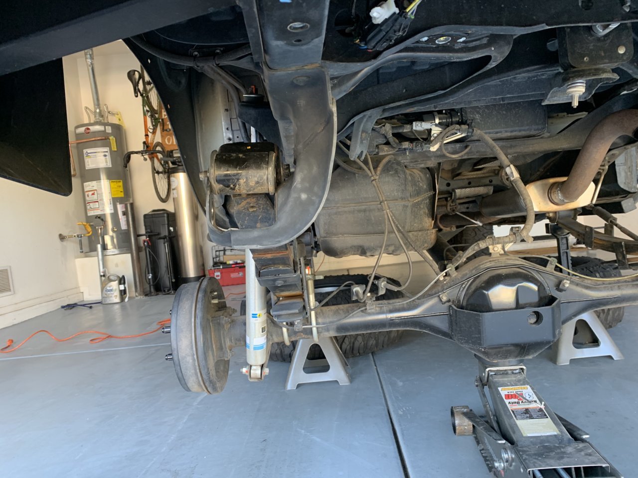

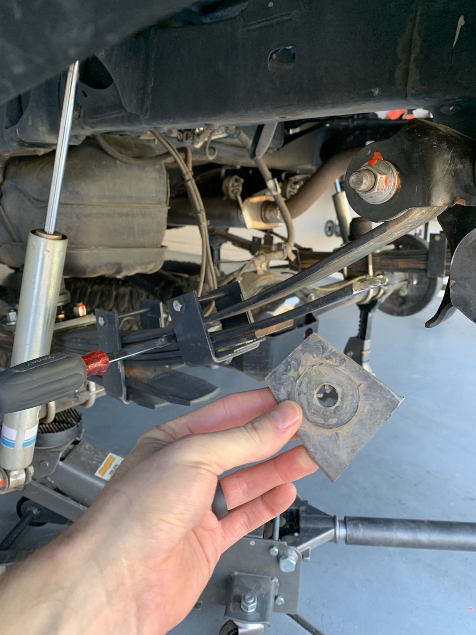

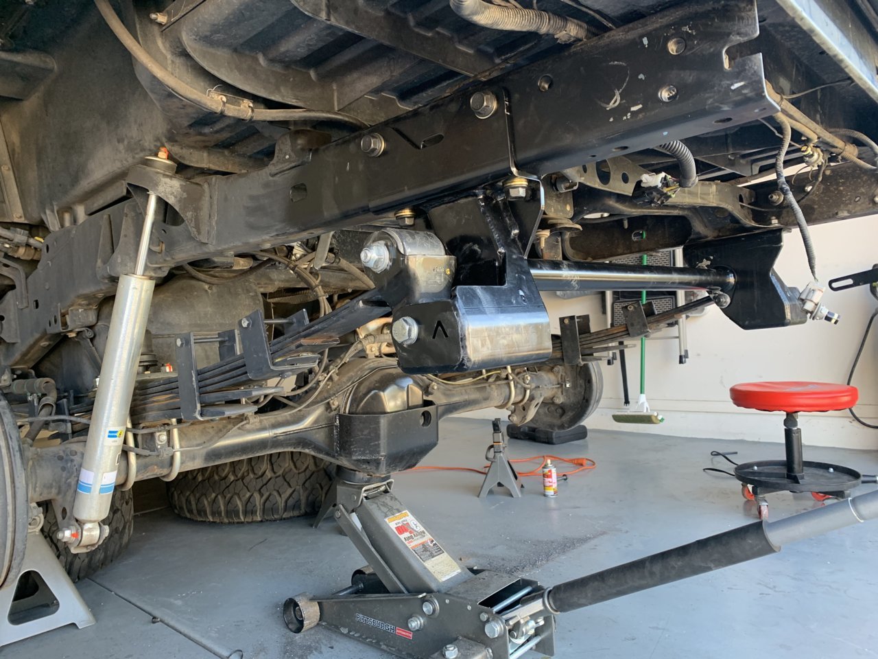

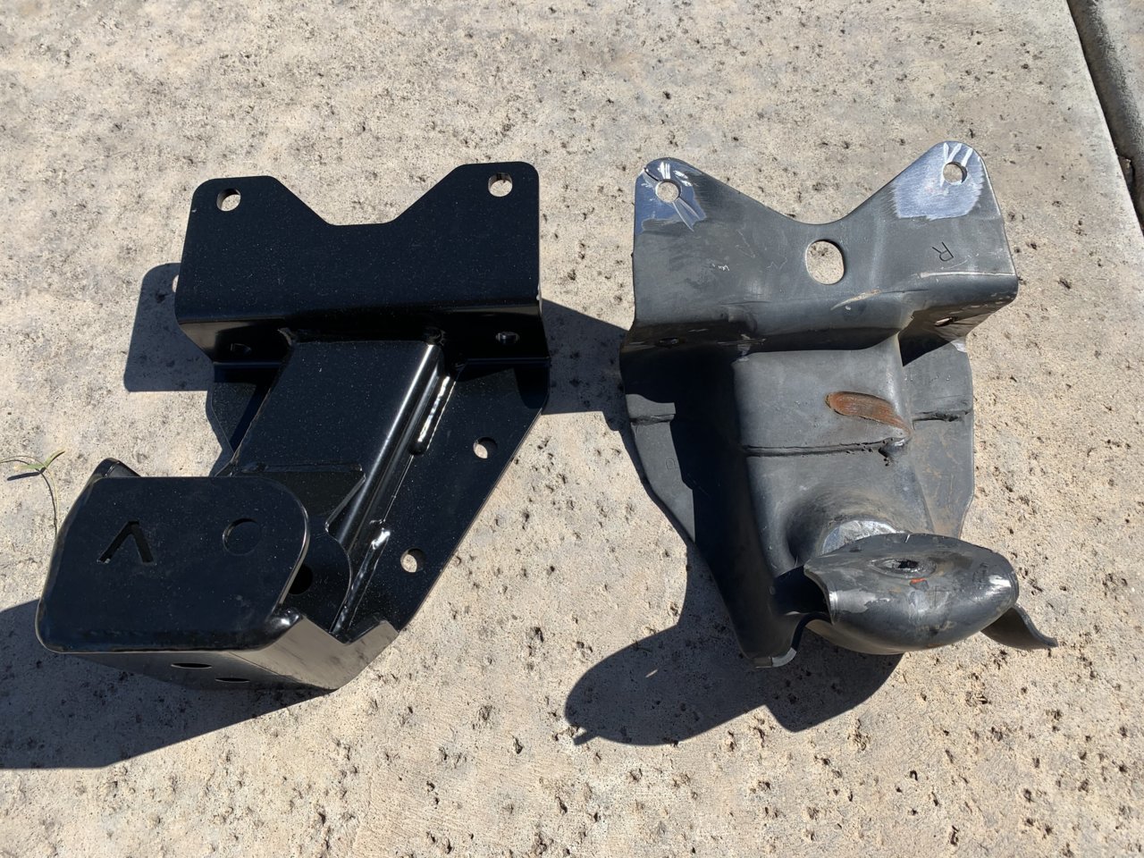

    https://www.tacomaworld.com/threads/singletrack’s-‘dad-shred-build-thread’-i’m-just-doing-it-for-the-kids.619250/ Sos offroad sliders (kickout + filler) Sos offroad full belly skids (steel) Sos offroad front recovery point Sos offroad concepts HC rear bumper with bedside kickout tubes Marlin Crawler LCA frame brace kit Trail Gear rear diff cover Bilstein 5100 + OME 885 Total Chaos UCA BILSTEIN b110 OME Dakar standard pack Wheelers Ubolt flip kit Wheelers Superbump f/r Wheelers SS extended brake lines FN five star 16x8 -25 Milestar Patagonia MT 315/75r16 Custom projector retrofit (acme super h1 + morimoto 4300k) Baja Designs S2 sport ditch pods on CBI ditch pod mounts Amazon AMAK rock lights CMC CB radio hardmount
    Thanks to all the advice throughout these threads, and of course from Eric himself. Install only took about five hours, and that included trimming my second leaf on my Dakar leaf Packs & swapping Out new OEM shackles that I tapped with grease fittings, as well as removing and replacing my high clearance bumper to make the job a lot easier.
    Just as anticipated, gained 0.5” of lift with stock shackles & Standard duty dakar pack
    Cutting the rivet head off with a cut off wheel, then grinding the area smooth, center punch, drill through and repeat worked really great. No drama, just lots of hot metal shavings. No swearing either, it went smooth. One thing I like to do now, is add PB BLaster to whatever I’m drilling to aid in penetration & as a lubricant....
    Anyway, immediately noticeable increase in ride quality around town. Will report back after some HARD trail miles. So glad I got this done, finally. Been sitting on these hangers for months.

    Nice Tyler, thanks for feedback and pictures.
