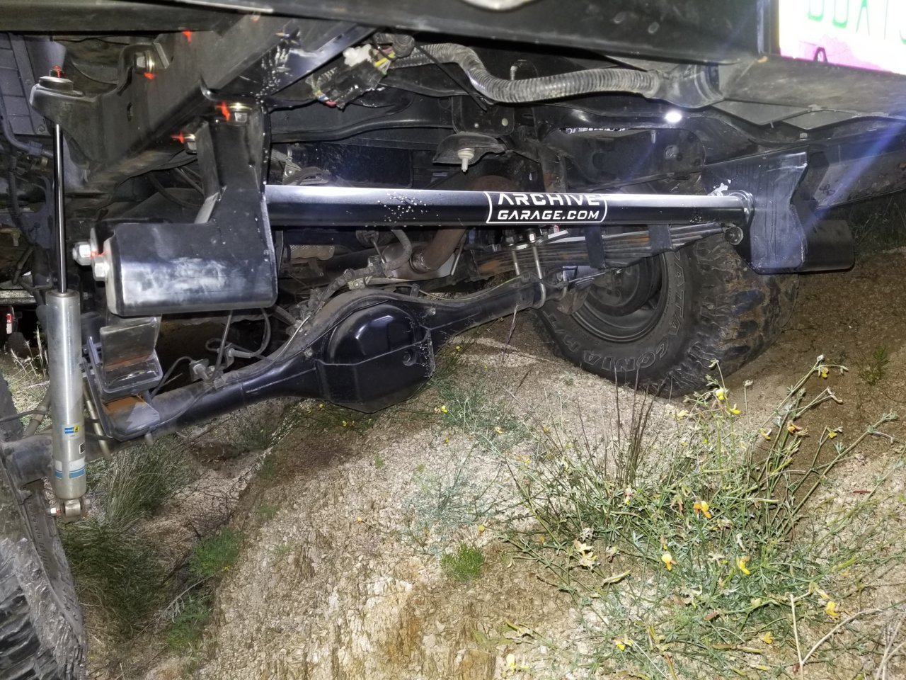

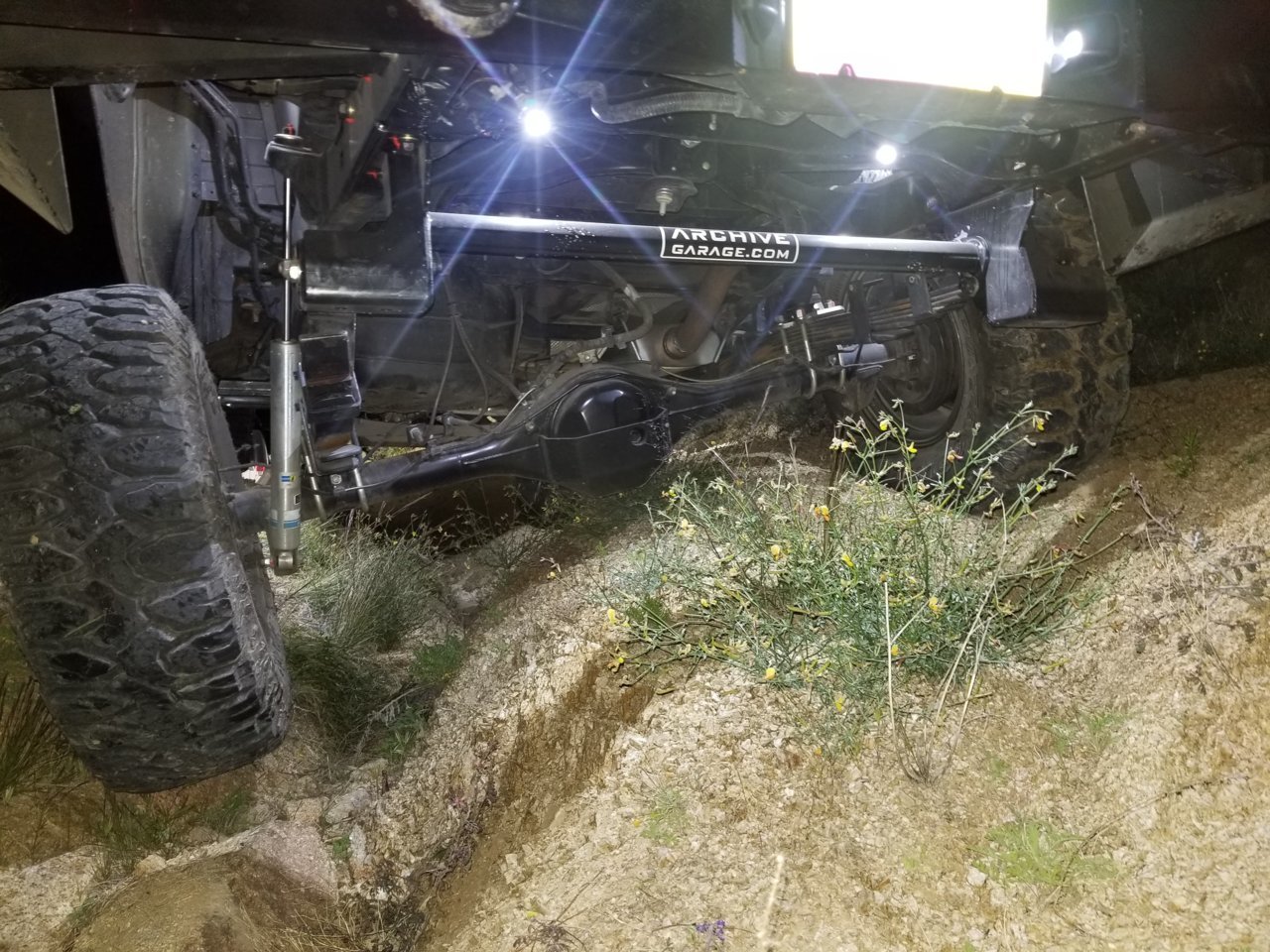

    A few glamour shots of the wonderful hammer hangers - which have dramatically changed the ride quality, flexibility & durability of the back of my truck. I wish I purchased these sooner, killer product. My buddy BRYAN definitely approves (as he can be seen here, respecting the flex)

    Thanks for posting pics and feedback Tyler. The install looks good to, all bolts pointing my preferred direction :thumbsup:

    I pay attention (occasionally) and I wasn’t about to have a bolt marr up my HH. Your design and the quality of the hardware is just fantastic.
