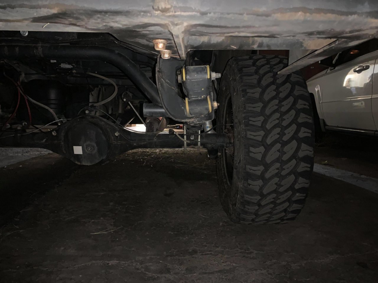

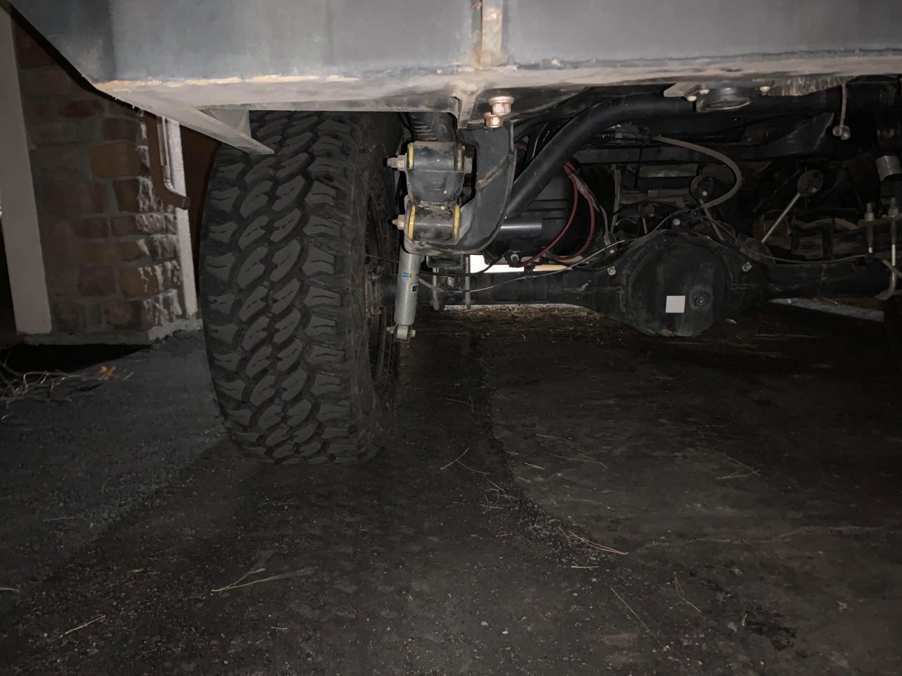

    OK top of the axle tube to the bottom of the frame rail is 12 1/4" so apparently I have 4" of lift in the rear with all the weight of the bumper and spare hanging off the back.

    That's about right. The Deaver U402 series target 3" lift with the rated weight range.
    I think you have a decent amount under the stage 3 range of ~700-1000 lbs.
    Stage 2 are 400-600
    Stage 1 is 0-300
    mcharfauros and Casper66[QUOTED] like this.

    Yes Sir the only real rear weight is the SOS rear bumper with the swingouts and spare however much that weighs. Best top is light I am happy with it absolutely no complaints. It's high in the ass but I m ok with that my front lift has dropped to about 1 1/2" anyway but it all works great

    1/2 the slider weight goes on rear axle, the swing out total is probably 250+ but also behind the axle equaling more, so the rear axle might be seeing 400-500 lbs over stock weight

    Now drop about a 300 pound tongue weight on the hitch and goo down fire roads with it. This is how you sold me the product. This rear suspension setup should handle all that wonderfully especially when I add the cross tube

    Yeah, so you should be right with the trailer on.
    As we have seen from internet and bending frames towing offroad, you want extra capacity when towing offroad.
    The entire weight of the trailer can work on the frame during a hard hit in a washout. I say keep as much bump travel as you can, once the bumps are compressed, the stress on frame ramps up if the payload and trailer have more force to impart.

    Thanks Eric I just have the standard Super bumps I have not spaced them up or anything. The truck only drops about 1/2-3/4" when the camper is hooked up
