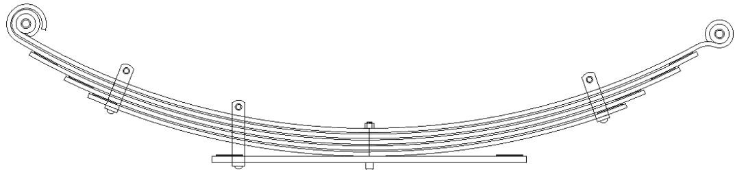

    Thank you. They will not be side specific, I think the lean is basically a non-existent issue with SOA springs that have a higher rate than limp-wristed stock springs (I feel stock spring rate is too low for stock weight DC).
    Owners should remember to adjust driver side coilover up vs. passenger side and load truck accordingly. Another trick if you have 2 "same" packs is stand them up on a level surface and see if 1 has a bit more arch, if so, use it on driver side.
    Edit: Here is an image of initial design I should have in hand soon. I wanted really bad to make the front eye a Berlin eye like the rear, but Toyota put a little tab in the way for parking cable and it was too close for comfort, since my purpose is to build a high functioning leaf pack that will eliminate the numerous issues so common in the Tacoma aftermarket spring choices.

    On lift, I was leaning towards 2" lift. Who has opinions on lift height? What is Ideal?
    Note the pack thickness is going to be around 2" thick, Deaver U402 are around 3" thick, so these may allow an extra 1" bump travel vs Deaver

    I was thinking 2" at stock weight DC. I appreciate the suggestions and I have left the possibility for an AAL to the pack, but also the the 4th leaf down could possibly be removed for light duty. The remaining leaves are still stouter than stock
