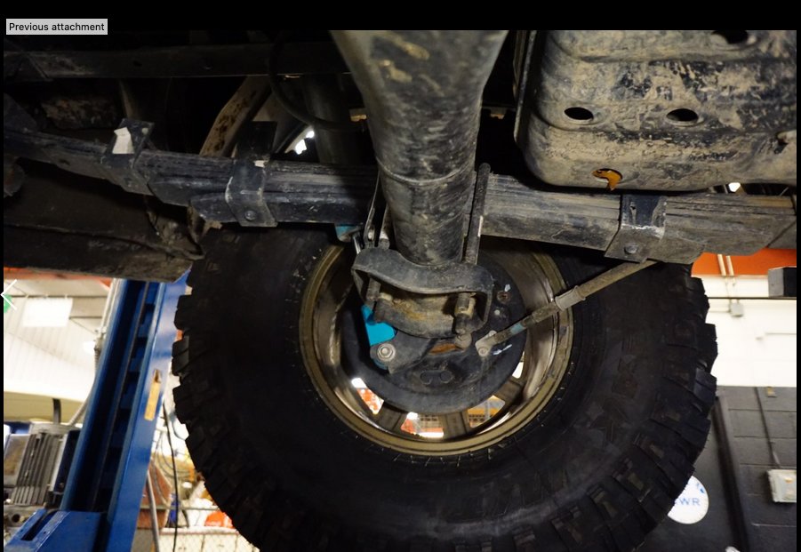

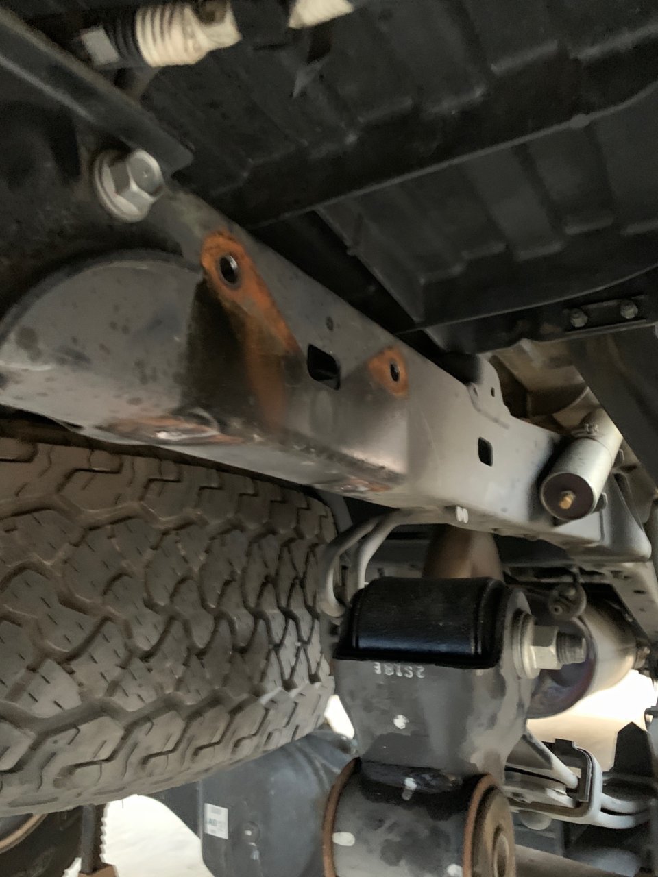

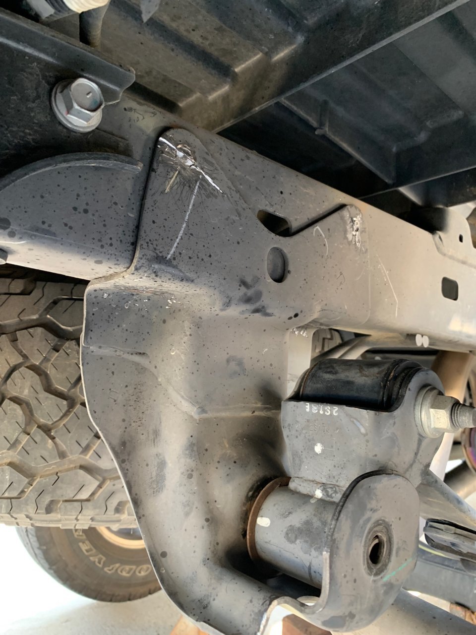

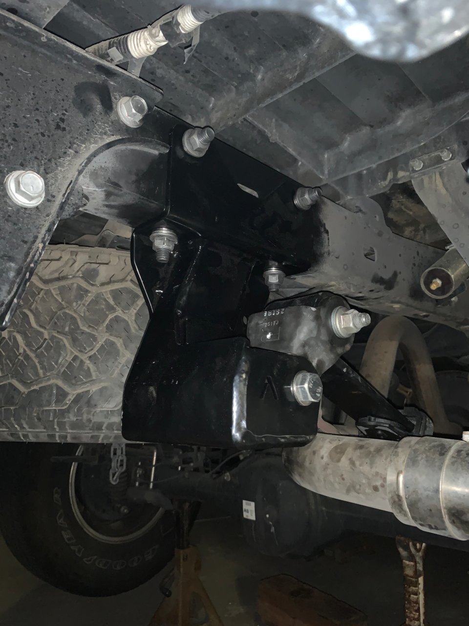

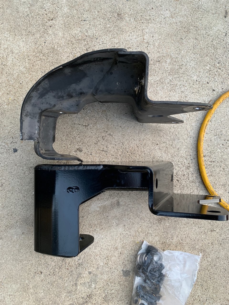

    i got my hammer hangers installed the other day about 2 hours a side. pretty strait forward. buy some good hard metal drill bits and some taping lube and go slow. i did it the same as everybody else. cut some x's on the rivet heads and then pneumatic hammered the tops off and drilled them out. well i got the three easy one out then used the force of the spring and a pry bar on the spring to beat the old perches off. then the forth rivet i ground off and drilled and hammered the rest of the rivets out. also attach the new perch on the spring hanger then bolt the perch to the frame. now i can't wait to get some deaver sua action going. anyone is socal holding on to a pair?IMG_3793.jpg IMG_3794.jpg IMG_3795.jpg IMG_3798.jpg IMG_3808.jpg

    I forgot to mention that the difference is noticeable driving the truck out of the driveway. Way less shimmy and chatter. Very noticable
