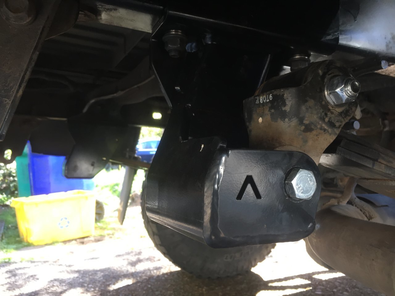

    The secret to a non stressful install is to do it in stages, did the rivets on the driver's side hanger last weekend and then the passenger side today. Now it will be just a matter of unbolting them when it's time to install the hangers.

    Are we supposed to reuse some of the washers from the original shackle? I finished my install yesterday but once done realized my kit only came with 4 washers for the M14 bolts. I put the washers under the nuts and none under the bolt heads. Now looking back it looks like everyone is running a washer under the bolt head and nut... but all the new kit pics ive seen only show 4 washers with the hardware.
    @ARCHIVE Do you think it's worth the hassle to pull it apart to throw 4 more washers on under the shackle bolt heads?

    That's fine as is, I like to put the washer under the bottom bolt head, instead of nut, because you turn the bolt to tighten, not nut.
    You got the upper washer how I recommend it.

    Ah thank you, that would've made sense with the washer under the bolt head torquing it down but since it's already together I'm not going to worry about it.
