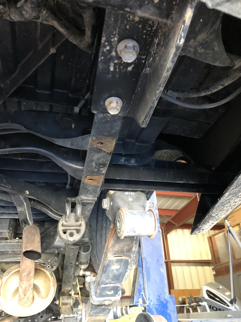

    Humble brag, just knocked out an install in two hours. The right tools and an extra person makes all the difference in the world.

    Just grind the heads off and knock the rest of the rivet out or drill them out?

    Not when there’s a pandemic going on! :anonymous:
    Grind head off rivets
    knock off hanger
    grind flush with frame
    knock out the side two with an air hammer and flat tip punch
    Drill out bottom two with Eric’s sweet bits.

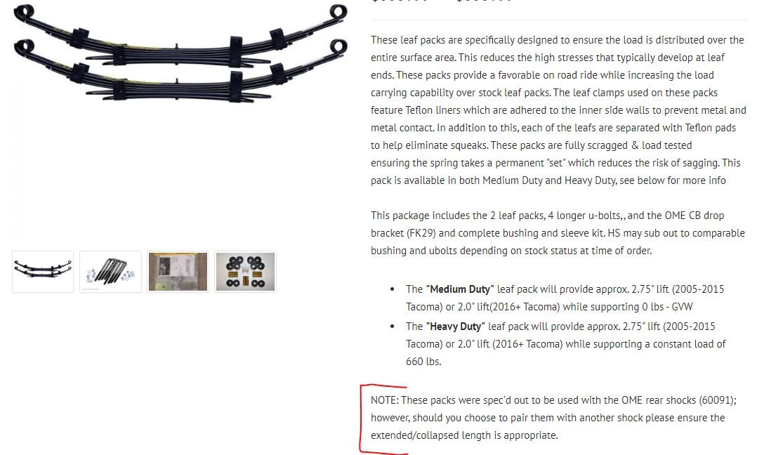

    Did anything ever come of this from ARB's end? Just recently found that this was the culprit for all the metal clanking I have been hearing lately. The shackles are also gouged up from this happening.

    Yes, but this little note is all that came of it as far as I know

    Thanks for the update. Have others done what you suggested and trim those leafs? Hate to drop more money on some new leafs because of this problem.

    Yes, just need to take a out 1" of length off them and round the sharp corners of 2nd/3rd leaves
