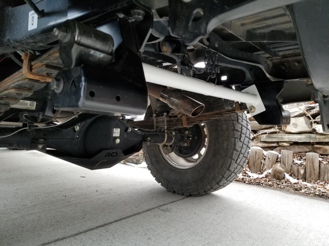

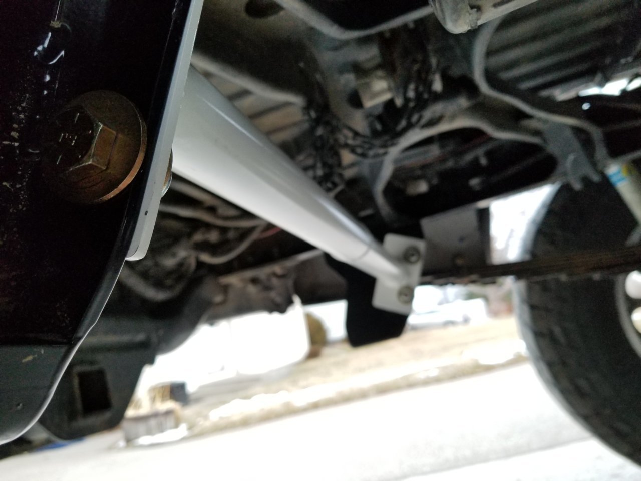

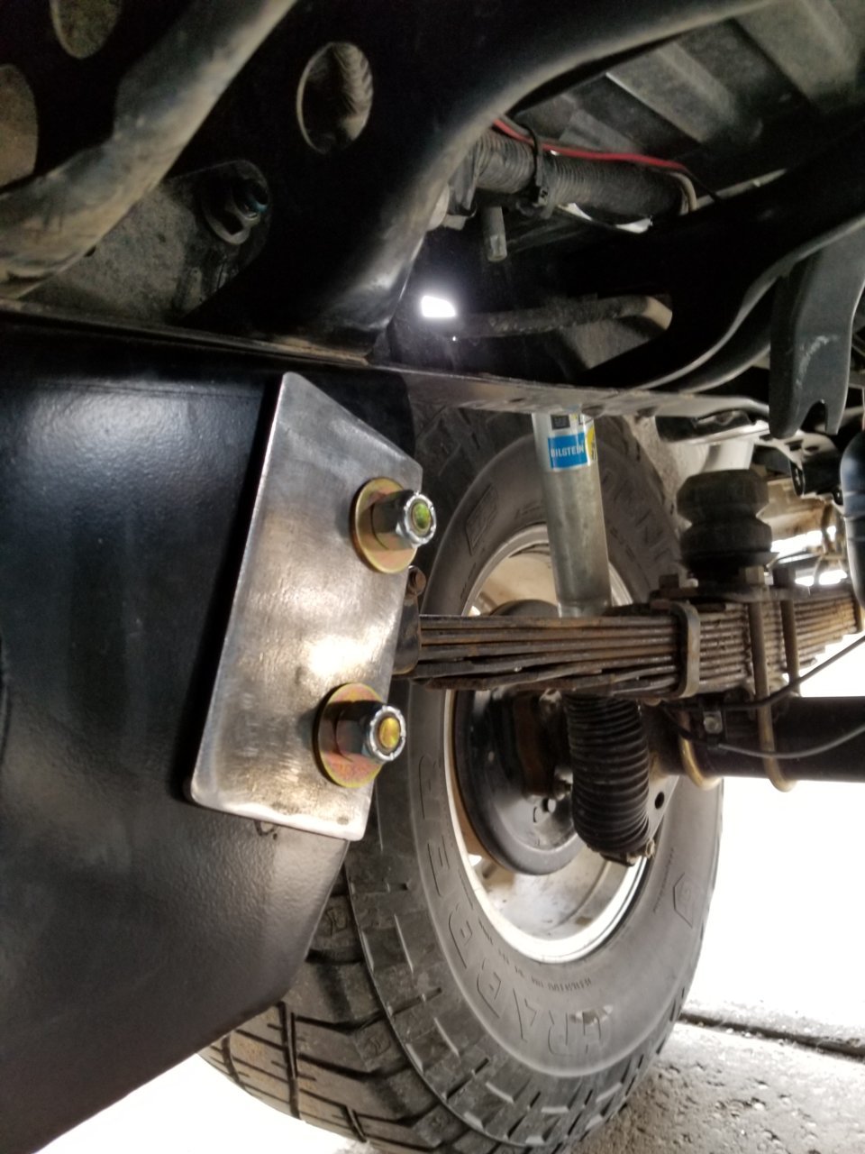

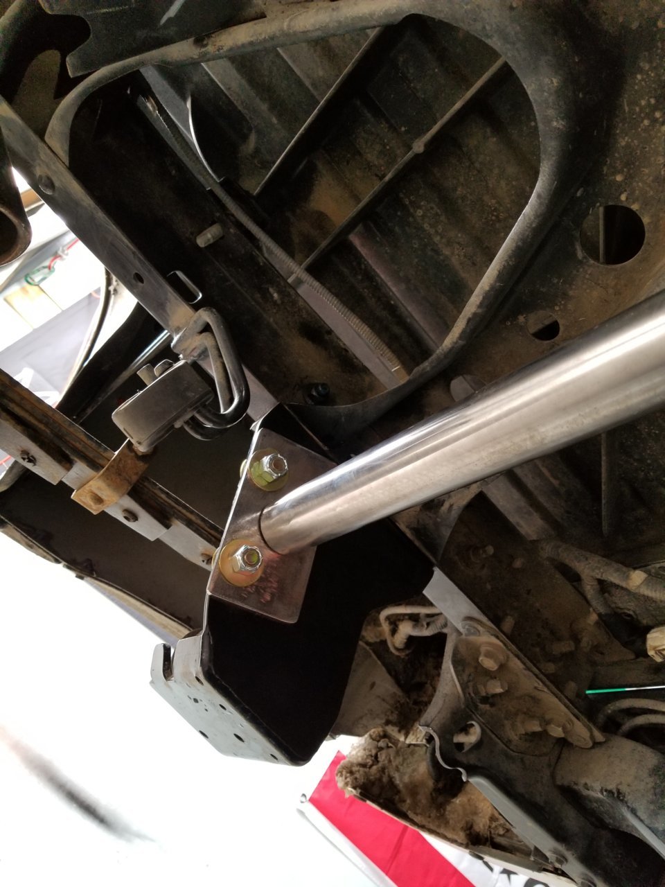

    What Eric said. I'm actually keeping it because I have a HC rear bumper with swingout on the way so it will drop back down after the weight.
    I made my own crossbar support today. Came out pretty good.

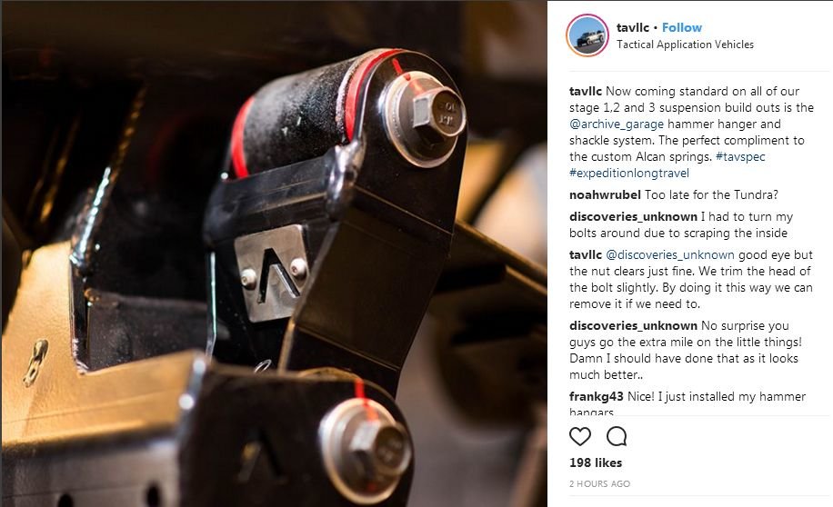

    Tactical Application Vehicles posted some pics on Instagram of the Hammer hangers with 4.9" shackles and Alcan springs (unloaded), I'm excited to be working with TAV
