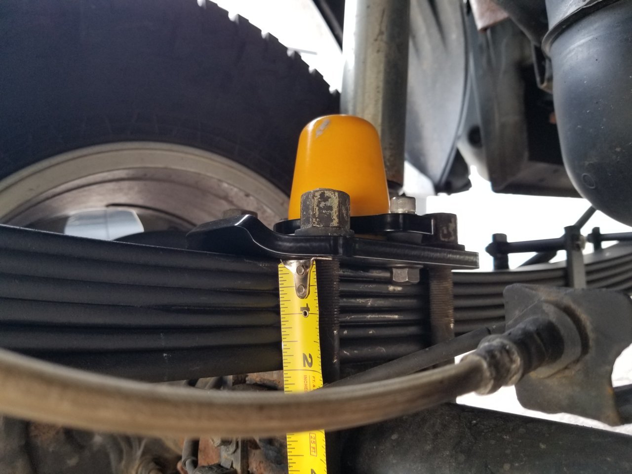

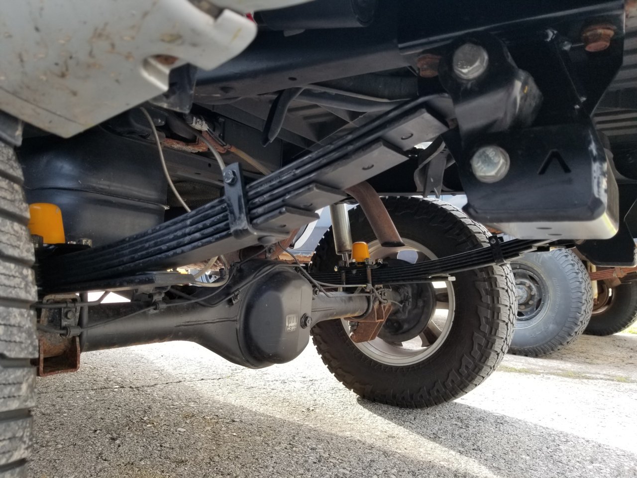

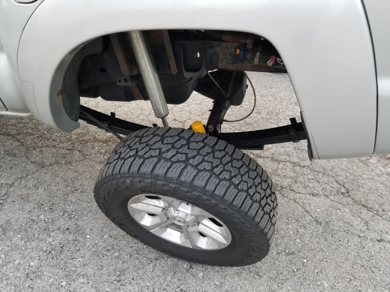

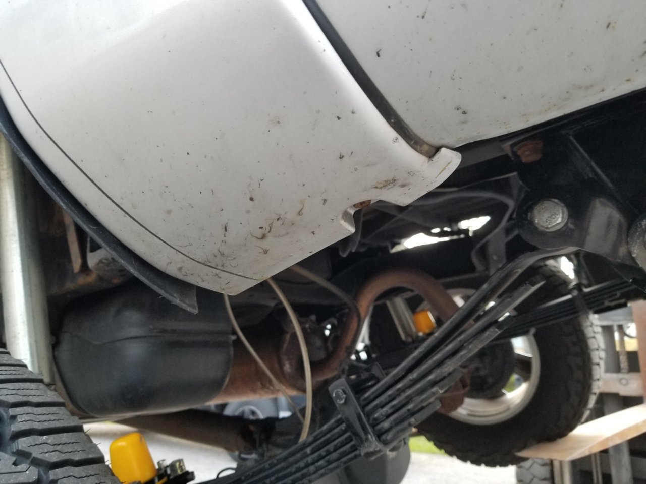

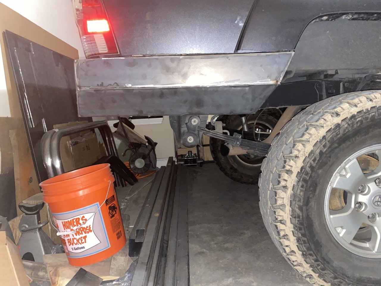

    I installed the springs a week ago, they were good in a lot of areas, fit and length were good. The capacity was a lot higher than I was aiming, so this set turned out to be HD, like 750-1000lb range for 3-2" lift respectively. I drove the truck with 1,000+ lbs and the spring rate felt great with good handling. Lift was about 2.5" with 1,000.
    Then I unloaded most of the weight, had maybe 150 lbs and was surprised how good the ride was, no jarring to the ride. Lift was closer to 4" at that point, so these need the weight.
    It did flex quite well even unloaded and would be a good match with 12" shocks, I don't have exact numbers.
    So basically turns out I am starting from top down, this pack will be awesome for the heavy trucks. A couple small adjustments and I am ready to offer it.

    Sounds like the spring I need. What is the thickness of this spring pack at the spring perch?

    It is 2.1" thick, significantly thinner than Dakar HD or Deaver, so it will allow more bump travel

    Your use sounds about perfect for these. I was thinking that the recommended minimum weight would be 500lbs (You could go less, and it isn't jarring, just firm and really too much spring rate for stock weight).
    The rubber bushings are great to me, they seem to use about 11" of shock so far, so will use all of stock location shocks. To repeat, rubber bushings help my goal of having a leaf pack that can endure severe duty off road travel for years, without maintenance.
