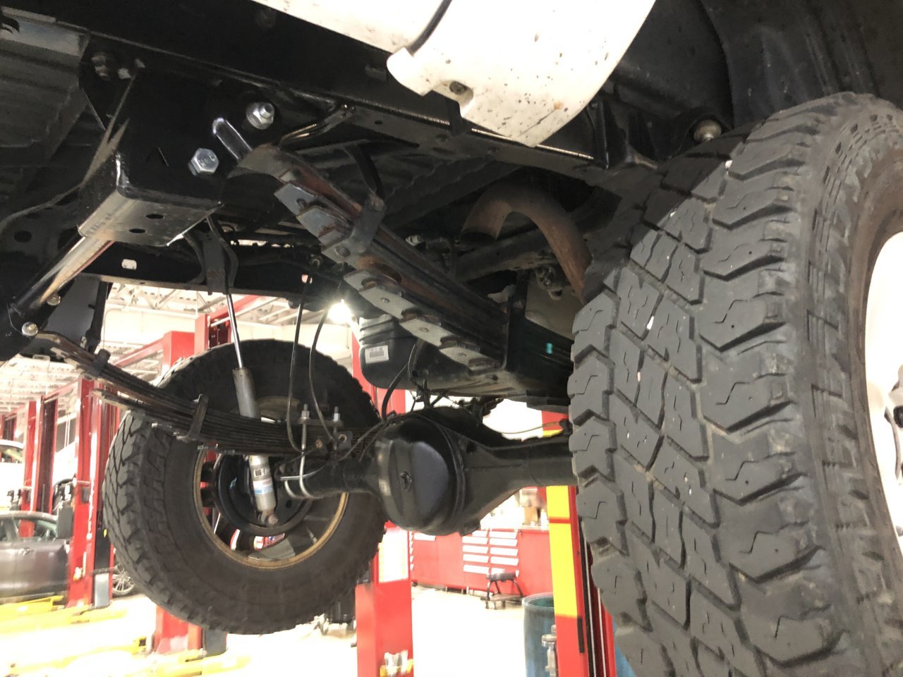

    IDK about with the Dakars but with Deavers the B110's are the limitting factor in droop. These pics are with the truck hanging off a lift, shocks are maxed out, and shackles are only about half rotated. It's fine for what I do but for somebody wanting more flex I would think a relocate with longer shocks would be prefferable

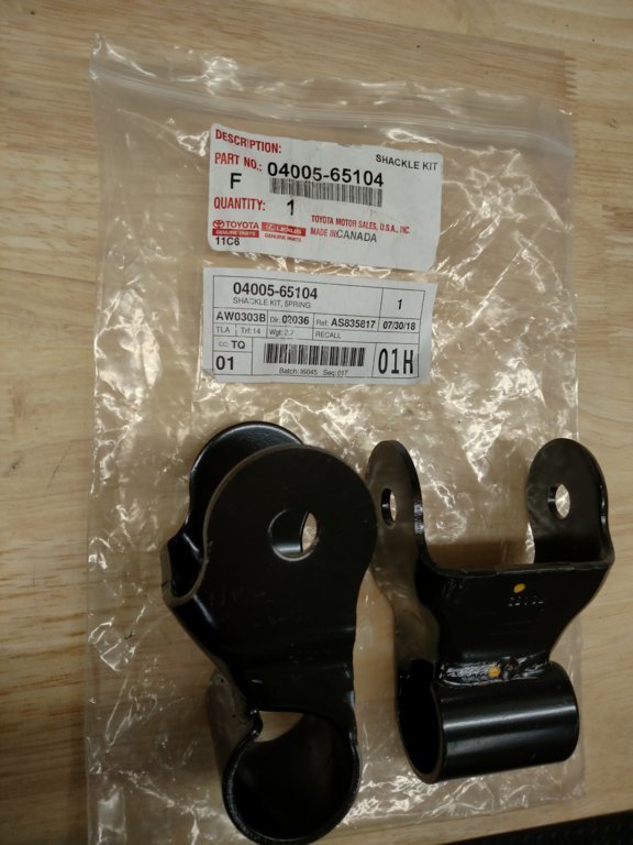

    Yes with Eric's polly bushings. For Lord's sake ask @EatSleepTacos or somebody for the part number for the shackles without bushings. IDK you could get them that way until right before I was doing the install. Getting the stock bushings out of the stock shackles was time consuming

    The part number is on Archive's website, too.

    Found them! Thanks for the heads up. I am going this route for sure.oen shackles.jpg
    Do you lube the shackle bushings with any grease before install?
