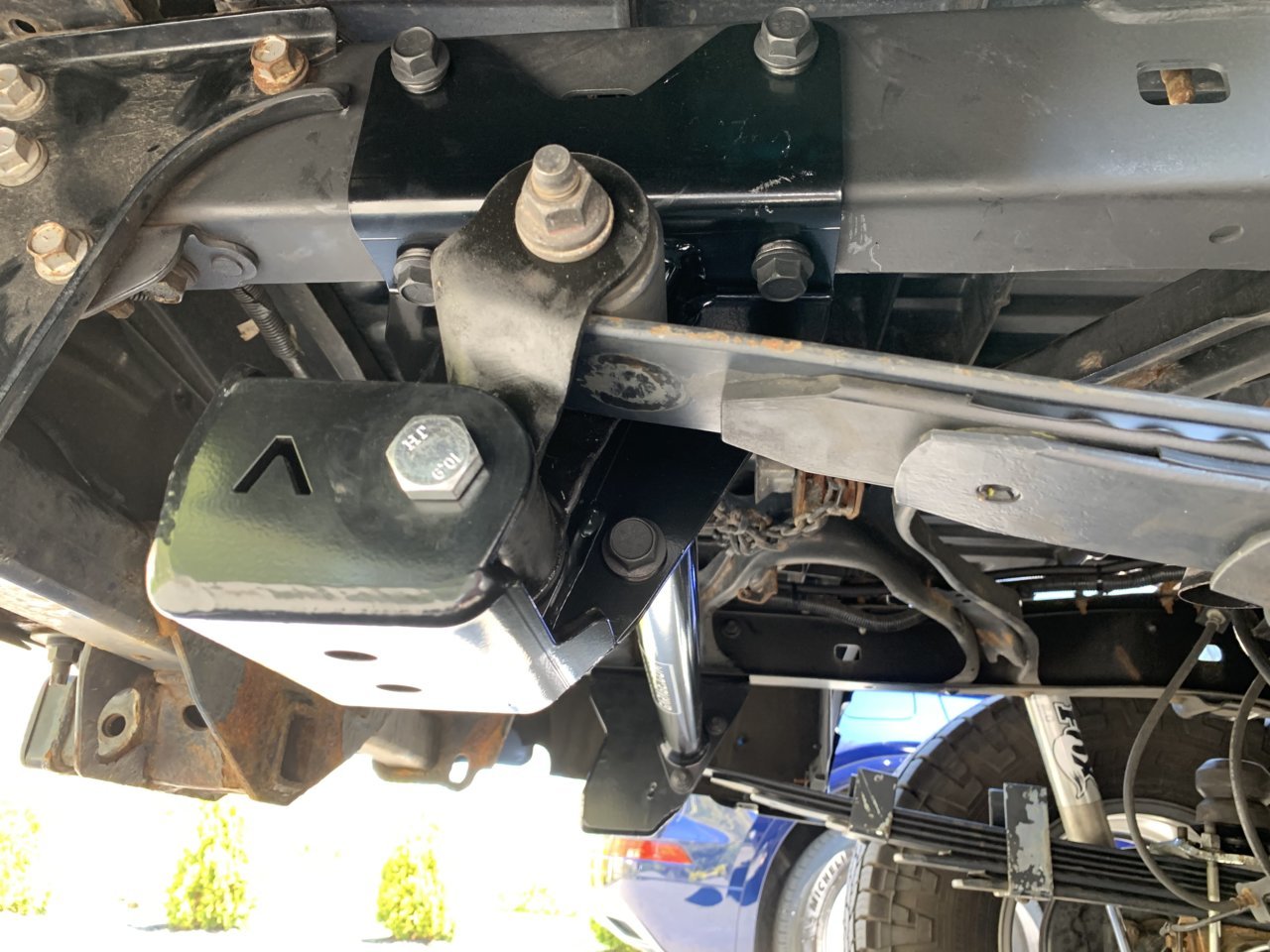

    Thanks Eric for making a righteous and incredibly stout product. These things have been sitting in my basement for MONTHS awaiting install... I have been actually dreading this install, simply because I have a small space to work in and with a 1 year old running around, alls I want to do at the end of my day is drink until I pass out.. lol. That being said, these hangers are awesome and for Toyota to make such shitty flimsy factory hangers, they sure as FUCK didn’t want to come off. The stock hangers came right off once the heads were cut and chiseled off, but man oh man. Those rivets going up and down through the stock bed brace almost made me cry... lol. Anyway, but these hangers they are sweet, as everyone has said, the driving is a very weird, comfortable, planted feeling. You really need to experience it to understand. EBF0C969-0788-4DD7-A03A-0F683A7BA825.jpg 8D305759-F391-4A3A-B387-E0B40A071404.jpg
