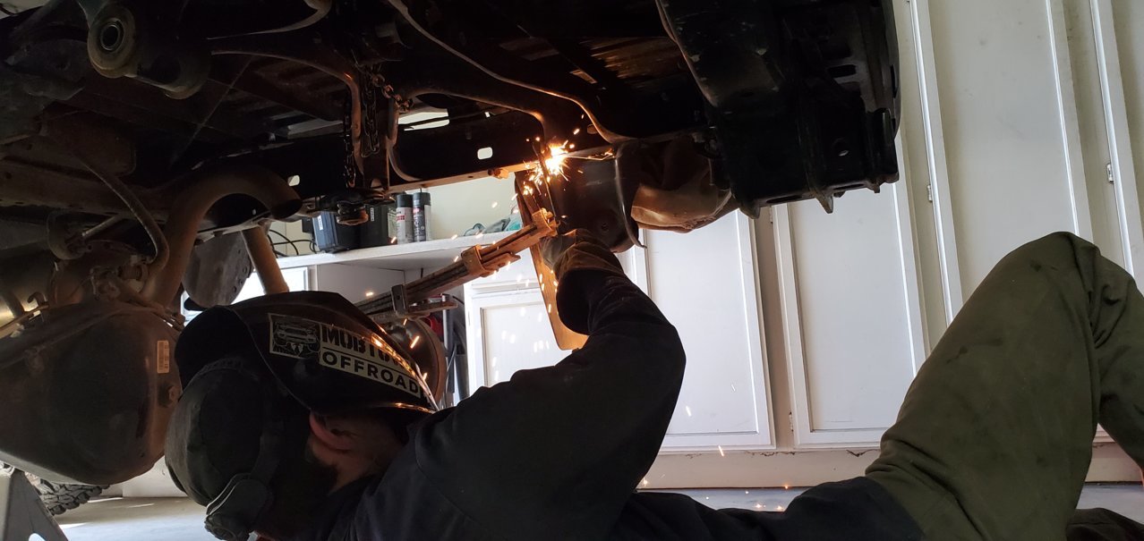

    wanna be mods
    Very true.
    Just took the first trip with the wife baby and dog, so the wife was up front, but I'm not telling her what I feel/notice...but I'm now really eager to buy my suspension upgrade, wish your leaf pack (medium grade) was available in the near future!
    Nevertheless stoked about the vehicle feel over ruts, washboard paved roads (so far).
    I've now driven approximately

    After the install on your truck, I ordered a plasma cutter. I’m done fucking with that torch lol
