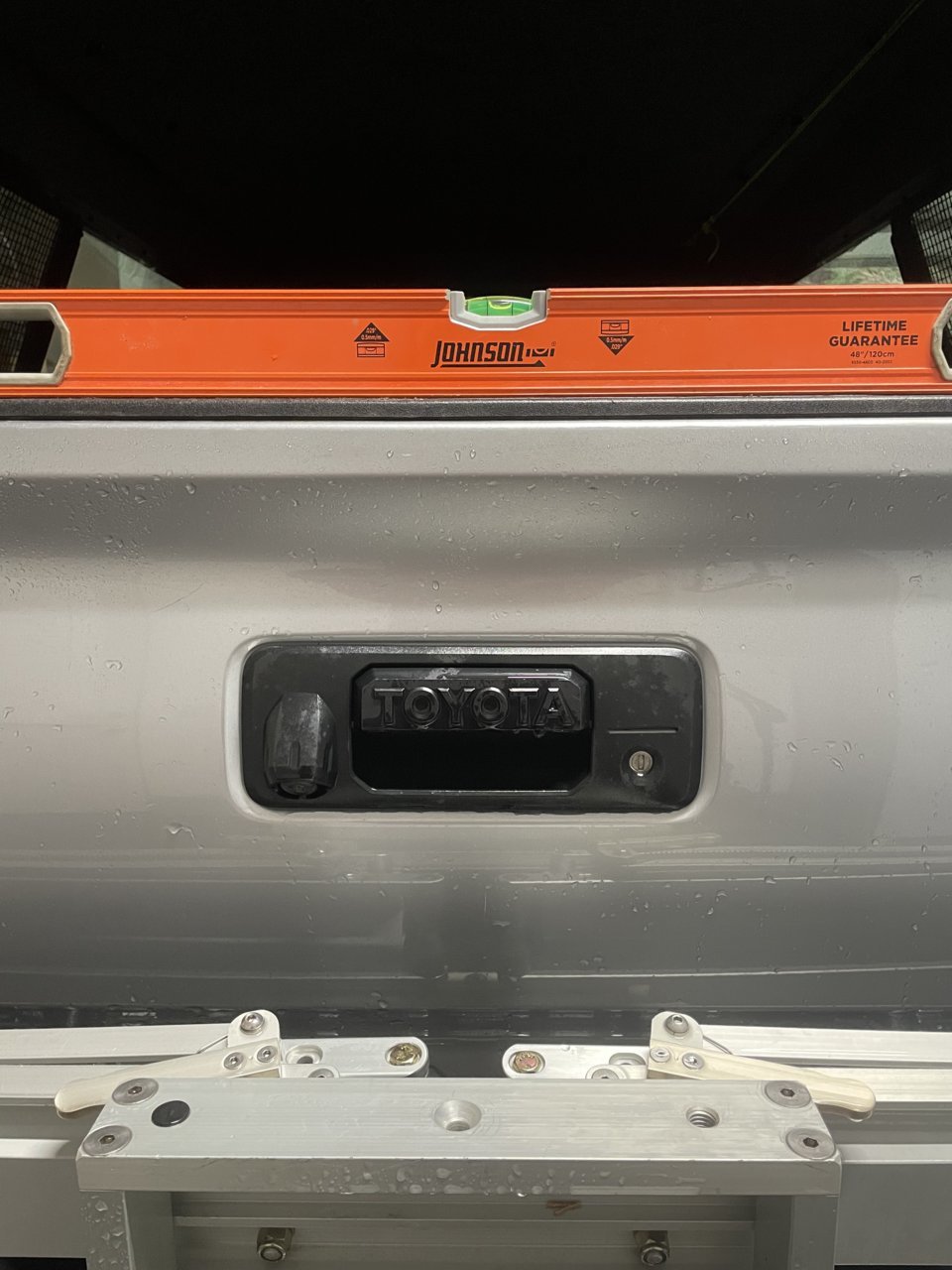

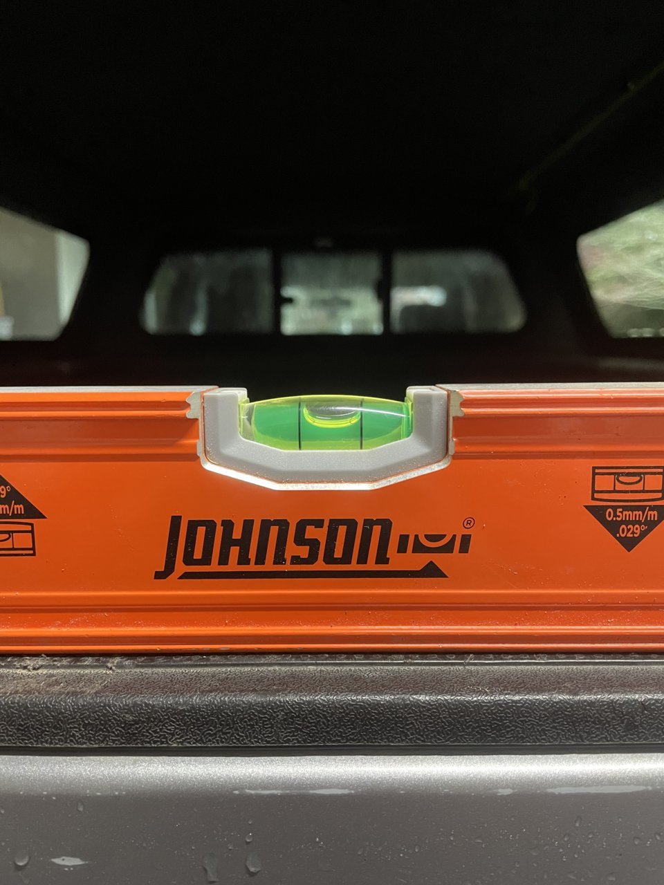

    Check out the taco lean spacers that Headstrong Offroad offers, I had pretty bad sag on the driver rear. I installed both the 1/4” front spacer on drivers side and 1/2” rear spacer on drivers side. Even though my front end seemed level, I did both and have no more left/right sag. Good luck!
