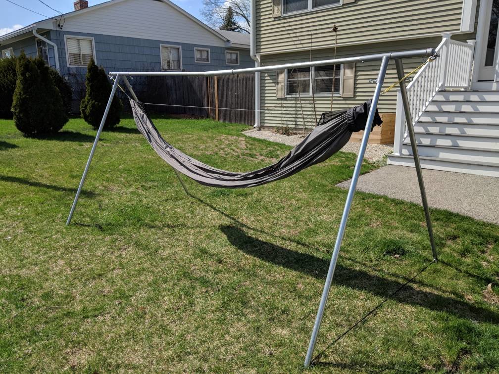

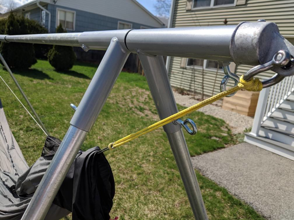

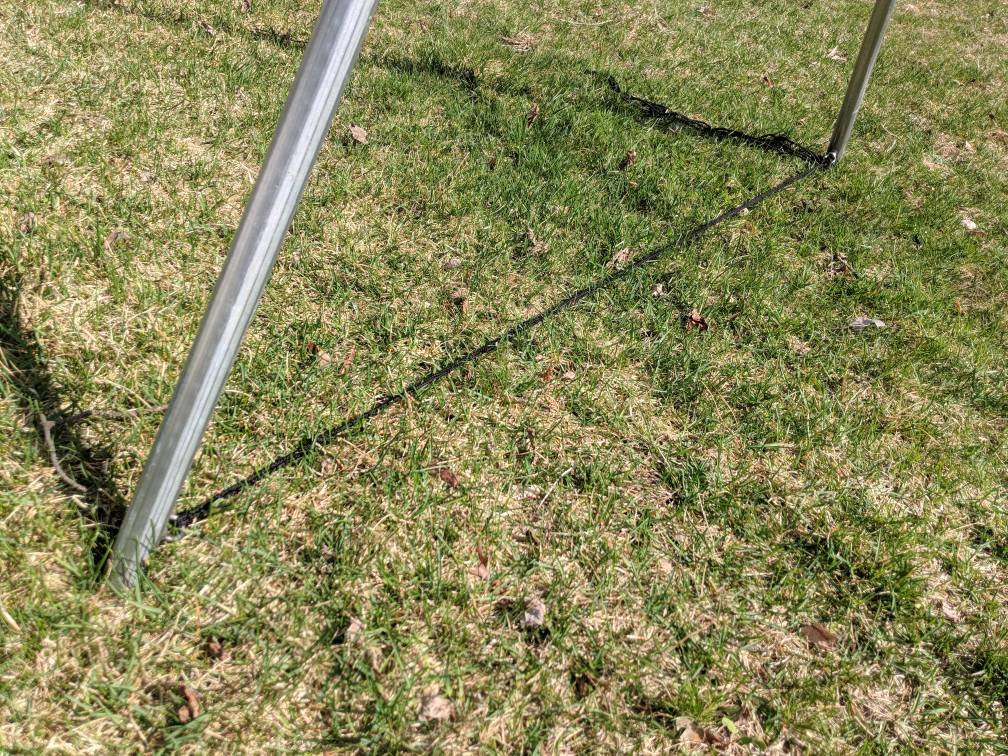

    Yep. here it is more detailed:
    https://www.hammockforums.net/forum...quick-bipod-style-stand?p=1883480#post1883480
    $30 for the 4 uprights and $36 (with shipping) for the L connectors. Used the amsteel (yellow) from the turtle dog stand. The eye bolts on the bottom of the legs I had from another project and I tapped the holes to thread the bolts.
    The top rail is two sections of 6' with an 18" length of 1-1/2" pipe as a joiner. This is what I had on the turtle.
    Sturdy AF

    Nice.
    No movement end-to-end? Stability on uneven ground?

    There is movement but it's not unstable.

    Pretty solid. I can even put my penny pincher tarp on there and fasten it to the legs. The only issue that I have had so far was at the NH Jamboree this year. We had a micro cell hit us with continuous 50knot and up winds, and it got blown over, even staked to the ground. But EVERYONE's camping gear got blown over that night. Other than that, the movement is very minimal, not enough for me to be nervous in it....
    Edited to add: I was NOT in it when it blew over LOL
