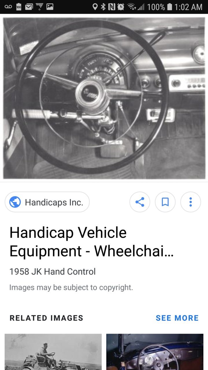

    Back in the day (late 70's) I had a friend that was paralyzed from the waist down. Diving accident and I was there. Anyway, every time he would get a new or different car I would install his hand controls. Talk about simple - it was a lever that mounted on the steering column that had two rods running from the control. One went to brake pedal and one went to the throttle. You twisted the lever (eccentric cam) to apply throttle and pulled the lever towards you to brake. We just moved the same control to the newer car.

    This pic is similar to what we used back in the day...Screenshot_20180828-010231_Google.jpg

    Ok, I see it now. That's pretty old school compared to what this dud had. His was all controlled through the computer throttles and brakes. Very cool system that had dual systems for both handicapped and for himself that wasn't handicapped. He could change back and forth depending on who was driving the truck. Very cool system indeed!
