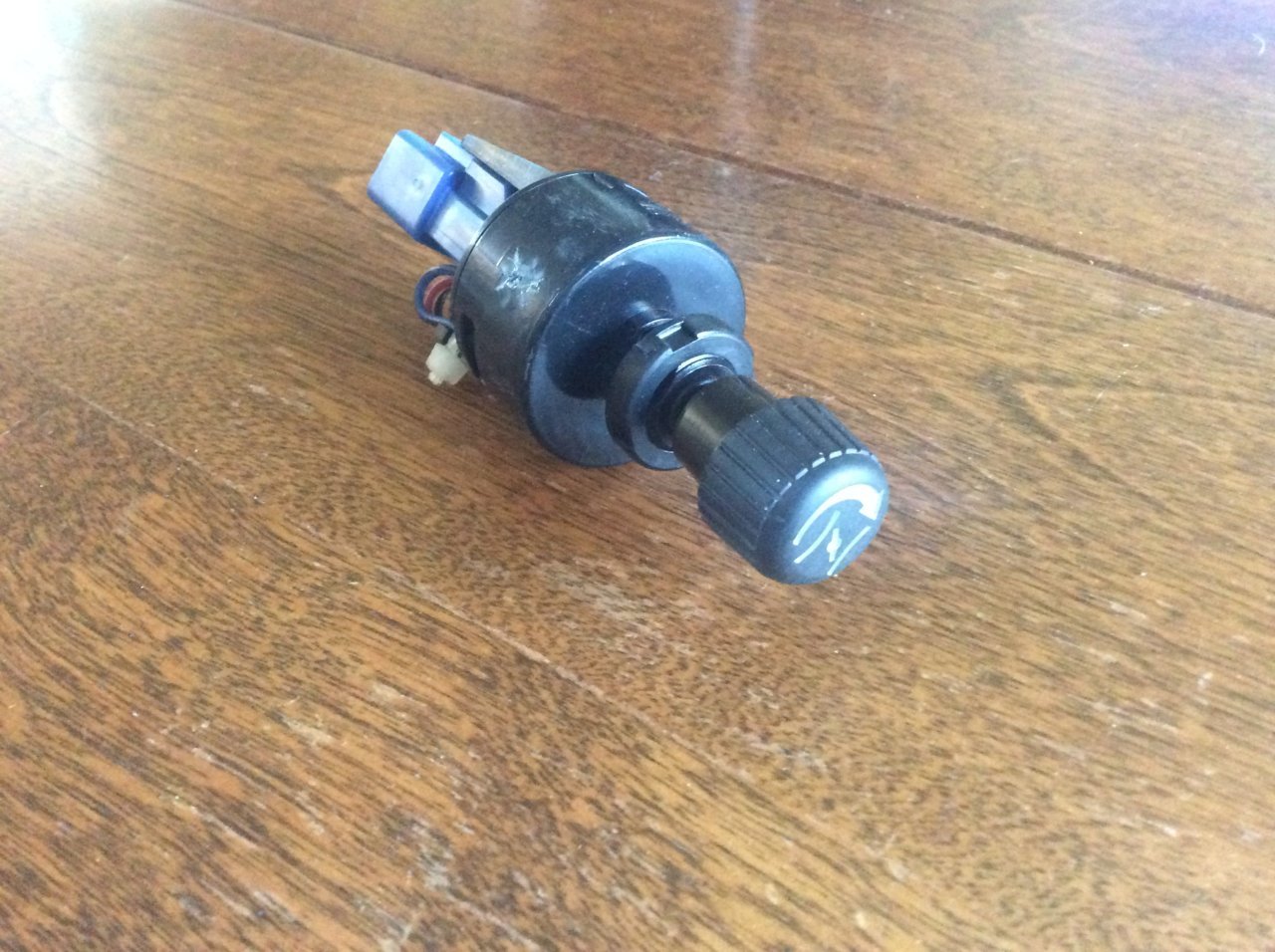

    Here's a little something I found... electronic hand throttle from a foreign market Dyna. Truck is 24 volt, though... and far from plug and play.

    24 volts has nothing to do with the switch. They all work the same.

    You do realize that’s a choke switch, not throttle control, right?

    You could take a pedal assembly, modify it so that the electronic mechanism that signals the ECU (is it a variable resistor or something more precise?) of the pedal position is controlled by some lever with a friction lock and then wire it in parallel with a switch so you could select foot pedal or hand throttle. I wouldn't recommend that but it seems like a way you could do it.

    Diesel engines don't have a choke. This is a throttle switch, idle up. It is for manually controlling engine rpm while operating the PTO that the Toyota Dyna has.

    look at the symbol on the switch. And on a diesel Idle up is NOT throttle control. Again very different purpose. I use it all the time on my diesel, as you said increases idle for PTO / alternator output.

    That is the symbol Toyota uses on this switch/dial, they install it on diesels only. Further study shows an idle up button on the same vehicle, perhaps to activate this? It should work for a hand throttle on gassers, if it can be integrated.
