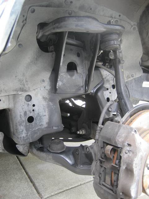

    Front end was super easy since the struts were pre-built. I just jacked it up, put it on stands, popped the wheel off and then just loosened the top three nuts (14mm), but left them in place. Then I pulled the bottom bolt (19mm) and removed the nuts at the top and it just came out.
    Still some cross-hatching on the disks, the previous owner had a brake job done just prior to selling it (along with a ton of other major service). Aside from the suspension being worn out, the truck is great and I'm happy with it... though a little more now :D

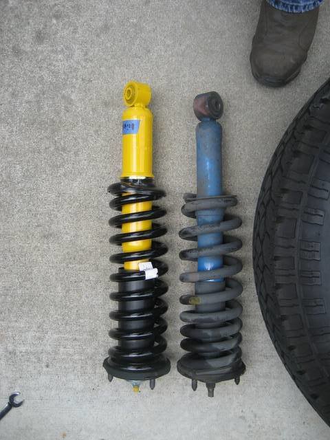

    OME vs Stock:
    Installing the front was nearly as easy as removal: I had to pull the swaybar endlink off to create more downtravel, but the OME went right in. I loosely put the top nutz on and I had to use a little leverage to get the lower bolt in, but it went smooth. About an hour for the whole front end.

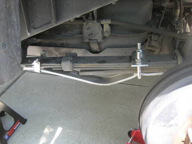

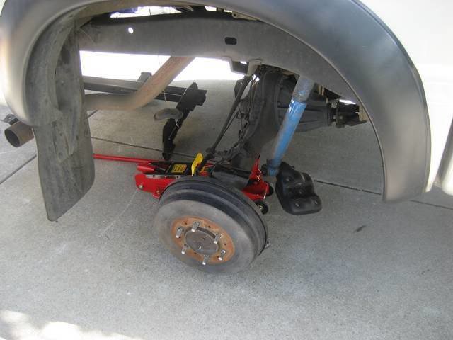

    Bye-bye bandaid:
    The nice thing about this was it really enforced how bad the axle wrap was on the worn out stock leafs and how unsafe it was to drive in windy conditions as my truck was all over the road. That went away when I threw these on a month ago, but began to break down and it was noisy as well.

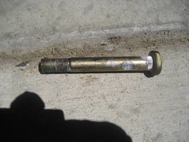

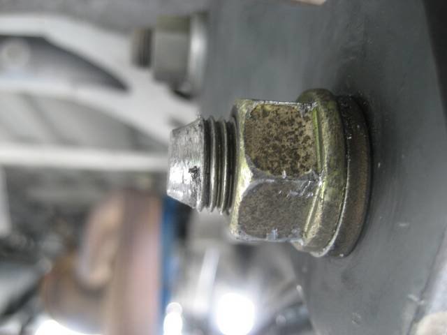

    I had a few issues with the rear end. I boogered up the rear shackle bolts when I hammered them out. I picked up replacements at Home Depot, but wasn't happy with a full threaded bolt in there, so today, I thought I'd grind a shoulder on the end and take off the boogered threads. It worked great:

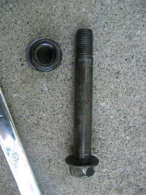

    PB Blaster is great stuff, but I'm not sure I needed it much. Check out the condition of these bolts:

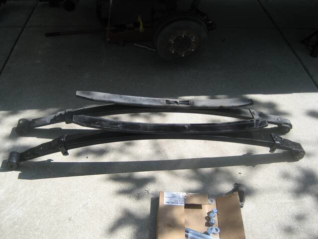

    Stock vs Wheeler 5 leaf pack (passenger side - the drivers side was more dramatic but I forgot to take a pic):

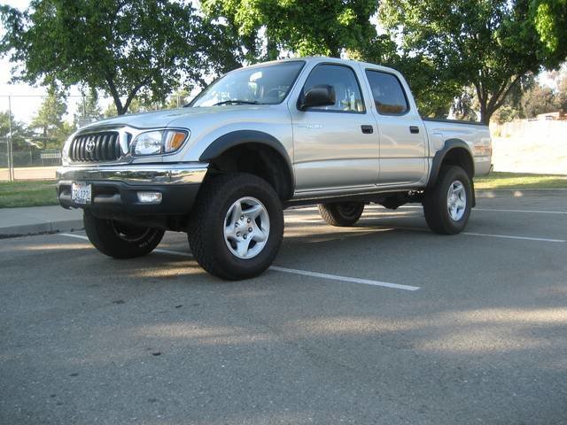

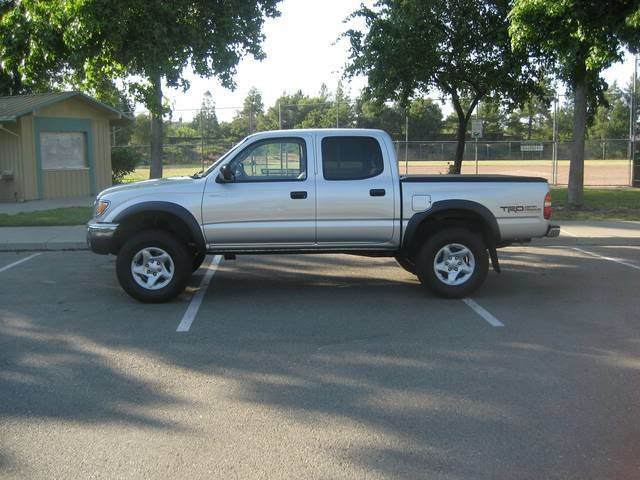

    Before the suspension, the front was 20-7/8" (measured center wheelcap to outer lip on the wheel flare). After it's 23-1/2", so an initial lift of 2-5/8" before settling.
    The rear was 21-1/2" with the bandaid/worn out springs. After it's 23-1/4", so 1-3/4", but a near level look with the front being slightly higher. I'm anticipating it will settle pretty level.

    Before:
    After:
