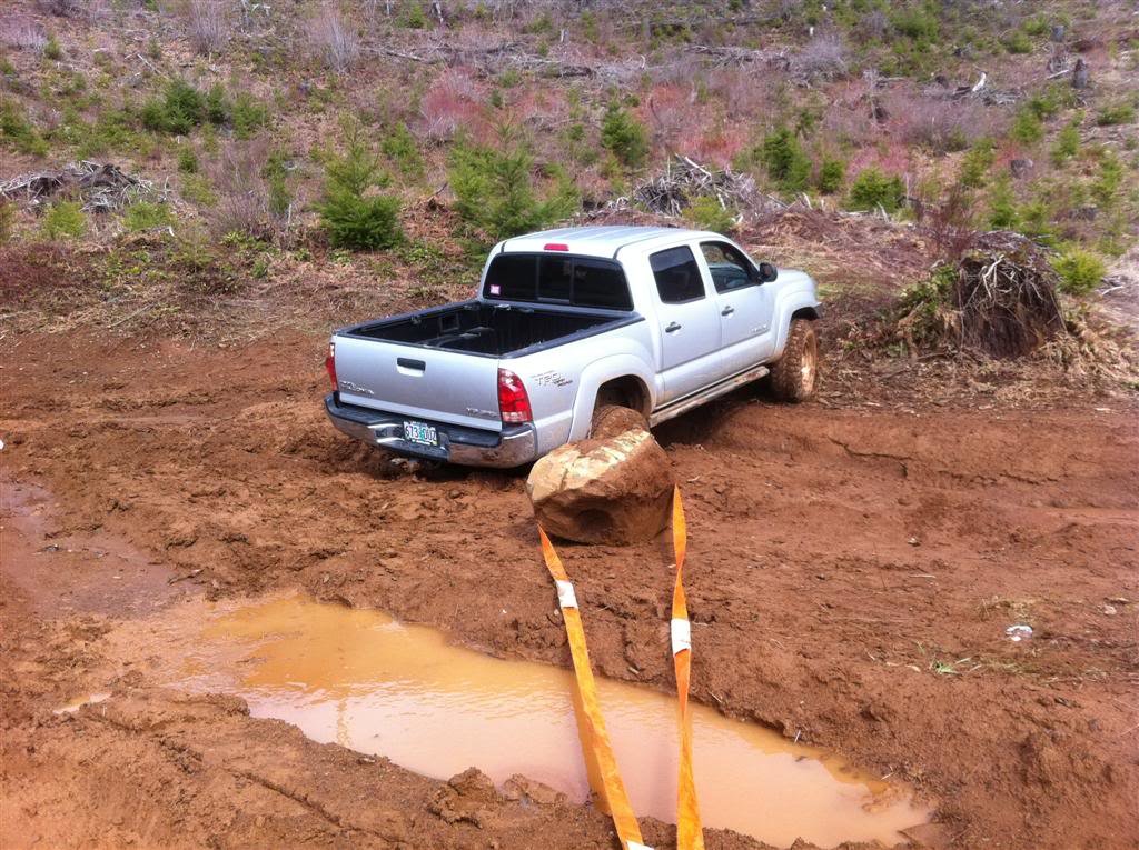

    Wow, lots of things going on here, and we're getting dangerously close to some safety hazards. I'd like to add a few comments:
    Excellent point. cheapest, most versatile option. It can be used as a come-along with the ORK kit, or can be used to lift a tire (with the right accessory) so you can stick stuff underneath for better traction. Keep in mind that it is very important to know how this device works; otherwise it can be the most dangerous tool you have.
    This is a possible option, but overall not that great. Here's why:
    -You will have to use the the pulley EVERY time to ensure a safe pull. That's added work.
    -your small electric winch is $200. Add a pulley for $55, That's now $255. It comes with 55' of 1/4" thick wire rope. Since you have to use that pulley each time, which cuts distance in half, you better make sure your anchor point is only 25' away, otherwise you need to add about $150 - $200 for a winch line extension. I say extension because I'm not sure you could add an additional 100' of rope to that winch's drum. Keep in mind now, you will also need an additional d-ring shackle to connect that extension, so you add on a negligible $15. You are now at $420-$450.
    Why didn't you just start with a Superwinch LP8500 or a Smittybuilt XRC8?
    Second, you said something about wrapping around the tow ball. THE TOW BALL IS NOT A SAFE RECOVERY POINT.
    The tow ball can break off and become a missle.
    You should ONLY use fully-enclosed loops mounted to the frame of the vehicle when you need a recovery point.
    ^^^ listen to this guy. A recovery strap should be your first option. Fastest setup, least amount of danger when executed properly, least overhead cost.
    Important note here! Zombie Runner mentioned a recovery strap. jbrandt mentions a tow strap. The lingo can be confusing, but there can be differences! What I'm getting at is the difference between a dynamic strap and a static strap.
    A dynamic strap has elasticity. It is good for use between two vehicles. I'm not being very eloquent right now, but basically it gives somewhere for the force in the pull to go (one vehicle goes out, strap stretches, strap tries to get back to normal shape, stuck truck gets pulled)
    A static strap has no or very little elasticity. It is good for use with a winch, which is a static pull. In this case you don't want elasticity because you want a solid constant pull. Elasticity would cause a sudden jump forward, plus can bind up the winch line
    In general,
    Tow strap as a constant pull
    Recovery strap as a get-unstuck pull
    you are mixing static and dynamic lines. Don't. They are for different types of pulling.
    Chains are especially dangerous in dynamic pulls, they can't handle sudden increases in pressure. They could be used in winching, but you have to be very well trained to ensure they are properly rated, inspected, etc.
    That hand winch has synthetic line and looks to be cast steel, not that cheap tin thing you and I have from harbor freight. :eek:
    EDIT: I should add, a hand winch can be an effective tool, I used it once to move a boulder when there was no other option. Note that I don't recommend this pull (especially since I just got done talking about dynamic and static lines, lol), but you can see how it can work for an emergency. The hand winch is mounted between a tree and the recovery strap.

    NO. The correct method is to drive the recovery vehicle slowly forward to take up slack. Next, move people well away from the vehicles and straps. The recovery vehicle should now drive forward, increasing throttle as necessary. The rule in all things offloading is "as slow as possible, as fast as necessary".*
    if there's a situation where the gear or the method makes you question your life, walk away from the situation or throw that gear away. You should be confident that your gear is rated for the recovery, is the proper gear, and is in good operation. My life > my Tacoma. Also remember the quote, "the only one watching out for yourself is you"
