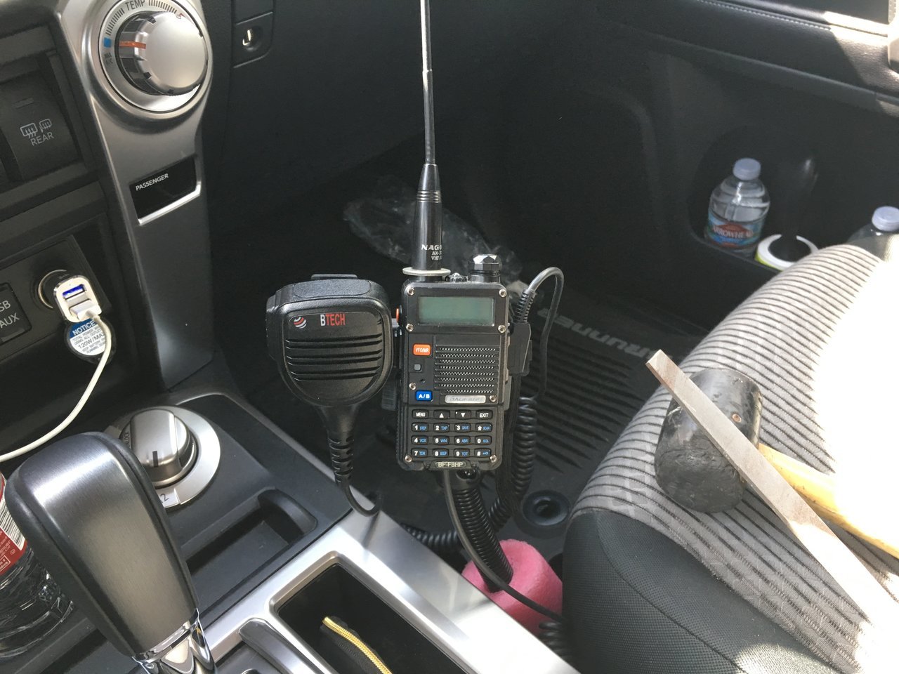

    Guess the best bet will be to get the gooseneck from LIDO and then 3d print a custom mic holder/HT holder and add a latch I can lock them in for the bumpy trails.

    Putting the setup together now. I ended up getting the ram seat bolt mount with the AMPS pattern. I'll 3D print the holder and mic keeper. Having issues incorporating the seat bolt as it is in a difficult location to keep the trim/ouch protector intact. Going to have to cut the foot by about half or more and see if that works out.
    I'll post back my results w/ pics if anyone is interested.

    IMG_7579.jpg Not bad. Just 3D printed the solution.
