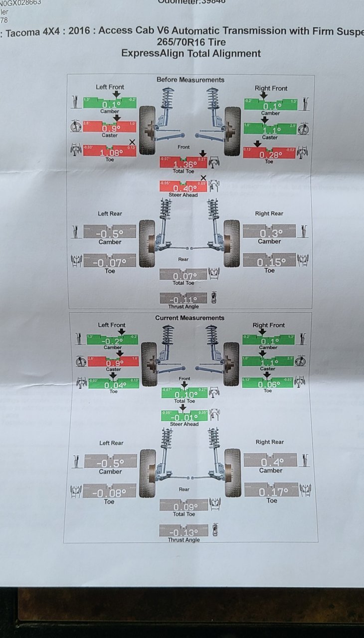

    A 1" front leveller really shouldn't cause any problems after full alignment. The alignment place should've sent you on your way with something of this nature, showing a before and after.20230626_142551.jpg
    What's amazing is fitting those tires on stock wheels with no issues rubbing.
    Some trucks can get away with it. Some can't.
    Plenty of shops won't do 285's as it's beyond recommended tire spec for that wheel.
