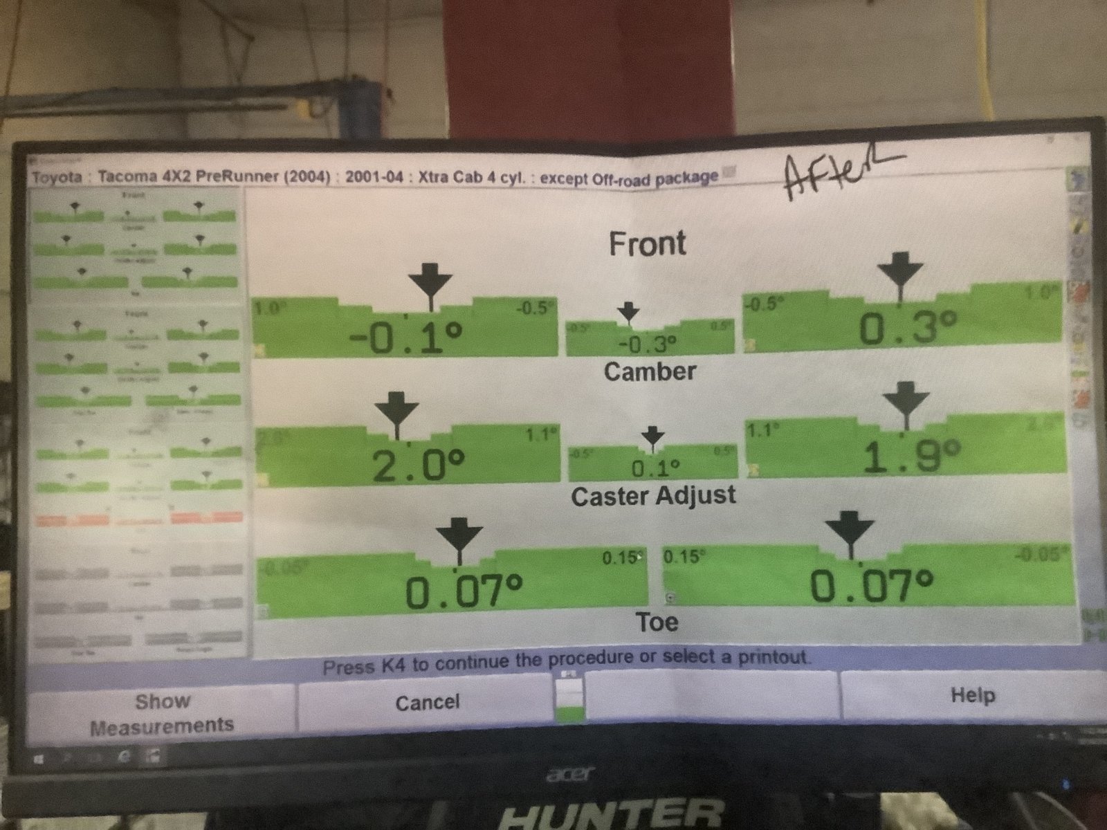

    Just curious how other’s 1st gens handle at highway speeds. Mine seems to float a little bit around 60-70MPH. No vibrations or shaking, it just feels kind of loose. Don’t know if it’s normal and I rarely have occasion to do any highway driving so maybe it’s not a big deal. Last alignment spec from October looks OK to me.
    Edit: it’s like I can move the wheel between 11 and 1 o’clock with no change of direction

    I believe this is an issue with many 1st gen Tacomas (mine included), even more so those with a lift. Increased positive castor is the best solution, but the stock upper control arms don't really allow for this.
    There's another issue at play as they rack up mileage, and it's play between the collapsible joints on the steering column. The steering column has these joints, so that a front end collision can't result in the driver being impaled by the wheel/column.
    My truck was terrifying to drive above 60-65 mph before I did the tac weld mod to fix this issue (you can search that here on TW). Now my truck has more like 1/2" of side to side play in the wheel at highway speeds, and is much nicer to drive. Saving for icon delta joint upper control arms to eliminate that last little bit of play.

    I did new Moog inner and outer TREs, new OEM upper and lower BJs, ES UCA and steering rack bushings, new Moog LCAs and went for an alignment about 500 miles ago. (I put whiteline poly bushings in the stock LCAs, just haven’t swapped them in yet). I can’t detect or see any play standing still or at anything less that highway speeds and it drives straight as an arrow, but get up around 70 and it starts to handle like a boat.
