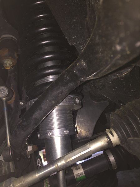

    What lift setting are the 5100's at?

    Are the 5100s at least set at 0 to accommodate the new springs?

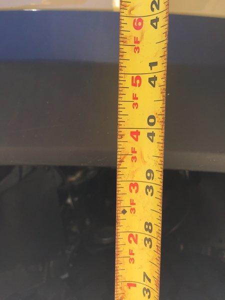

    I'm not sure, here as rough measurement I took with my 285/75/16sIMG_4089.jpg

    I'm pretty new with this, how can I check? I had them installed so I'm not sure.

    Get a pic of the shock body, the 5100 shaft has notches machined in it so that you can adjust the spring perch height.
