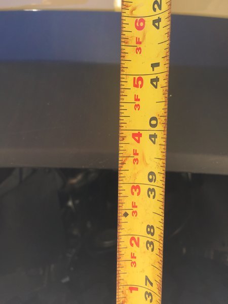

    Bud air down to 31psi front 30psi rear... go for a drive and report back.
    Your shocks are at set most likely 1.5 front and you have an AAL. Cv angles look decent from the pic. Just go drive it like that first and then start messing with your toytec coilover

    Those look like fatbobsgarage shocks (5100s with there adjuster) and I have them on my truck. Give the springs some time to break in, it looks like they put plenty of preload in. Can you measure from center of hub to fender flare?

    Talking valving and digressive/progressive is just going to confuse things.
    The problem is preload or its tires, or both.
    It isnt valving.
    OP is a noob. Don't over complicate his issue.

    For that size and load rating, you should be at about 31 PSI cold.

    That's what I got. My tires were turned but this is the best pic I got right now.
