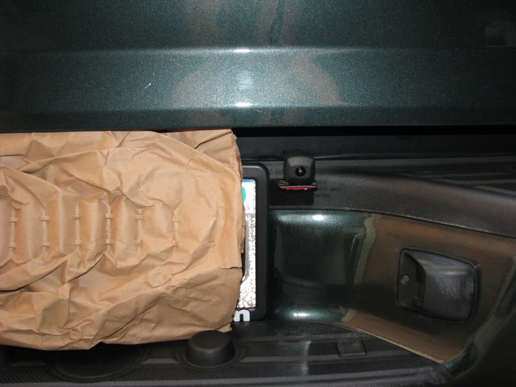

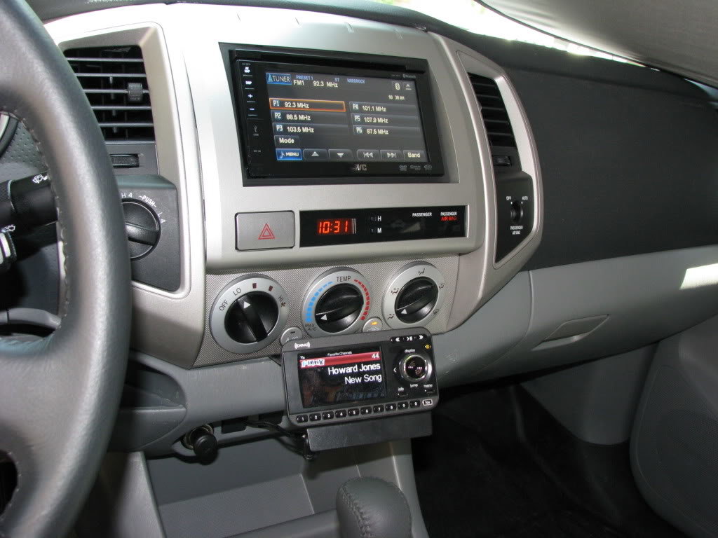

    One more good thing about the KW-NT1... the OEM metal radio brackets can be used with it. Turns out that 3 of the 4 holes in the brackets line up with the holes in the JVC and the bolts are the same thread, length and diameter. Much better than the cheesy plastic brackets that came with the Scosche kit. Another cool thing is that you can go to a menu and enable rear camera playback anytime (still comes on automatically in reverse if you connect the wire), moving parked, doesn't matter, even if PB wire is not grounded.
    Here a couple of pics of the install:
