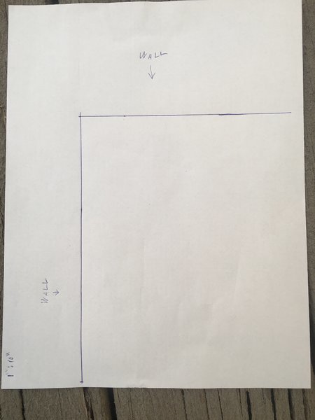

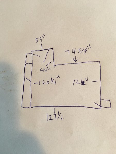

    Here are 2 quick sketches.
    In this sketch the walls that the bed will be attached to are the 74 5/8" and 121", with the headboard at the 121" wall and the side along the 74" wall.
    And here is a 1:10 sketch, the left wall is 74 5/8" and the top wall is shown as only 60" (the width of the mattress)

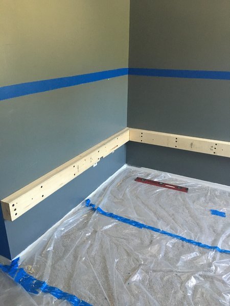

    Got the 2x6's on the wall, if I can get the tabs drilled then the frame will be installed today.

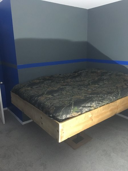

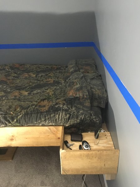

    Got it pretty much finished up.

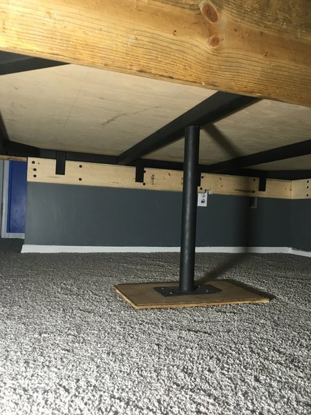

    Added one support to the floor and I know the bed will hold anything I put on it.
    It's very tall, about 4" taller than I had originally intended and I may end up taking the frame off and dropping the wall boards down at least 2" if not 4".
