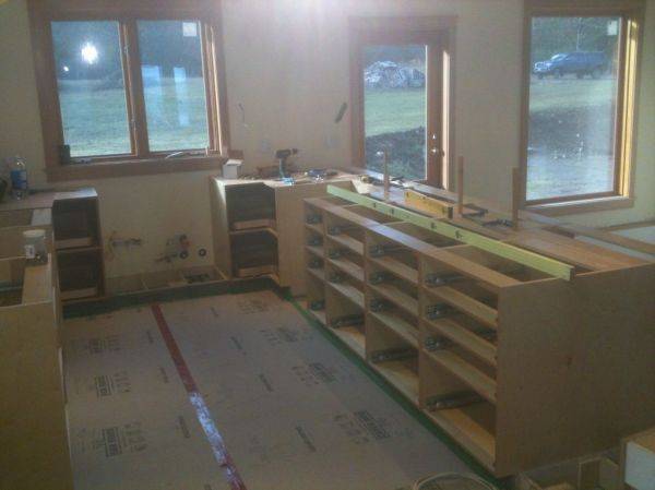

    I'm doing a cabinet install today OP :)

    Looks nice, OZ.
    Hopefully nice and warm, too. :)
    Good winter job !
    I don't see a laser.
    Ya got laser technology up in the Great White North ? :p

    I use a seperate ladder kick system and use a rotary laser to set the kicks so that the tilers can do the floor before the cabinets arrived .
    The boxes can just get ganged and attached after that .

    OIC.
    Good idea to keep the cabinets out of harm's way.
    Floor guys sling lots of messy sh!t.
