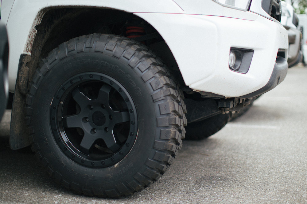

    I've been stoked on the new Rotiform SIX-OR wheels.

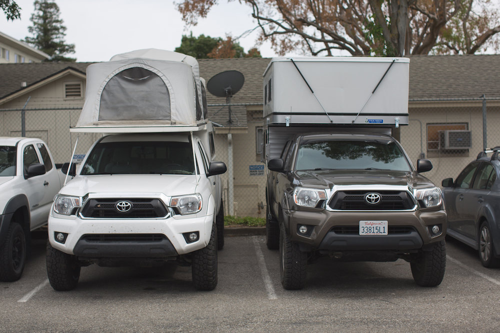

    Over the last 3 years, there has been a dramatic shift at my work (Specialized Bicycles in Morgan Hill, CA) toward #VanLife... Im not joking when I say, that there are now 10+ people living at or around the building. Im happy to say, there are a few pretty cool trucks too.

    Those look amazing! Where did you order them from?

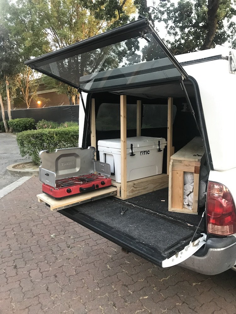

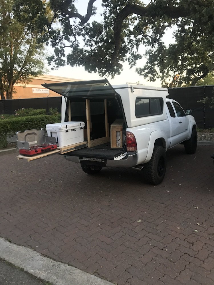

    On second look... I started worrying about the slides supporting all the weight. I replaced the main 28" slide with a 500lb version from Amazon. I'll let you know if they are any better than the original ones I had ordered.

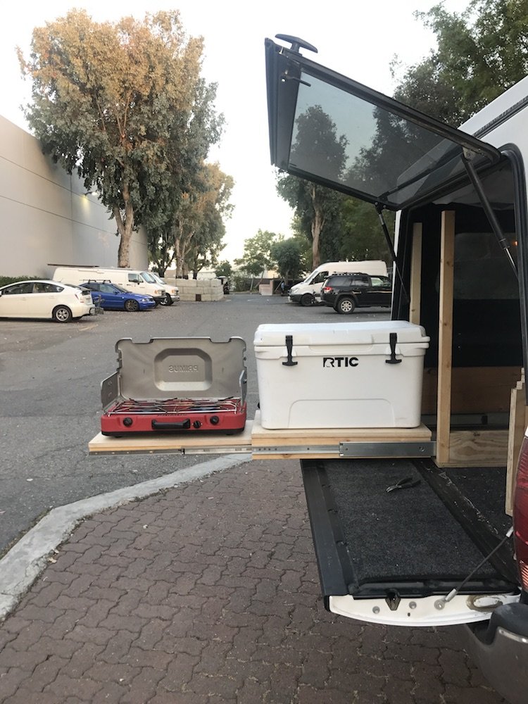

    Alright. More progress tonight. Finished the dual slide mechanism in the bed of the truck.
    Bought 500lb rated slides for the main. MUCH better than the first try.

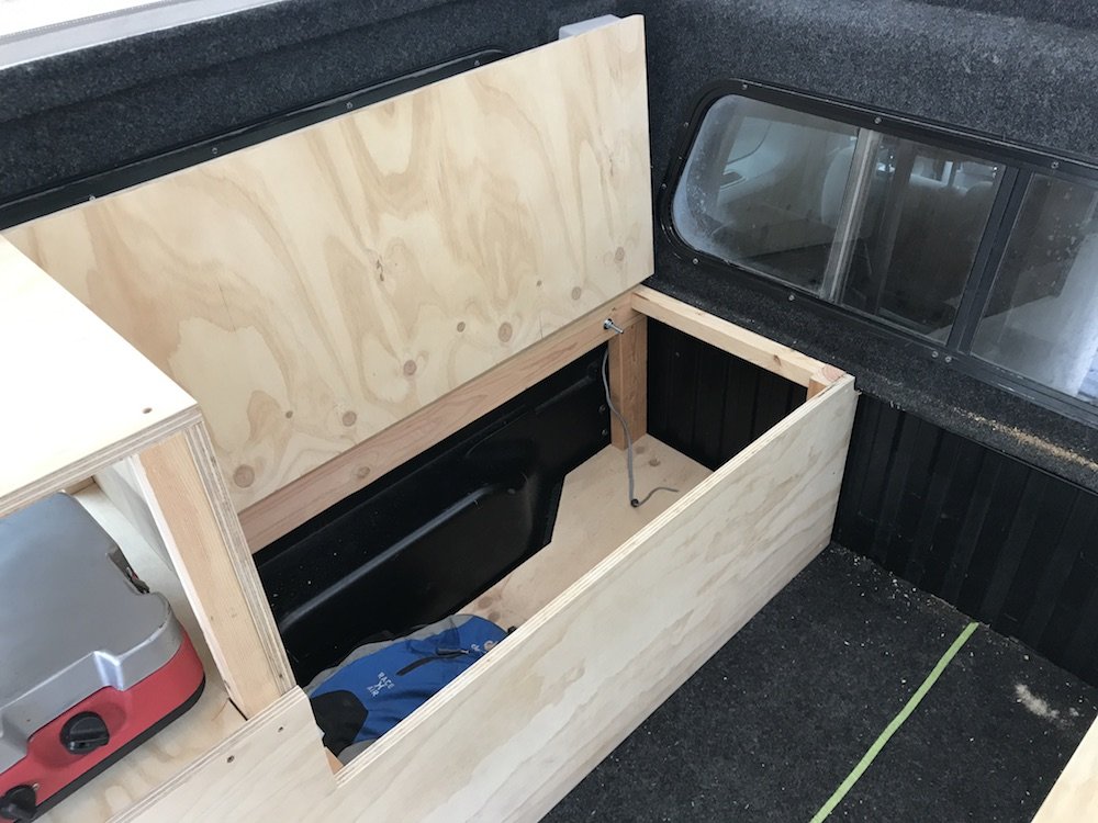

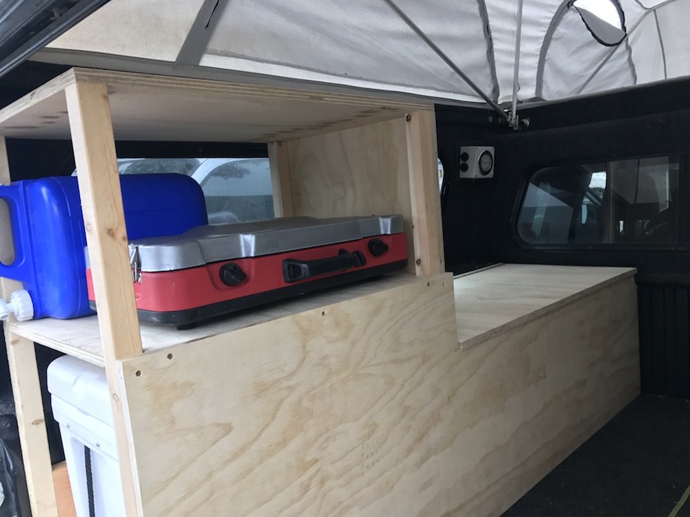

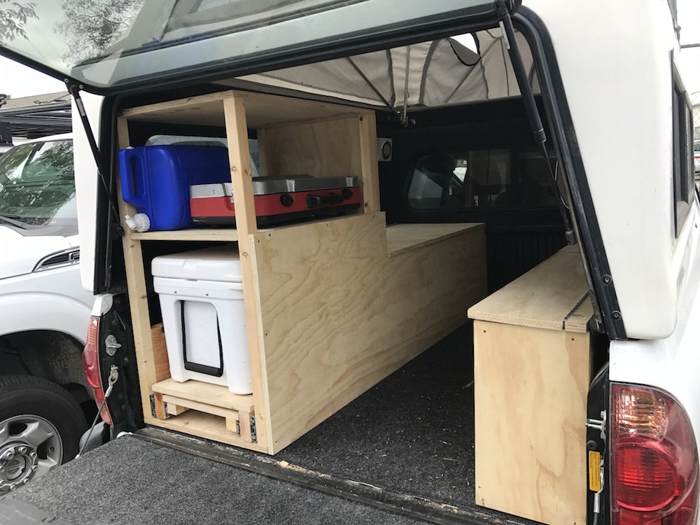

    Progress. Skinned the left side storage and anchored it to the bed. This give me three storage areas 2x (9"w/16"h/30"L) and 1x (20"w/16"h/42.5"L). And should be more than enough to store sleeping material and camp gear.

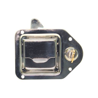

    Each of the boxes will also get an inset lock to help hold them closed on the trail and help with security while street parked in San Francisco.
    Anyone have ideas for how to finish it? Carpet? Stain? Paint?

  13. Jul 1, 2017 at 3:14 PM
    #33
    -dustin
    -dustin Well-Known Member
    Aug 27, 2015
    #162807
    3,488
    Leander, TX
    2020SWDCSBTRDPROFTW
    Carpet or LineX

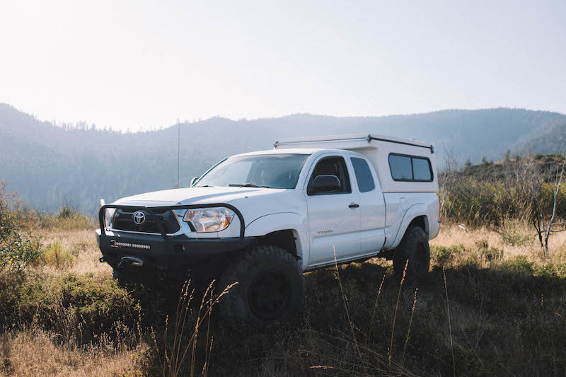

    And so the build continues.
    Armor:
    -Pelfreybilt Alloy front bumper with full hoops.
    -BAMF Bolt-on Sliders (on order since june... eh hem Jerry.)
    -BAMF 3 piece skid set (ordered on the TW group-buy)
    Lights:
    - Baja Designs Squadron-R Sport Driving Combo Light pair
    - Baja Designs S8 20" Driving Combo Light bar
    - Ampper Waterproof LED Rock Lights

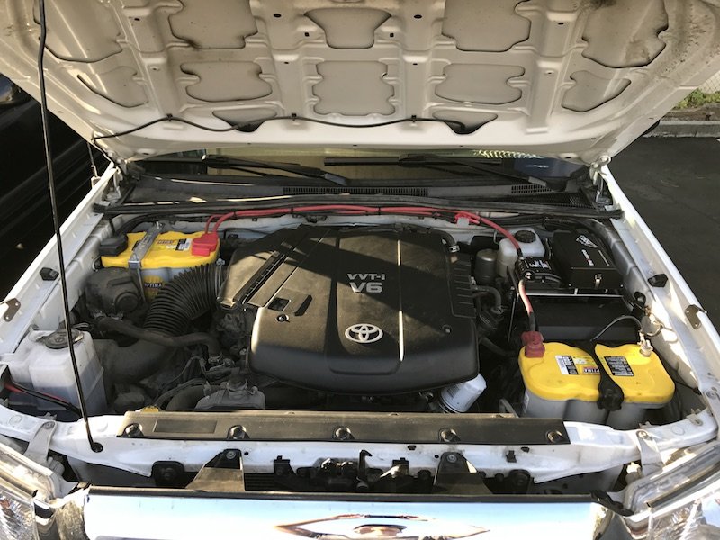

    Dual Battery System:
    - 2x D27F Optima YellowTop Batteries
    - Blue Sea 12v 500amp Battery Isolator
    - Spod Universal Truck kit / fuse box & 6 panel switch
    - Off-grid Engineering 2nd Battery Tray
    - 2 Gauge red/black battery wire.
    - Fastronix Solution Battery Terminal Kit
    - bunch of 14gauge wire and connectors from Wirebarn.com
    Lots to do.

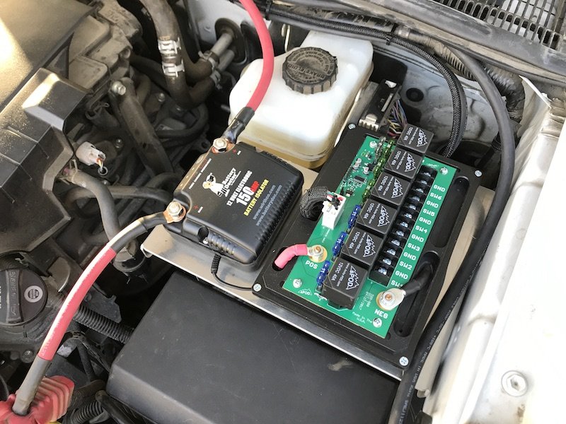

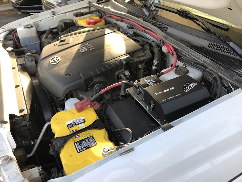

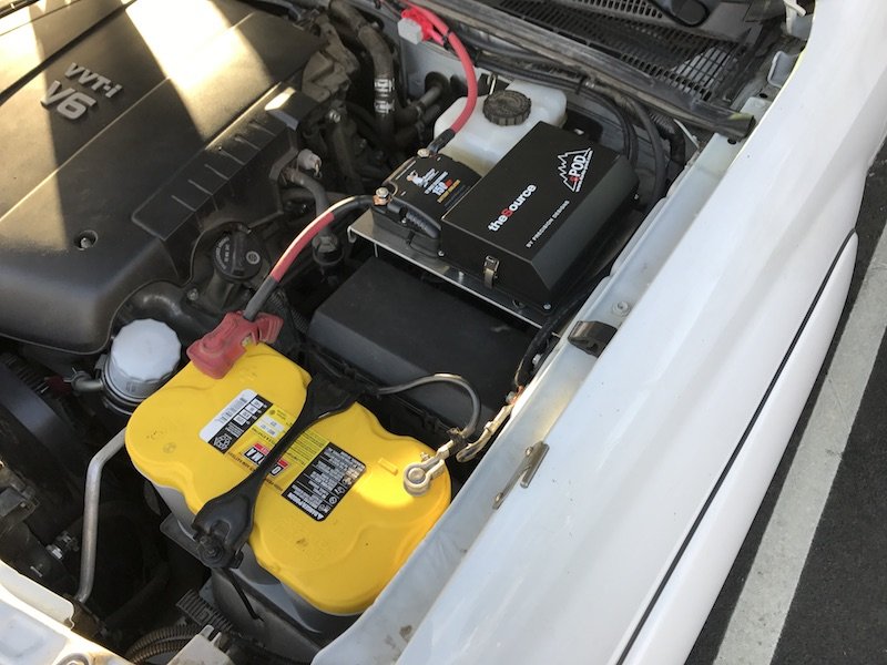

    Instal of the dual battery was successful.
    Needed a couple of extra bits I didn't originally buy.
    The SPod runs with 8gauge wire and the Blue Sea isolator i originally purchased was... well, overkill. On recommendation from @Camp4x4, I bought a Battery Doctor because it allows you to manually override the bridge and connect the batteries in the event you kill it.

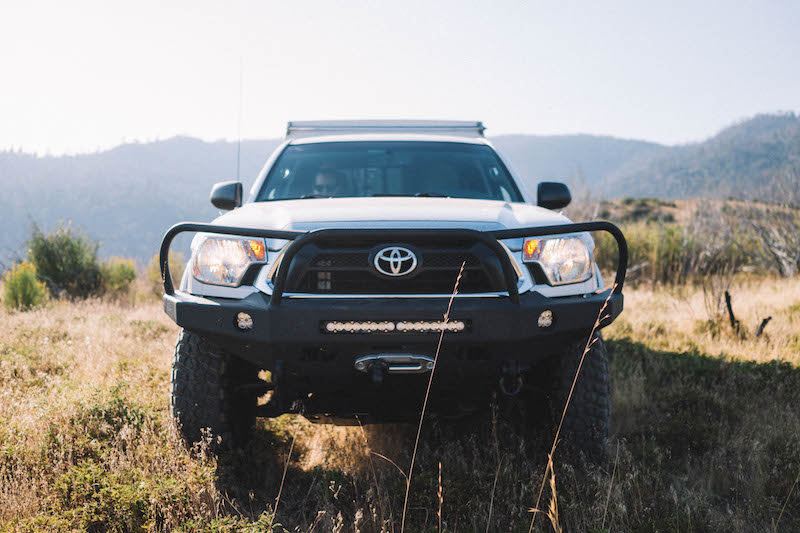

    Also, Finished Install on the Pelfreybilt Alloy Bumper... #FullHoops
    The Baja Designs lighting and Super Winch Tiger Shark.
