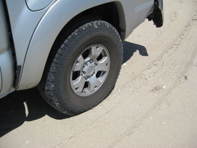

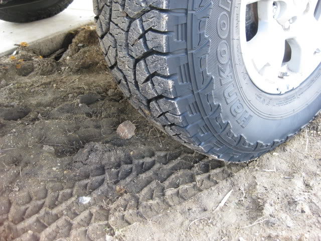

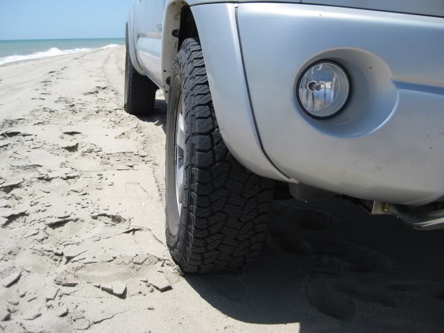

    Yes, I have posted a zillion times about how much I am enjoying these tires and how well they work in mud, snow, desert and sand... and most important they are quiet on the highway where we do 90% of our driving.
    Because they are one inch taller, and increase our ground clearance 1/2 inch, they make the too fast speedometer read correctly now and raise the truck a little.
    There is NO RUBBING under any conditions. I do not have the TSB because my 2010 truck doesn't need it (no bottoming out with a load, but my '05 did, so I know how it feels).
    Because gas mileage was false before due to the faster turning odometer, the apparent mileage drops 1/2 to 1 MPG... but it is true now... and the tires themselves are not gas robbers, IMO.
    Photos with Hankook Dynapro ATm 265/75-16 on my truck...
