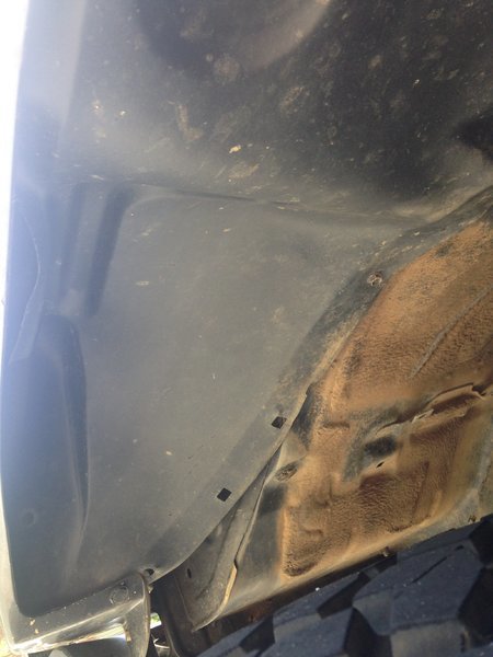

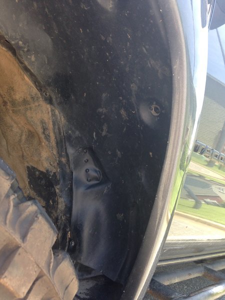

    This first pic is the rear of the wheel well. This is the driver REAR wheel well guard, cut to fit the front. the orig front guards were not wide enough to fit. All this takes is a few times of guess and check cutting to make it fit. I just used self tapping screws periodically to help hold it in. I made sure to cut it wide enough so there is actually nothing holding the guards in on the fender side itself, they are just resting on the lip of the glass fender (so make sure you leave it wide enough so it can overhand on that and secure itself). Hope these help.

    abs plastic?

    I think that may work, but the thickness is going to be the unknown. I think the abs will be a little more difficult to shape IMO. I really like cutting the rear guards since they already have the perfect bend in it already. I would go to a pick a part type lot and get the rears from a tacoma if I really needed it.
