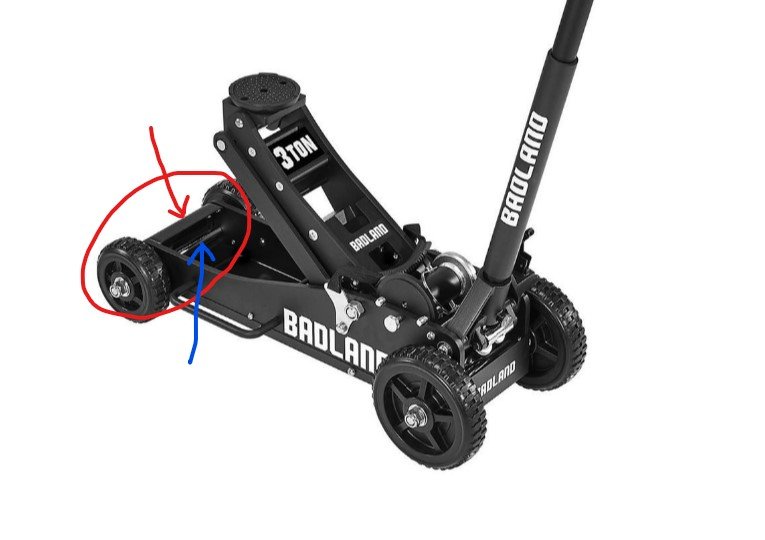

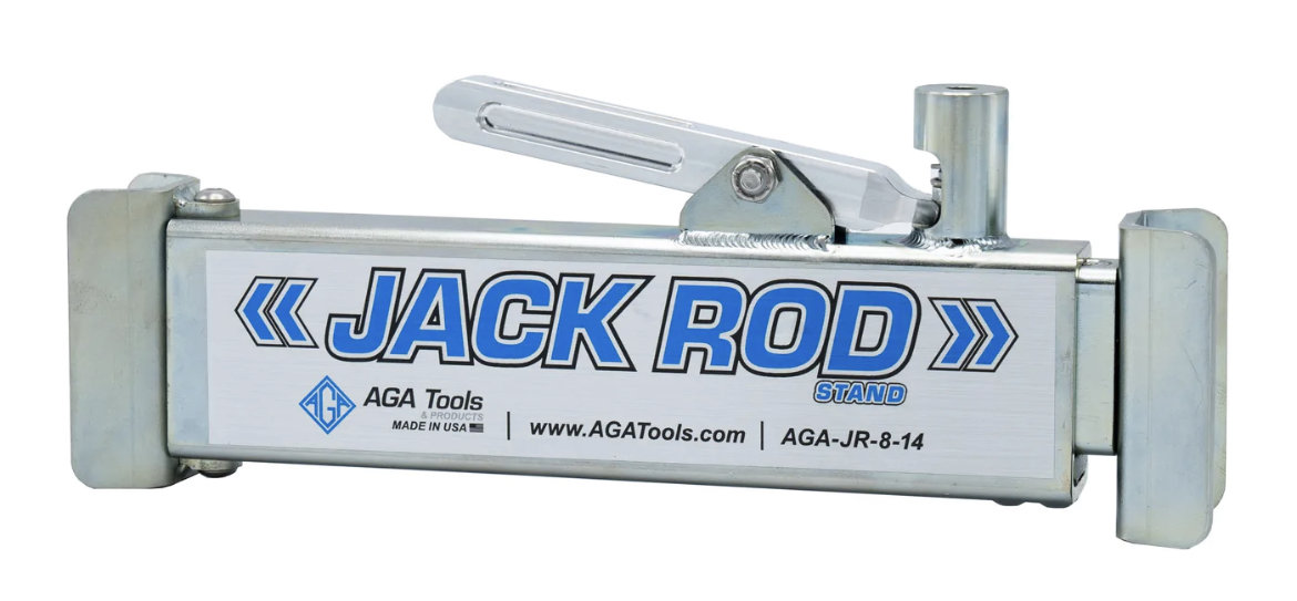

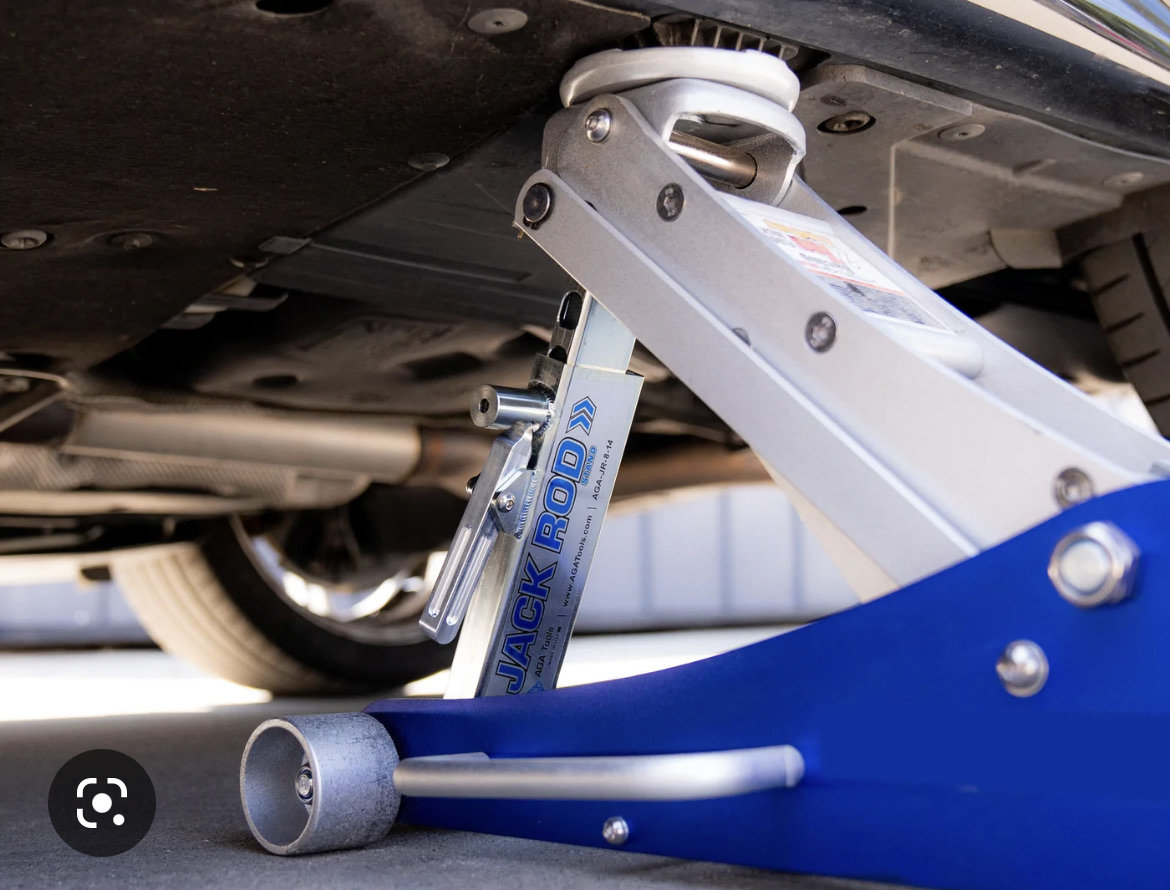

    anyone know if these work with the Badlands Jack
    such as 3.5 ton XL jack rod
    per website for use in high weight jacks on lifted vehicles
    but doesn’t say if Badlands compatible

    If you look at the front bar of most other jacks, it is a straight bar going right across from the bottom to hook into. The Badlands Jack has a cover that looks like it will get in the way of looking into that front bar. it is really close, it might work, but I'm thinking unfortunately not so much.

    same
    reached out to AGM
    They said it works with Badlands
    Only way to confirm is to try I guess

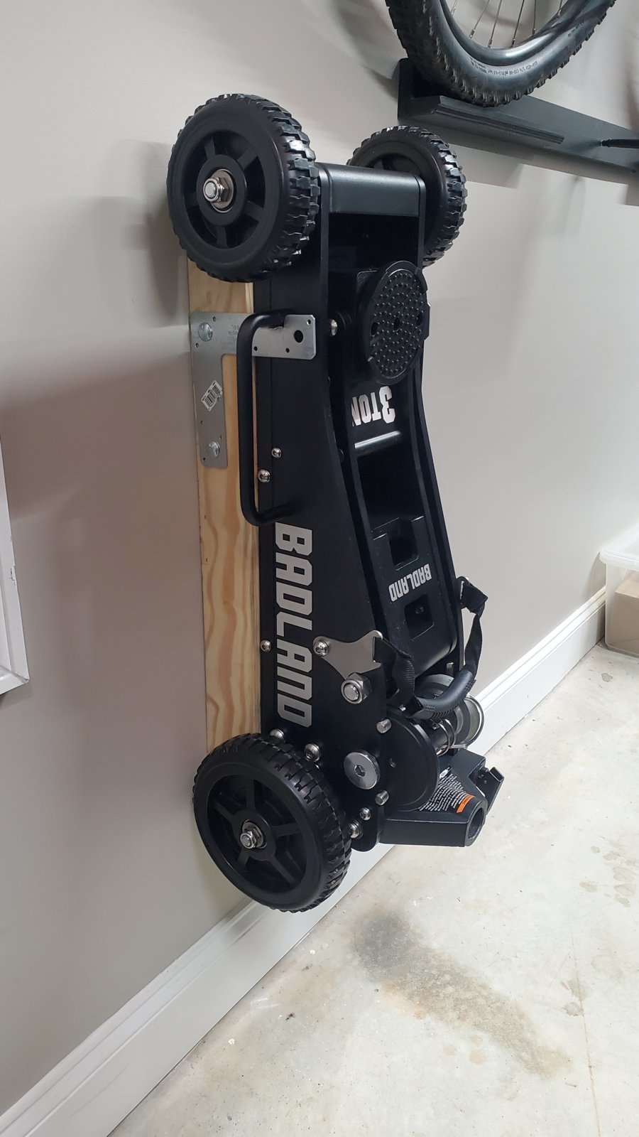

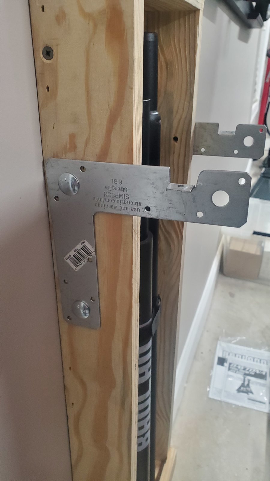

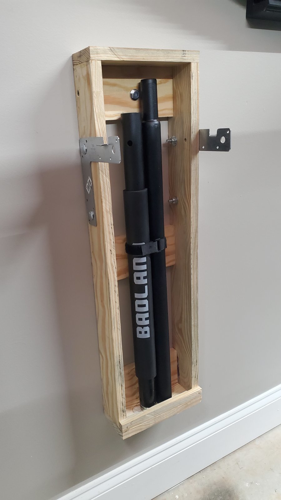

    Alright guys here's the wall mount. I used 1x3 lumber, wood glue, heavy duty screws, two 6 inch "L" brackets and some bolts. I spent maybe $20 on materials. I'm planning on painting it flat black next.

    That is badass!!! Great idea

    Just to be a critic, because I am an engineer ... I would put now as after-product 2 "legs" that angle out (30 degree, maybe) that bridges the floor to the bottom of the box ... distribute the "falling weight" a bit.

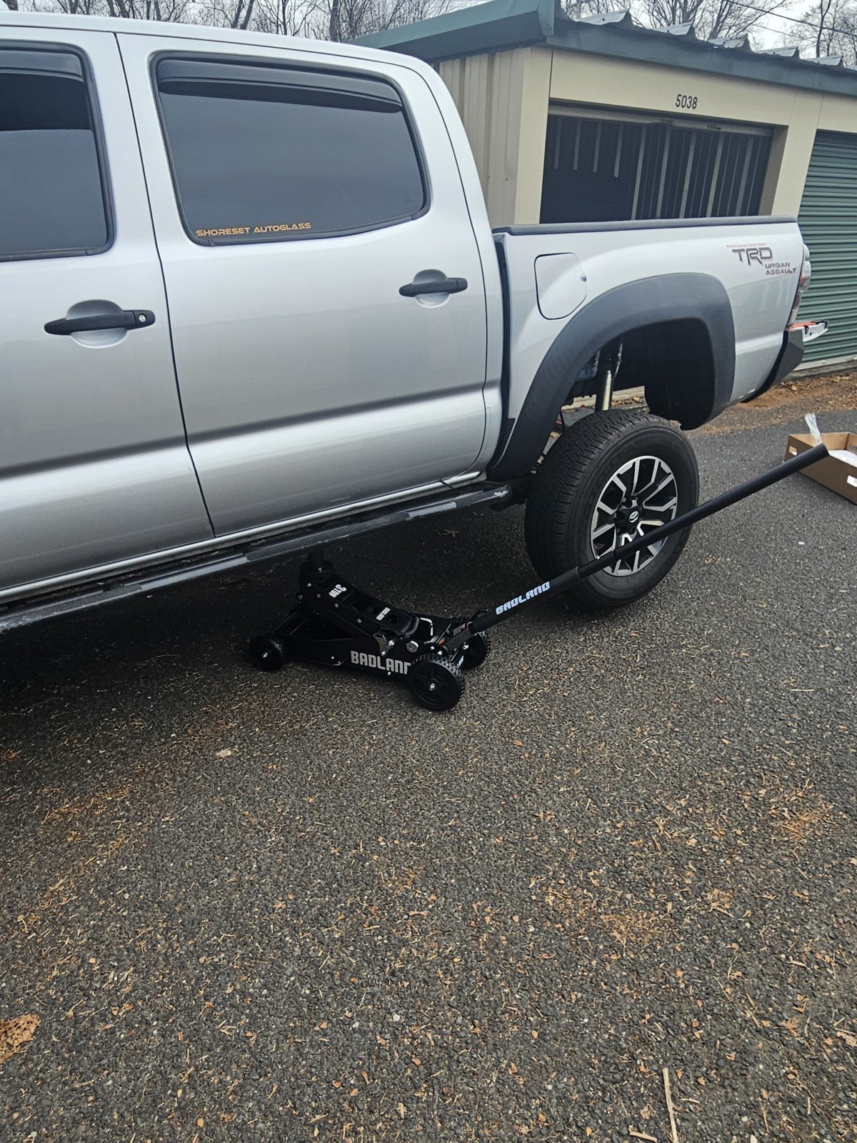

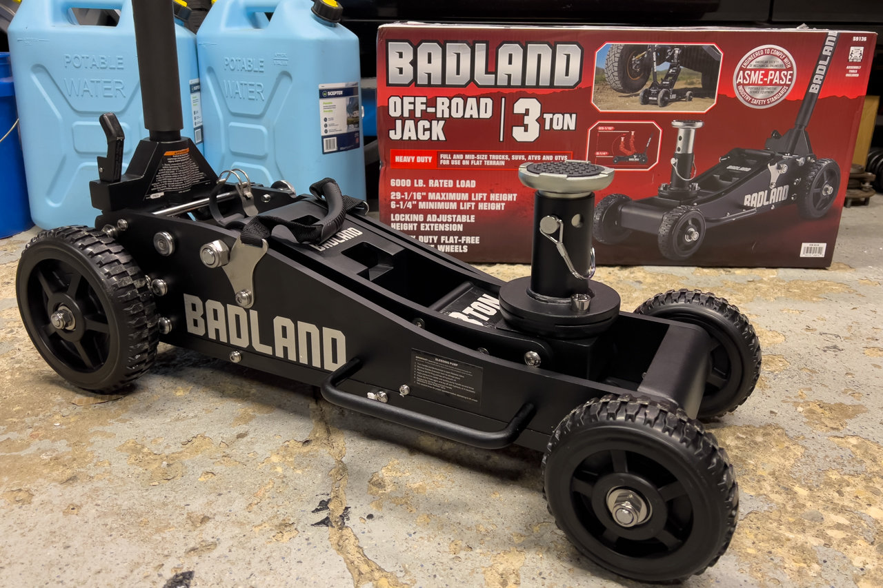

    Picked this jack up a couple weeks ago. It's great. Was switching out my summer wheels to my winter wheel setup.

    I like this idea. It will still keep the garage floor clear by cutting the legs in an angle.
