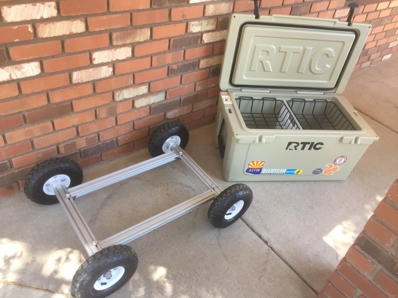

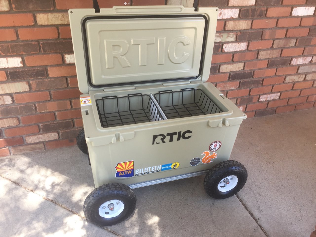

    Is it strong enough to sit on?

    How does it pull now if you do have to turn? I think I'm going to steal your design because it looks way better than what I have currently.
    I wonder if you could add small casters to the front to help with turning? I'm probably overthinking this, I hardly ever drag my cooler around as it is.

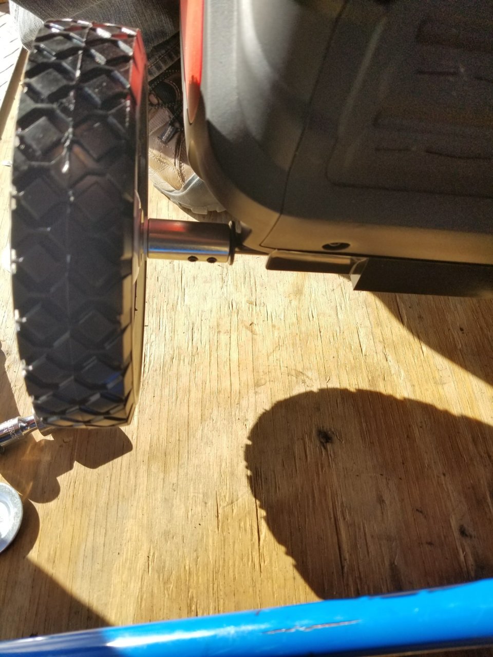

    Its a tad louder, but it is quite a bit bigger too, so to be expected. They are both extremely silent, that being said. People are always amazed that either is running on full throttle (not eco setting).
    I only have 25 hours or so on it, but it has performed well for those 25 hours. Change the oil in the first 10 hours and get an NGK plug and your good to go. It comes with little dumpy useless wheels on it. Hence my mod :D

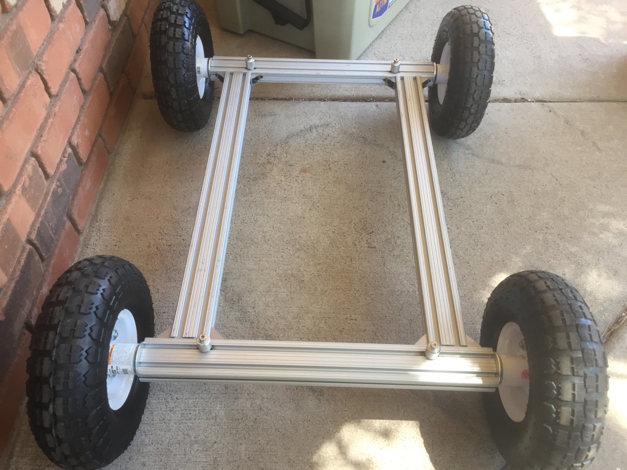

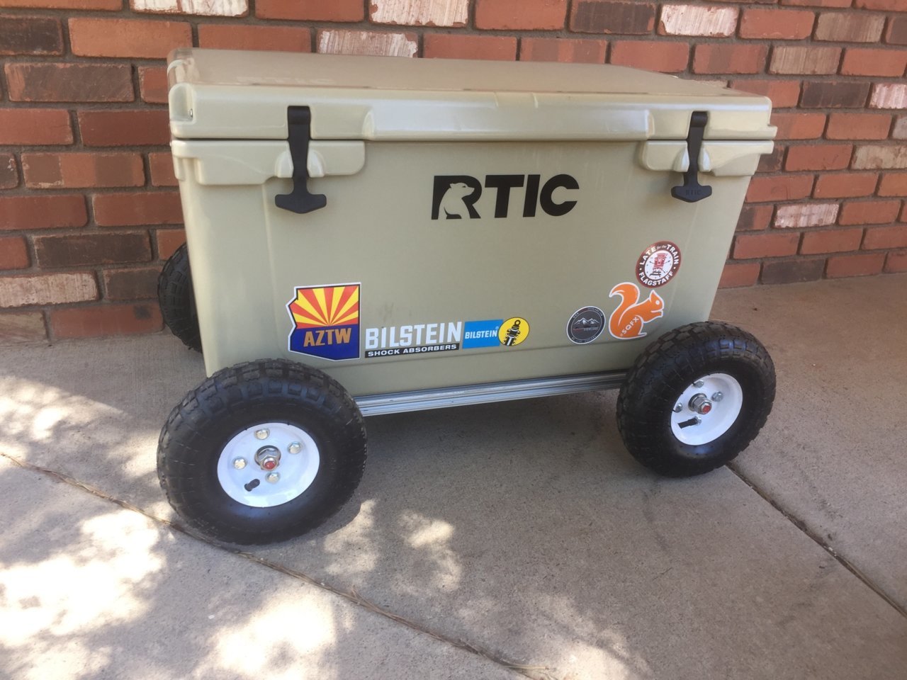

    Here are some more pics on how they're secured together.
    A 4' NRS strap in the back and a 6' strap up front that doubles as a handle.
    If I have to turn the cooler while pulling I just pull up on the strap a bit to slide the front wheels to the direction I want to go, then keep on rollin'.
    I thought about trying to incorporate steer-ability into the design, but chose to keep it as simple as possible.

    If any one ever wants to mod the 3500 predator generator to run larger wheels / tires, get the below extensions (well they're for arbors motors, but all i could find). It allowed me to extend the axle and clear the body.
